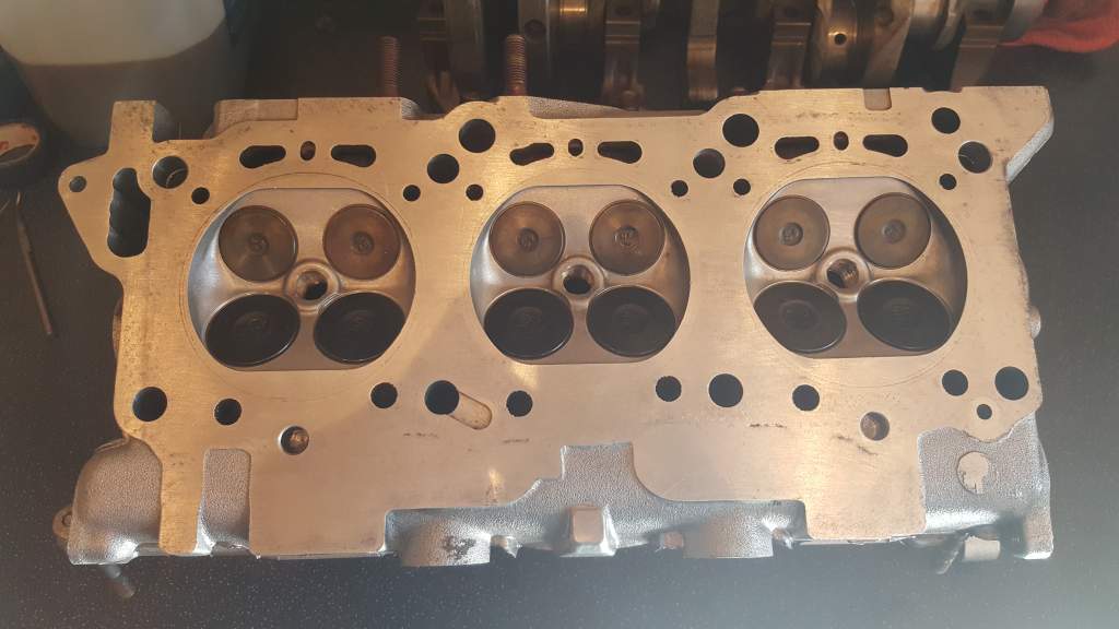

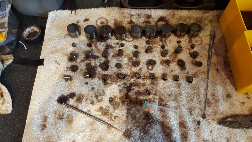

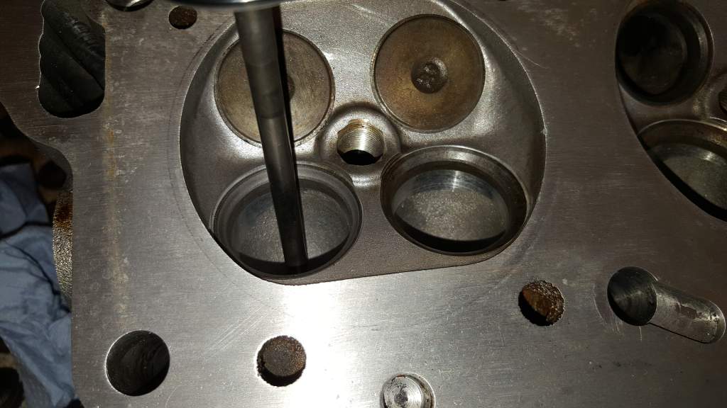

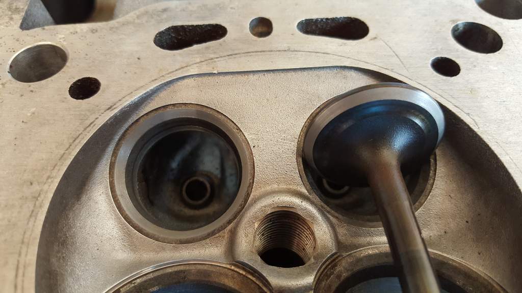

Apart from the issues with the valve retainer parts I've managed to get the valves in one block back in.
Using a lapping tool I spent about 10 - 15 minutes a valve grinding the valve in place with rough and smooth valve paste.

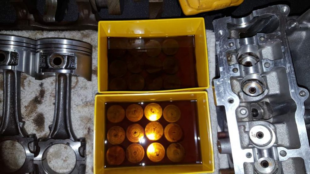

After the full block was done, I removed them all again in order and gave the whole thing a soak in wd40 before drying it all
out with a combination of compressed air and brake cleaner.

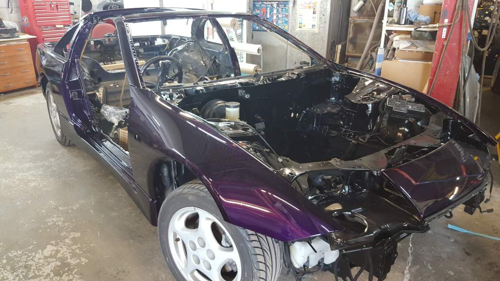

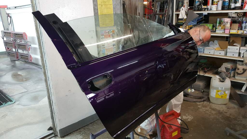

Very nice mate! :)
Make sure they do the door pillars black though!
