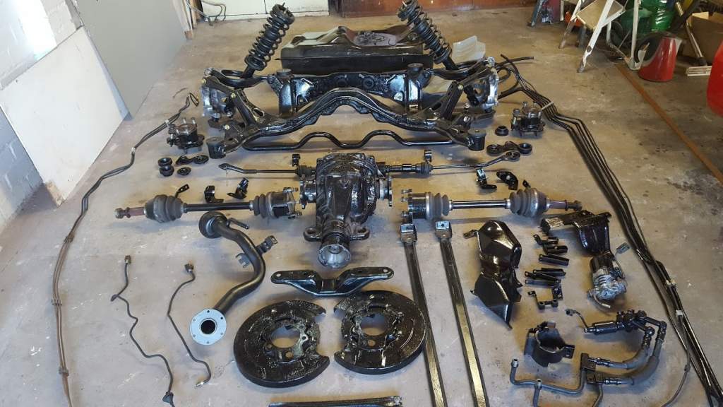

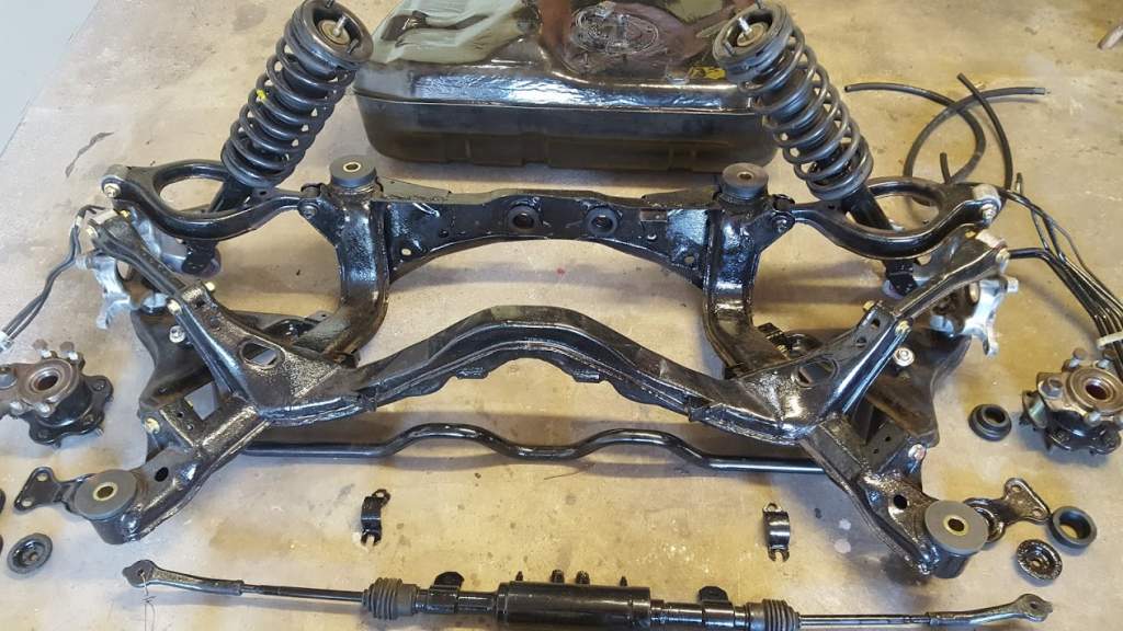

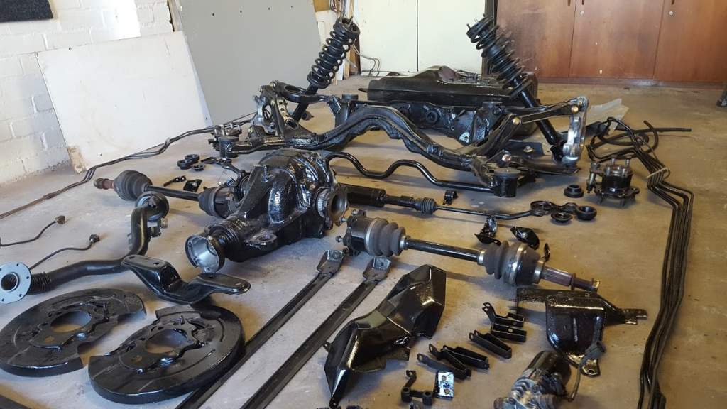

A bit more update on the parts that I have refurbished before it all goes on,
everything nearly has been shot blasted and painted with a product called POR 15 looks really good stuff but you have to take your time and
do the prep work properly
the brake pipes are new using kunifer and I have used heat shrink on the brake pipes for that factory look

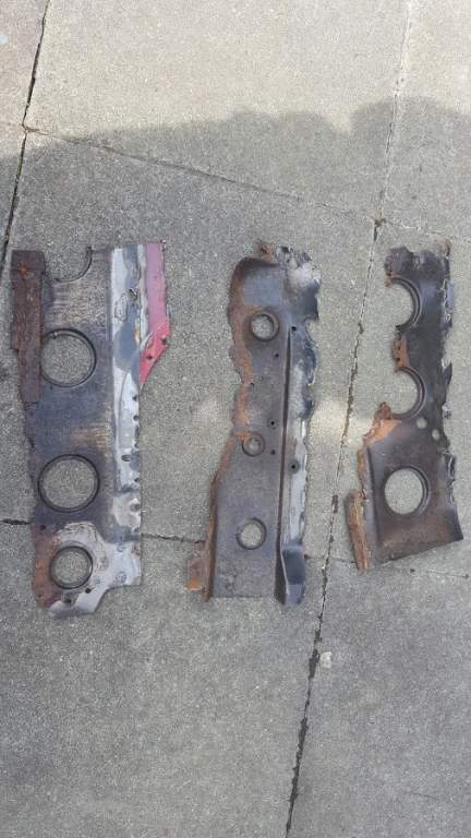

I have found that wherever was welded before that was where the rust has hit the worst.

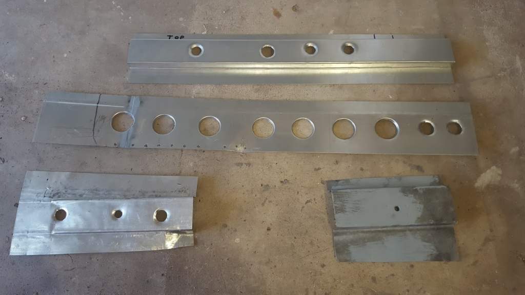

Onto the sills now, I bought some 1.2 mm galvanised sheet steel, Now lets be clear about this... Galvanised is very nasty stuff
to be welding the fumes it gives off is highly toxic so all the welding has been done using an appropriate respirator mask under my welding mask
so now health and safety is out of the way lets see what we have done so far,

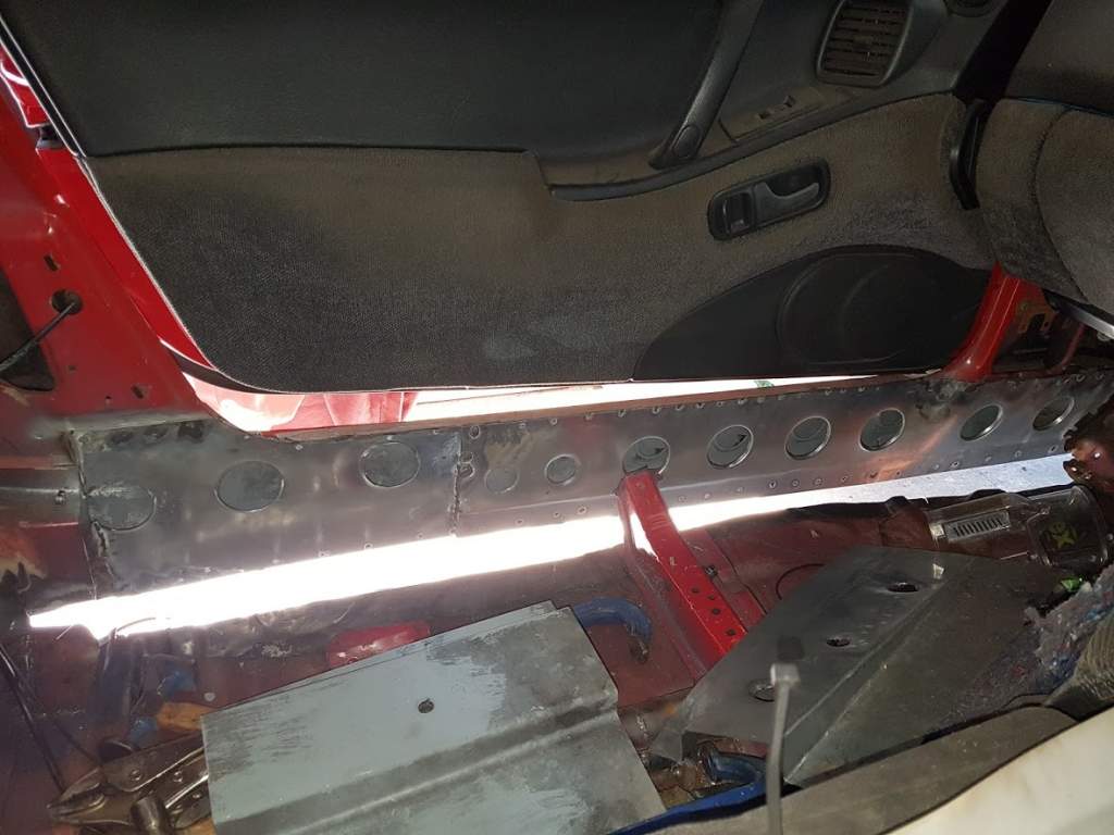

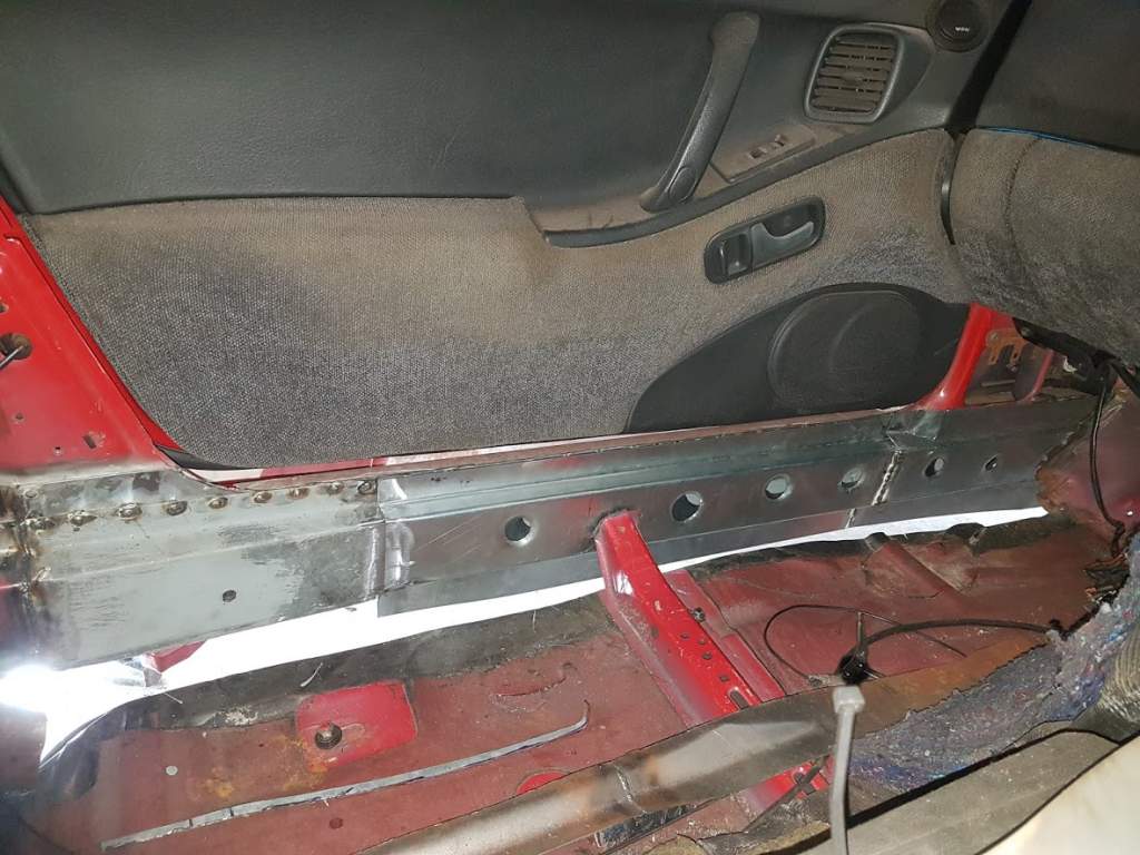

Cut and formed the steel to match the old parts that have been removed

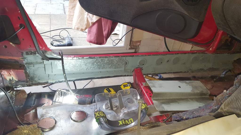

the sill has been stripped from the inside to the outer sill that has been patched up and treated with bilt hamber zinc primer and dynax seam sealer on all welds
Next the middle sill
next the inner sill has been test fitted before welding, I will update as I go along
Do you recon that's been easier from the inside? Looks like it makes sense and especially if your working outside a breeze can ruin your work particularly using CO2.
for me it was the only way as the outer sills have a fiberglass side skirt that has been blended into it
as for doing the job from the inside its great the only problem is when you get to the bulkhead its quite tight in there and I had to cut a section
out of the floor to access the sills, but the floor was rotten anyway so had to be cut out

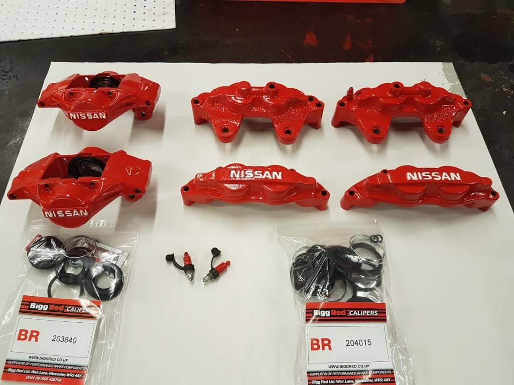

Onto the calipers now,
Fully stripped down and shot blasted, I split the front calipers and in my moment of madness I have forgotten which calipers half match as they got mixed up
im sure they wont make a difference, but its good practise to keep them matched
so after shot blasting I cleaned the cylinders of all marks and polished them,
painted them using http://www.brakecaliperspecialists.uk/brake-caliper-painting-kit/ in post box red, They even added white paint for me to do the lettering very kind of them
then I used http://www.biggred.co.uk/brakecaliperrepairkit_brk204015 for the front And http://www.biggred.co.uk/brakecaliperrepairkit_brk203840 for the rear
Now when I fitted the rear seals there was a big lip on the rear caliper casting to stop the rubber boots sliding off
when on the other hand I fitted the front there was no lip at all on the casting and this allowed the rubber boot to slide of easily,
I used the old caliper boot rings, as the new clips from bigg red tended to slide off the boot quite easy
anybody else noticed this?

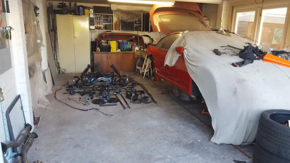

Well kind of a lot has happened since rebuilding the zed
I became a dad to a beautiful little girl called Erin
So my work on the zed is limited to say the least
Saying that, the subframe is up, fuel tank is in and the diff is in.
