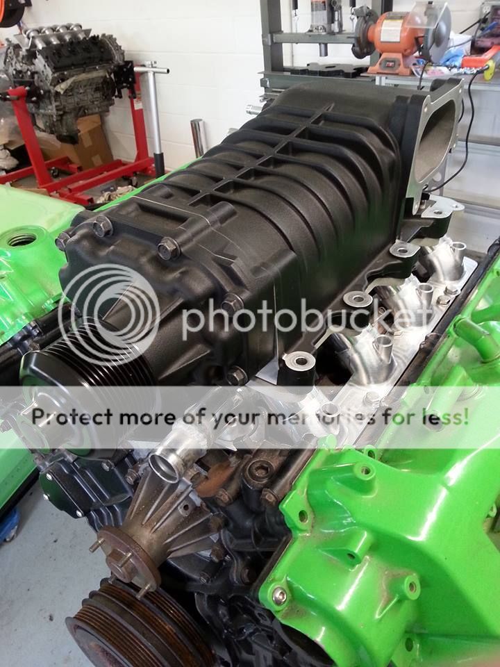

There are a lot of Twin Turbo setups already, especially overseas. There is also a Supercharged one in the UK in a 370z, ran by Shane Lynch (from Boyzone) for Team Japspeed.

Very nice, if the NA route didnt work out I think SC would be my next call.
