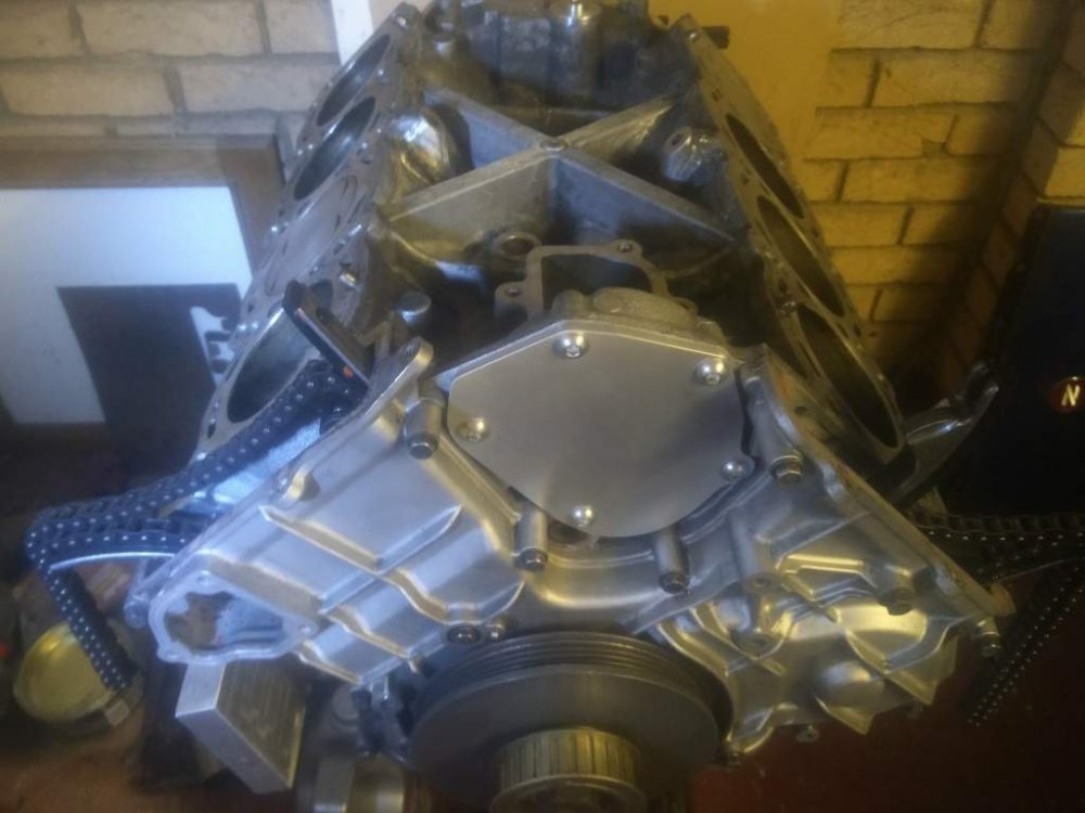

Electric Water pump and Power Steering pump, so the only ancillery runing from the crank is the 3-Stage Dry Sump pump.
THe VH is chain driven.
Is that to free up a few extra bhp or for convenience fitting the engine?
Both reasons, Freeing up parasitic drag on the engine for additional power and Packaging Limitations.
But an Electric Water pump reduces the risk of cavitation at higher rpm than the original was designed for, it can also be setup to reduce heat soak with the engine off, warm the engine up quicker and efficiently manage the Coolant temperature at all rpm's and loads, rather than the stock mechanical setup which is always a compromise.
The Electric PAS pump is mainly due to packaging limitations, and the power it can free up when setup correctly. Its essentially an EHPAS setup (electric-hydraulic), so wont have an effect on the way the original Hydraulic PAS works or feels.

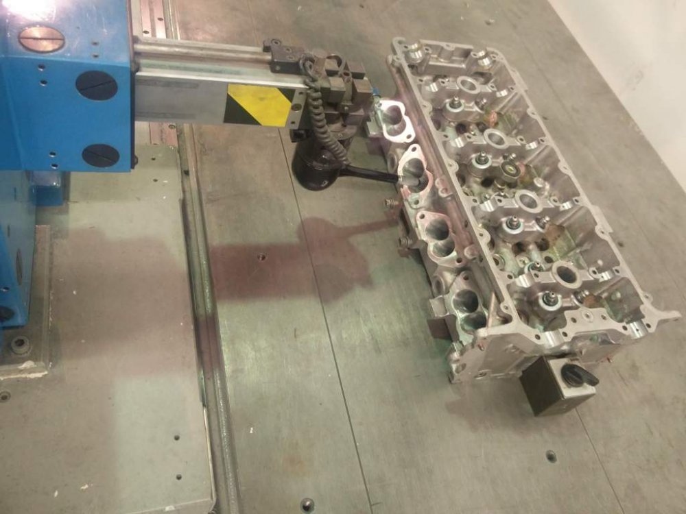

Having the first Head CMM Inspected/Measured during Intake porting progress at work :

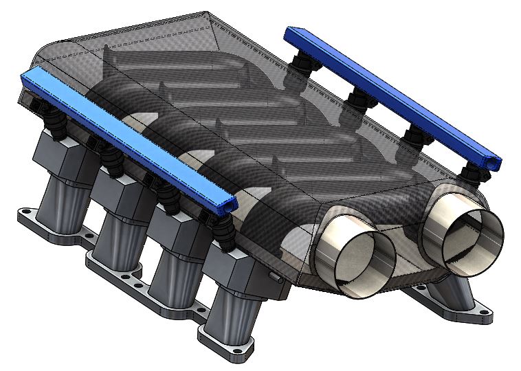

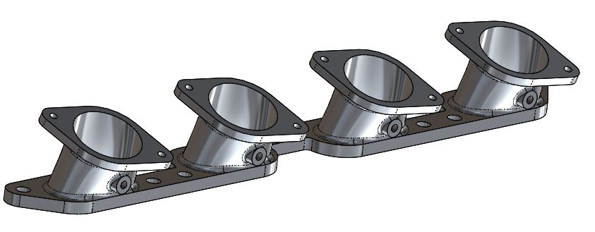

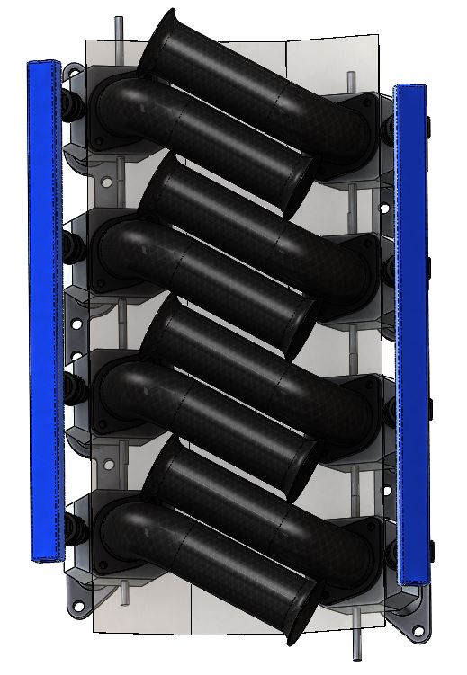

Some Initial ITB/Velocity Stack/Airbox draft designs. Top Mount Fuel Rail setup with Bosch Injectors
Working to a ~350mm Valve head to bellmouth opening length.
Shorter TB to Valve ratio length with Injector just after the Throttle to take advantage of local turbulance for fuel atomization. ~10litre Airbox Volume, to (hopefully) avoid intefering with ITB Flow.
Trying to make the most out of the limited clearances available.

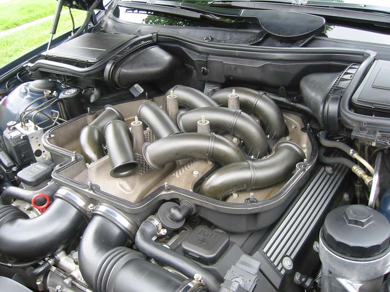

I think you need to be more creative with your stack shapes!!!
I'll just leave this here as an example
:scared: :wacko: :lol: :laugh: :blink:
[ATTACH=CONFIG]102796[/ATTACH]
E39 M5 V8. Madness.
I don't know a huge amount about velocity stacks but know you can change features of them to give different power characteristics, right? Do you have a particular aim with yours?
Thats right, the main one being the entire intake runner length from the Intake valve (in the head) to the Velocity stack opening. Its to do with the pressure waves (Helmholtz resonance) from the opening and closing of the Intake valve, and taking advantage of the pressure change and the subsequent pressure wave to improve Volumetric efficiency. I am aiming for the most gains between 6000-9000rpm, without comprising low-end characteristics too much.
You are essentially setting the length for the optimum rev range you are aiming to make the most power for. Longer=lower rpm, Shorter=higher rpm. Most aftermarket ITB setups are a comprimise between the space available and the ideal runner length. You will often see setups with far too short runner lengths for the engine characteristics.
You can also alter the ratio between Throttle valve and intake valve length, versus throttle valve to Bellmouth length - compromising between optimum fuel mixture and throttle response.
There are minor characteristic changes like tapering of the bore and the profile of the bellmouth which all aid in improving the velocity of the flow, and everything needs to be matched in diameter as a ratio of the mating system. You essentially have to take into account the cross section area throughout the system - Valve head diameter (minus valve stem diameter), Cylinder heat port diameter, runner diameter, throttle body diameter and Velocity stack diameter - Ideally tapering at an optimum ratio at all times with the aim of increasing flow velocity without restricting flow rate.
[ATTACH=CONFIG]102790[/ATTACH]
[ATTACH=CONFIG]102791[/ATTACH]
[ATTACH=CONFIG]102789[/ATTACH]
[ATTACH=CONFIG]102788[/ATTACH]

Changes like tapering of the bore and the profile of the bellmouth
If I dare ask a question...
Are you not doing anything with tapering yours or doing better bellmouths because of space? manufacturing? both? other reasons?
Space constraints - Im clashing on the bellmouth if I taper or go larger on the Belllmouth diameter itself.
It is just a draft at this stage though, I cant move to manufacturing till I take some final measurements, and I cant do that as the heads are off the Block currently.

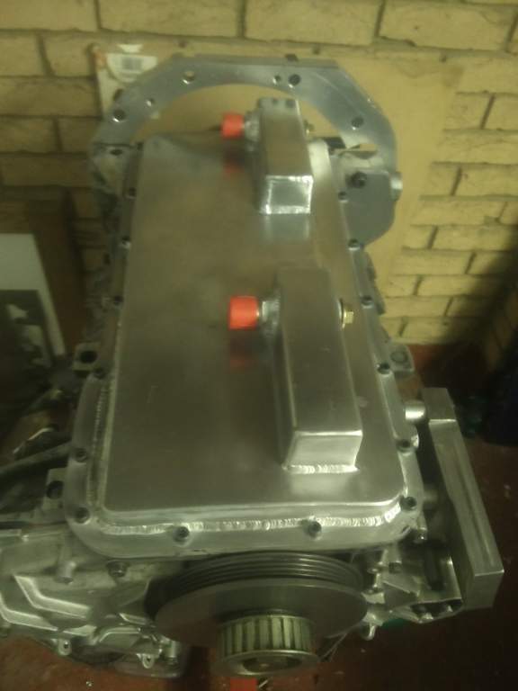

Winter for me has mainly consisted of working obscene hours for the build up of the F1 Season, but now that the Pre-season testing is out of the way Im finding myself with some spare time for the V8 Z. :clap:
Finished the Head Intake porting, and will be sent off to have the gasket surfaces skimmed, so I can start the assembly with the New Uprated Valve Springs (Thanks to VHPerformance).

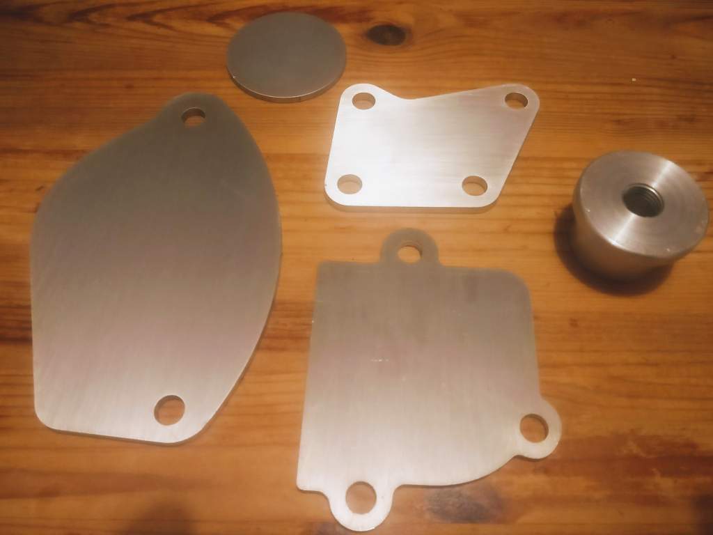

Finished the Lower Intake design and is with my Machine shop for CNC Machining, to be done in-between paid jobs.
Various Lasercut Blanks, bungs, brackets have been produced and test fitted to engine.

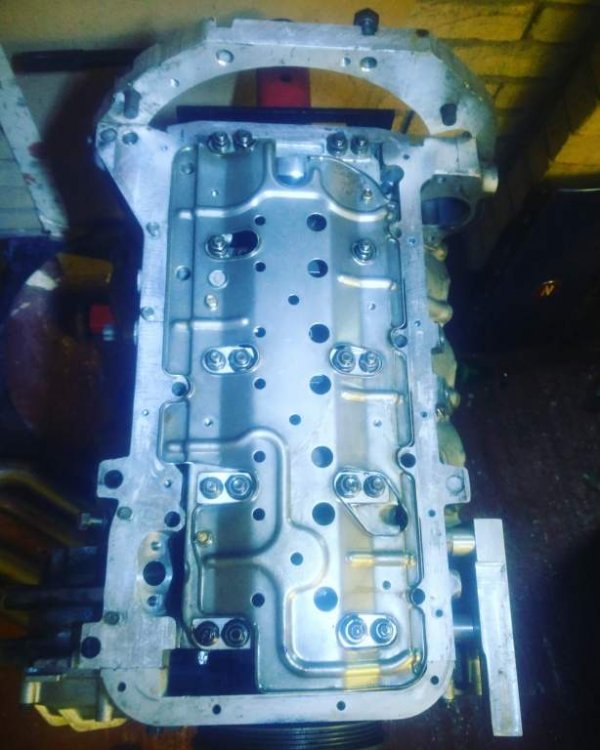

Aluminium Dry sump pan fitted to engine
I've started work on the Custom fuel setup, using Dual Aluminium extrusions and machined for 14mm Bosch top feed injectors, in a parallel configuration, Adjustable FPR with Black AN8 Fittings and Black Braided lines.
Edited by Yowser

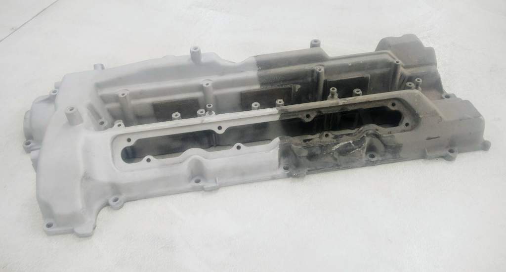

Shotblasted the Cam covers the other week, in preparation for some modifications and then Powder coating.
Planning on a Wrinkle Blank Finish.
