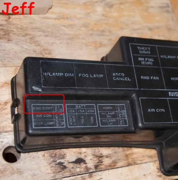

Check the fuse marked up engine cont its in the fusebox under the bonnet passenger side by the headlight, it is the alternator exciter circuit, it also feeds power around the engine to the various things. It is a red 10 amp, change it even if it look ok with a fresh one, they have a habit of going high resistance and can cause all sorts of issues see if the battery light goes out then.

Thanks Jeff I'll change it over in the morning!

Yes Jeff I swapped it over with the AC one, I had a battery fail so it was an old one I had kicking around that I had charged overnight which maybe didn't have full charge, I charged it up again the next night and the light wasn't on at all for the Coventry trip.
