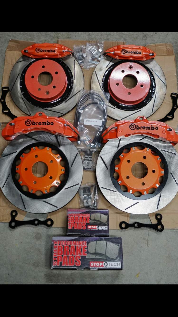

Right guys, just testing the water, who here would be interested in Big Brake kits?? I've got myself 6 piston Brembo fronts with 4 piston rears including brackets, hardware etc, they fit to the 370z 355mm fronts and 350mm rears discs, I can also source these. My contact reckons a group buy of 10 sets, I can source Porsche, AMG 8 piston and other large 6 and 8 piston fronts with 4 piston rears, haven't got a price as such yet, but would probably be close to £1500-£2k, these kits direct from Brembo and the likes retail at £3-£4K would anyone here be interested if I got the ball rolling???

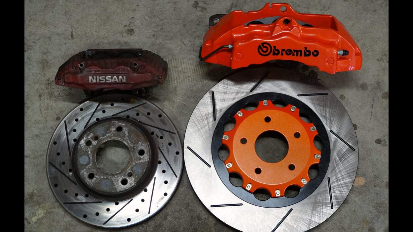

Fronts comparison

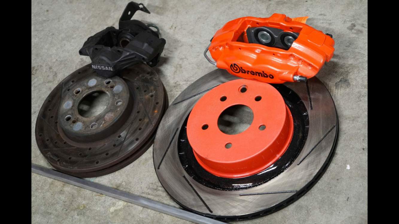

Rear comparison

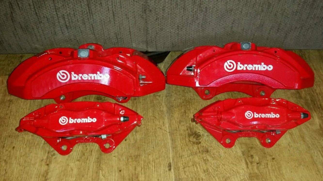

Full kit

There's an assortment of combinations that can be used for the Z's, Porsche Cayenne 6 piston, AMG 8 piston, (I got Jeep SRT8 6 piston) and a few others from the Porsche, Merc range, most built by Brembo. The brackets are CAD designed and tested for strength, they do the front 6 /8 pots and rear 4 pots. Calipers are brand new unless otherwise stated. I'm awaiting a full price and breakdown of prices to see what is the best way to go on these, but I know he's cheaper for the Hardware (springs, pins, hoses and pads) than shopping around yourself as I've been researching my own parts and I can't come clos to his prices even in the US :thumbup1:
Interested what the rear combination and fitment is.

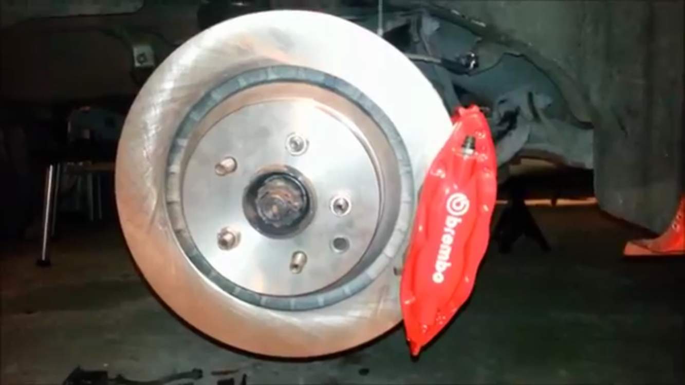

Rear is Brembo 4 pot, here's a pic to give you an idea:thumbup1:

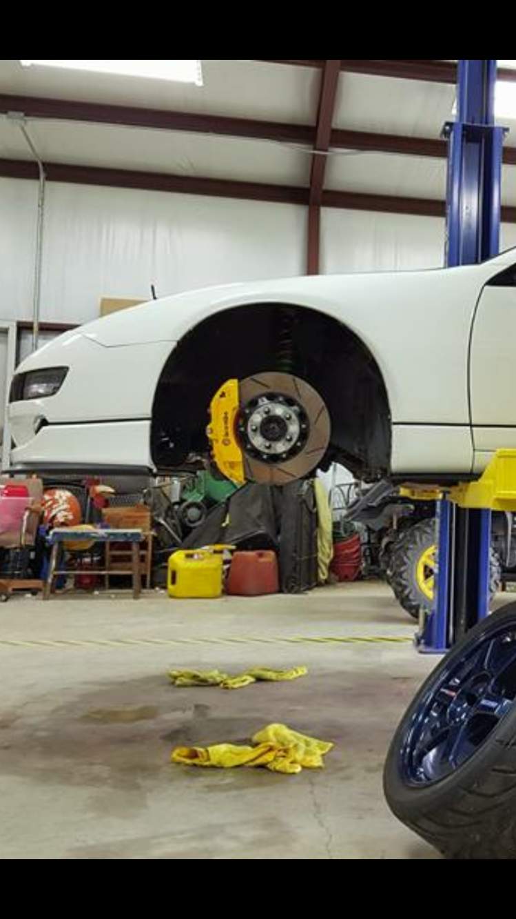

This guy is running Z1 2 piece discs both front and rear, the discs can be OEM 370z's or the fancier (+expensive) 2 piece, 355mm front and 350mm rears.

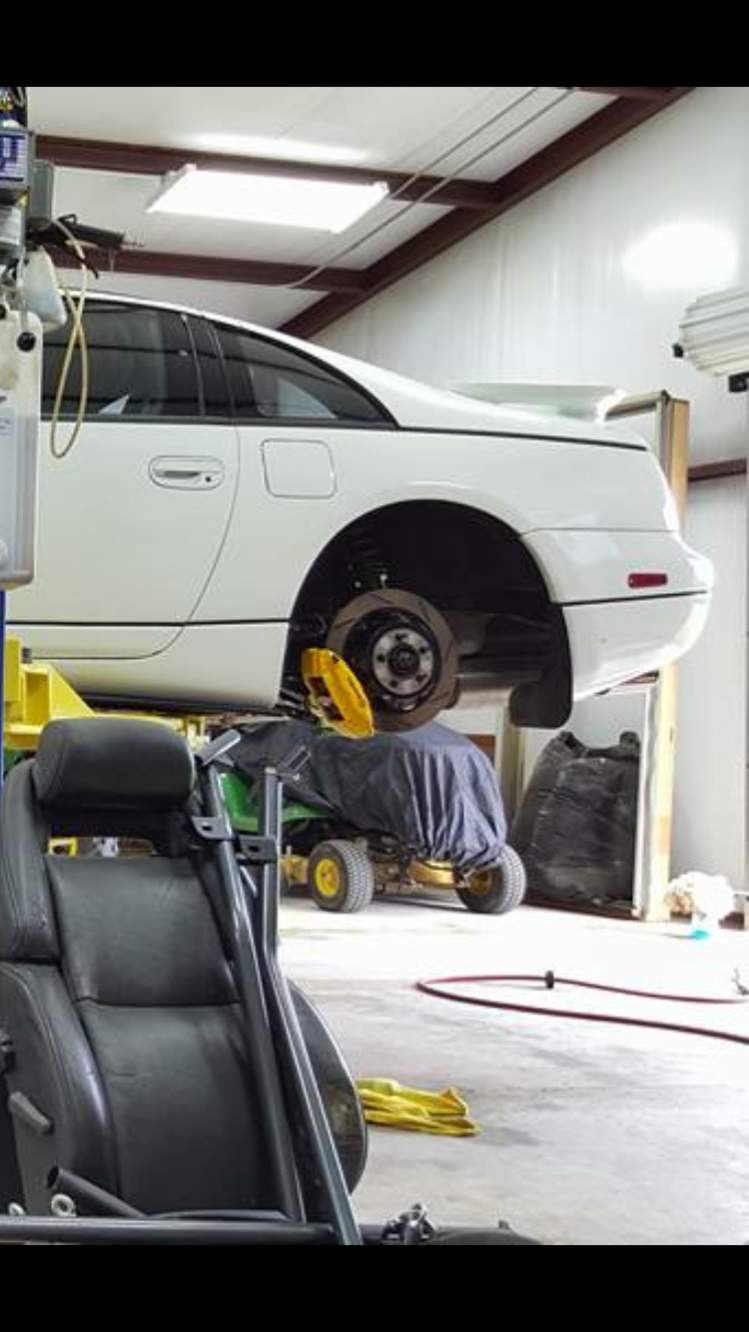

Erm, those rear ones look... hilarious...! That was really the only way someone could think to mount them...?
I was thinking that they hung a bit low also, I'll try and find a pic with them fitted with wheels:thumbup1:

The guy with the yellow rear calipers used VW Toureg ones instead of the Jeep SRT8,s.
The rears are 4 pots from the rear of a jeep srt8, they're rear calipers and not fronts that have been thrown on, they're used in conjunction with both the 4, 6 and 8 piston fronts that are available for the Z.
The first pic rears don't seem to sit as low as the yellow ones?? Maybe that guy has run different rears??

That is the problem with adapting axial mounted calipers to fit applications they were not designed for, the calipers are usually supplied as OEM
fitment by the caliper manufacturers for specific cars. Typically the caliper mounting lugs get in the way of the hub mounting lugs and you need
to offset the caliper to get enough space to fit, as in the case above.

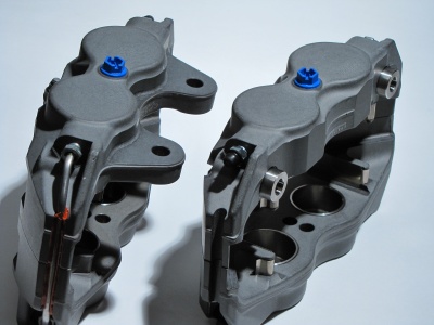

For reference here is an axial mount caliper left vs radial mount right (which offers more flexability in mounting in bespoke applications).
He's doing brackets for Radial mount also, I'd say the pics above I guys trying things out themselves, I'll see if he can send me some pics of radial mounts fitted to Z's:thumbup1:
