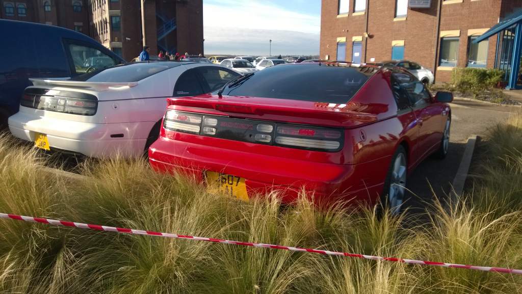

These are the most recent pics I've got Stephen. I've not got the car at the moment as its being resprayed.
They are the 350z Touring wheels, 18" x 8J all round... Not sure on the offset. I do like the style tbh, they are a bit marked (nothing major) I suppose I'm thinking they are gonna look tired next to the car when it comes back. Looking at them, the front wheel definitely needs to come out abit.. Maybe 30mm and the rear maybe 15-20mm?
