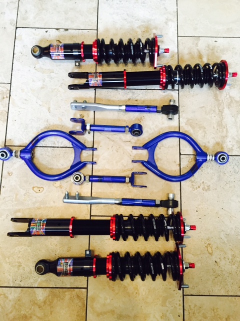

[ATTACH=CONFIG]94818[/ATTACH] like this??

The first question to ask is what do you want to achieve.
Thanks Stephen. So, the main purpose here is to make sure the wheels are sitting straight and be able to get good alignment and a good stance.
At present, I've just got the Meister R coilovers And in turn, the wheels are in slightly at the top. I really want them sitting right. I also bought the drift works total hicas delete kit... Just not fitted it yet

i have lowered suspension i used hicas lock out, rear adjustable camber arms, from adjustable camber arms and adjustable tein front tension thats was plenty to get the car alignment back to stock setting
So you have excessive negative camber?
Not massively mate but definitely in at the top and wearing the tyres on the inside

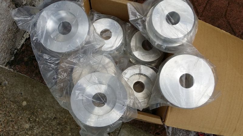

I also have these but not sure exactly what ID use them for lol

thats what i have upper camber arms front and rear
In order to get the car aligned correctly after installing the coilovers you would need the front upper control arms. I have powertrix installed on mine, but truth be told, I have not been very pleased with their quality. I will be switching over to the Z1's, they have had pretty good reviews and look stronger. These are the only non-SPL parts I have installed on my Z. I would also suggest replacing the tension rods with the SPL titanium. These two will take care of getting everything in the front back to spec.
The rear is a bit trickier, but the rear upper control/camber arms and toe rods will get you back into spec. Also while you are at it check your rubber bushings as these will also affect your alignment, replace as needed.

Those are subframe and diff solid mounts. I have them fitted. You probably won't want to fit those lol, very harsh.
