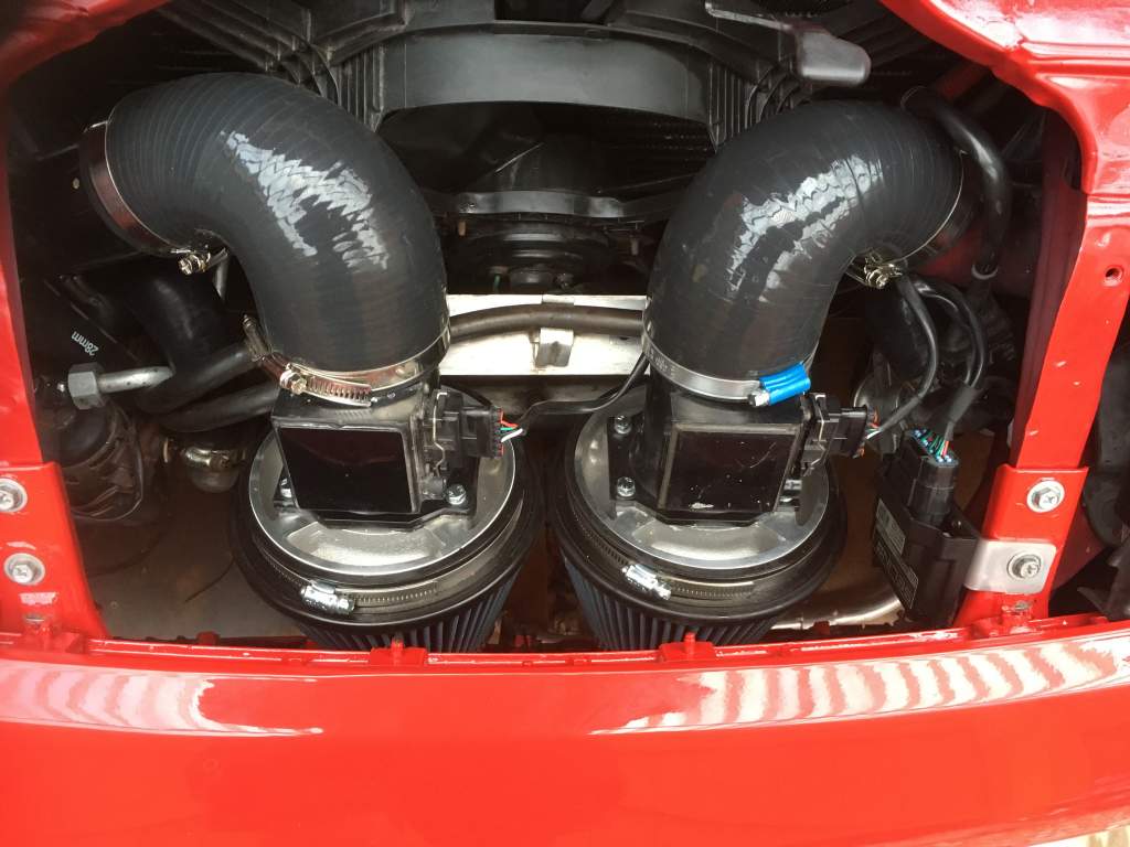

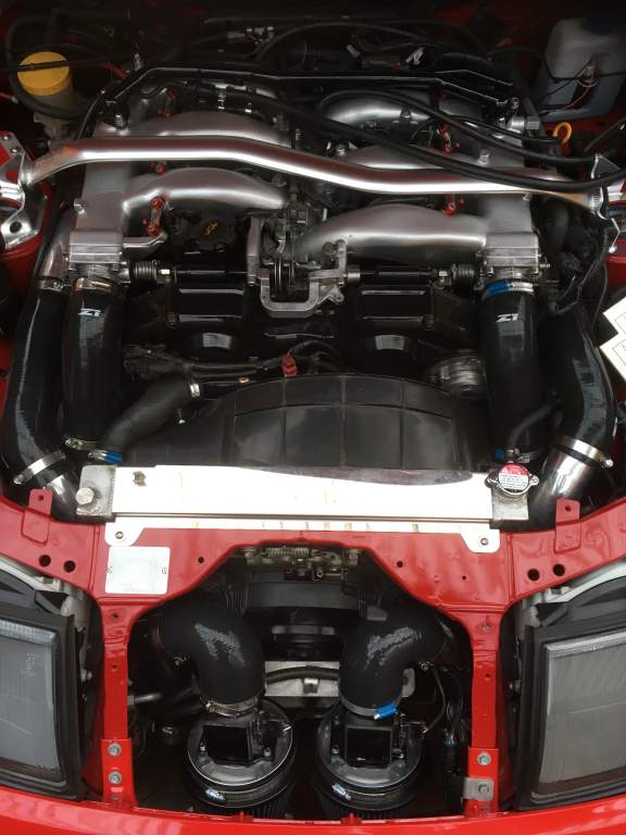

just fitted the stilin duel maff set up the car starts but not yet drivin it will report back its in add mode set up

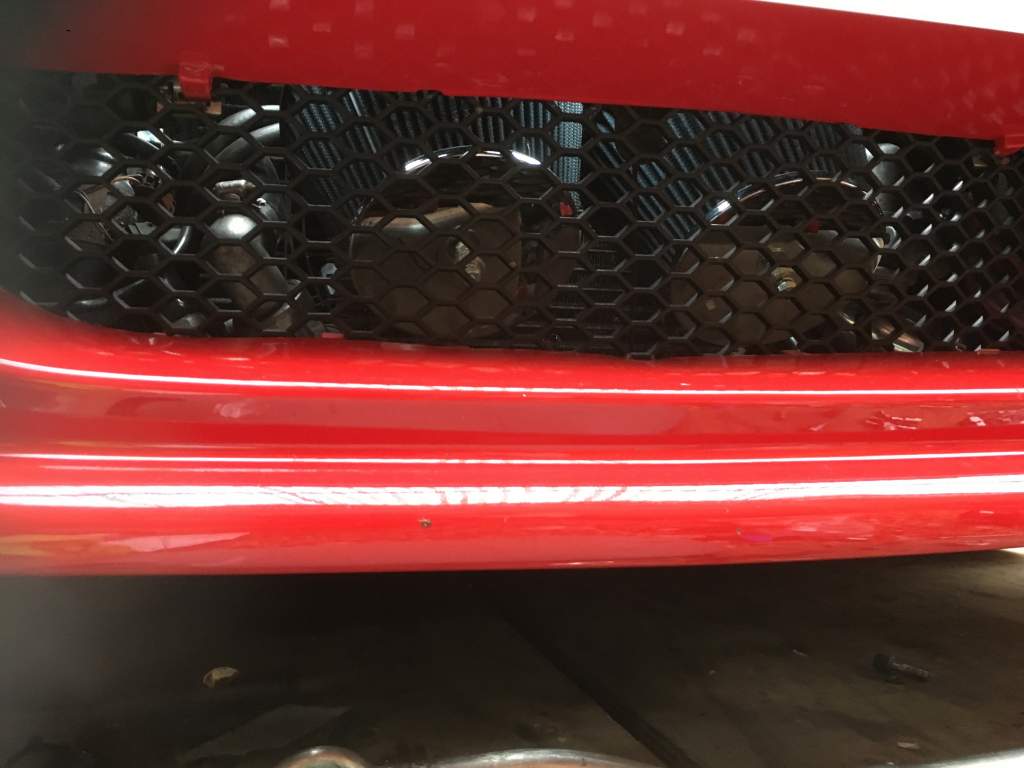

forgot this pic you can see the filters through the mash looks cool
[ATTACH=CONFIG]101659[/ATTACH]
Best build a shield for those they are gonna get wet real quick in the rain.....or just dont drive it in the wet

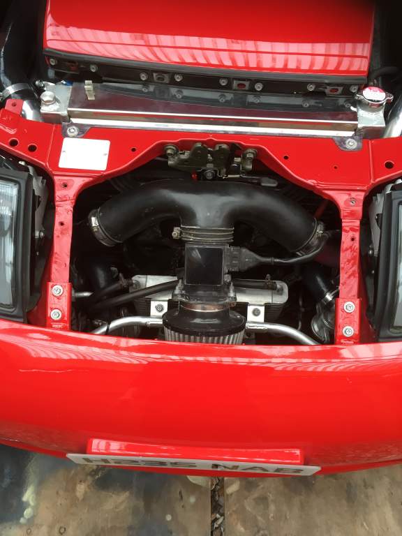

so after a test run with the sillin in add mode as it should be the car run really rich soon as you open the throttle you get a AFR of 9.0 car stumbles even at motoway speed open the throttle at low rpm and get a reallly rich mix. you may well be able to add this to a stock car with add mode and it run ok but with all the breathing mods i have done this dont work so removed it till the time of bigger injectors are remap in a few weeks. run fine with the stock single maff and filter back AFR fine then, i did think with the extra maff if anything it would run lean anyhow was only a test.
so turns out the running rich was due to a faulty 2nd maf the one that was on the car was fine the 2nd one i got few months ago was not working i ran it on the car on its own and it over fueled fitted the original one back on and it was fine again i have a other maff now so will fit duel maff set up back on with the replacement maff and hope it should be ok this time

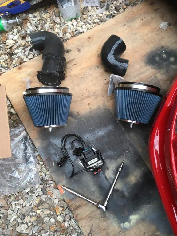

so the idle issues turned out to be the 2nd maff i had was duff when i fitted my first maf back on with a jtw filter the car ran fine then started funny idle turned out the new jtw filters i have came pre oiled and this killed the maff just used a whole can of degreaser and washing up soap getting the oil out of them there was lot the filters look blue thats the dam oil as a hour of washing out there now white
Edited by dan300zx
i had the same issues on the boxster a oiled filter killed the maff just used it dry for the little miles i will do in the car am keeping them dry will be fine.
Common practice to oil the foam filters like the big green HKS but ive never oiled a gauze and fibre filter on cars or bikes..
I found with the K&N filters they were far too wet from new, but after cleaning off the excess oil they didn't cause any more problems.
