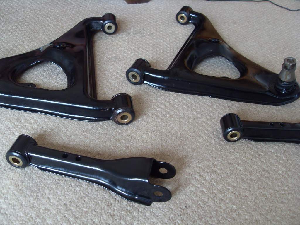

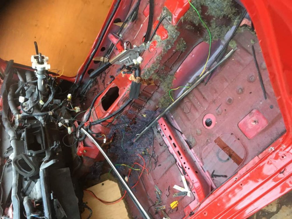

time to start a thread now so wil have a go loads of pics to up load so will start with some parts i have

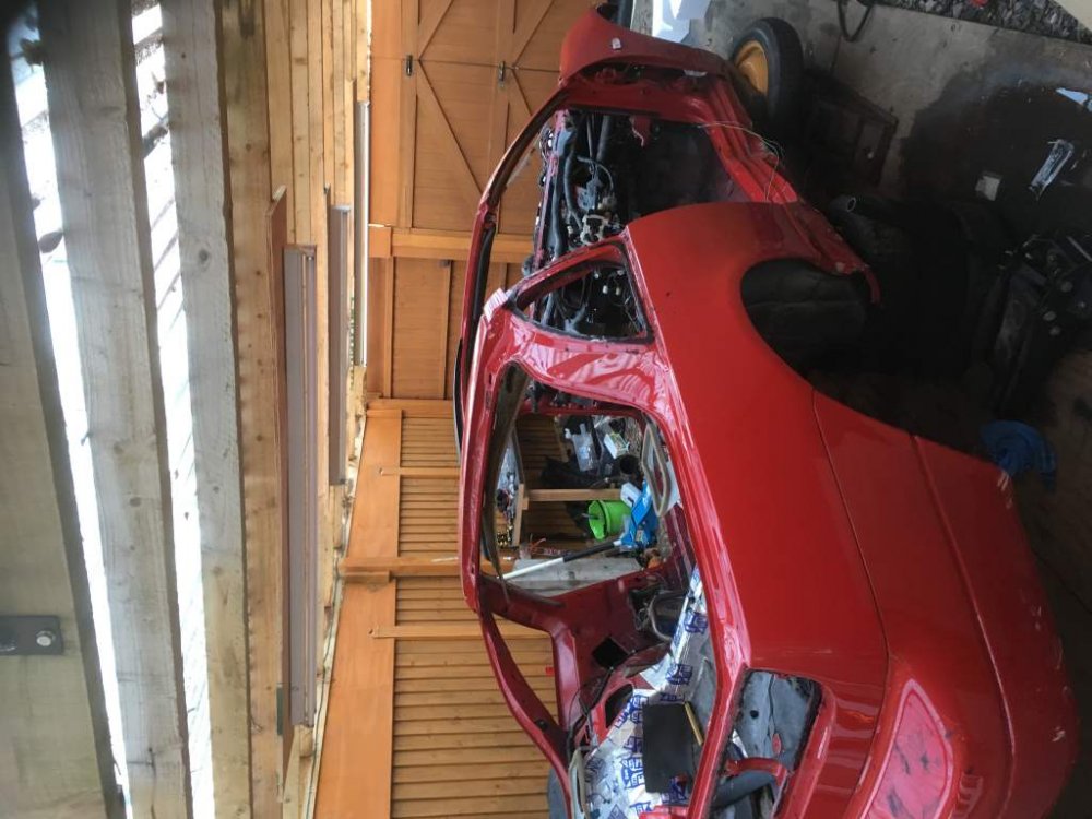

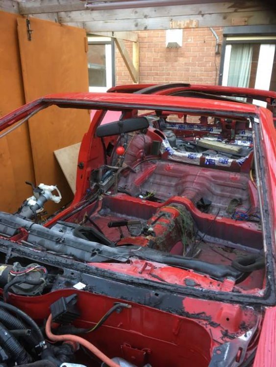

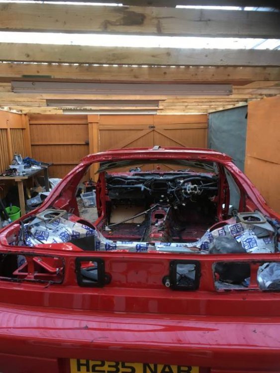

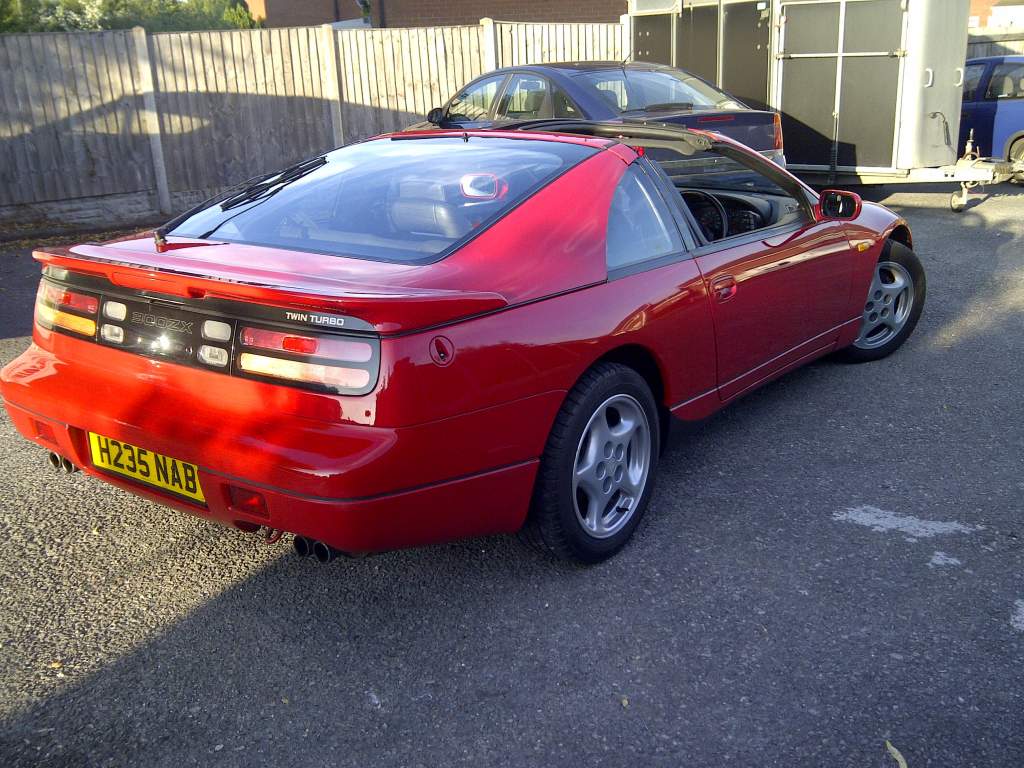

IMG-20130714-00443.jpg the car 100% uk stock when i got it ,

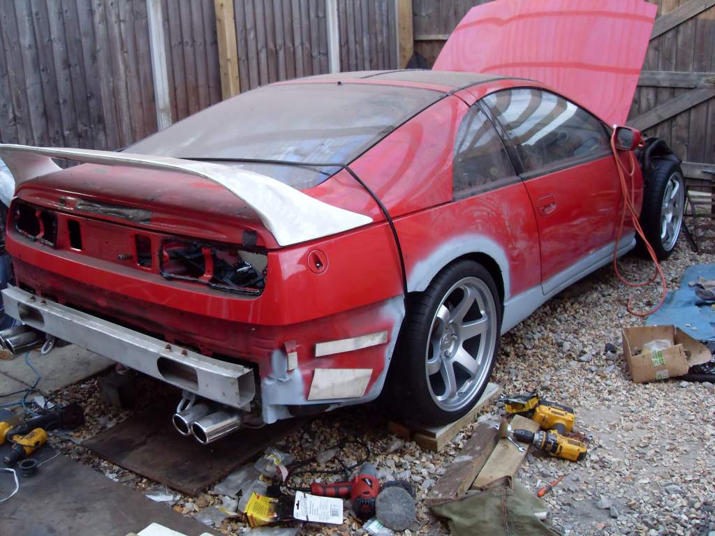

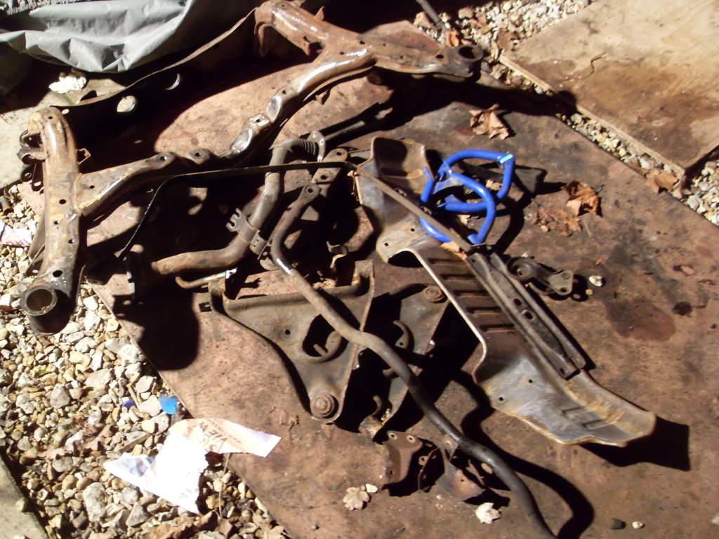

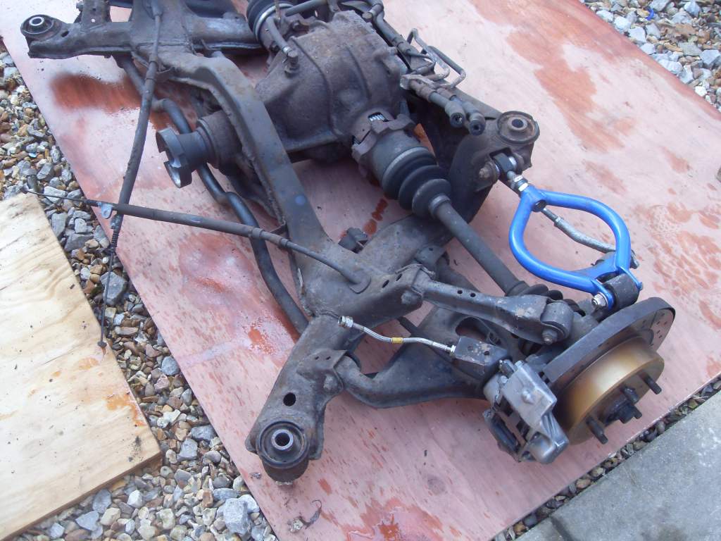

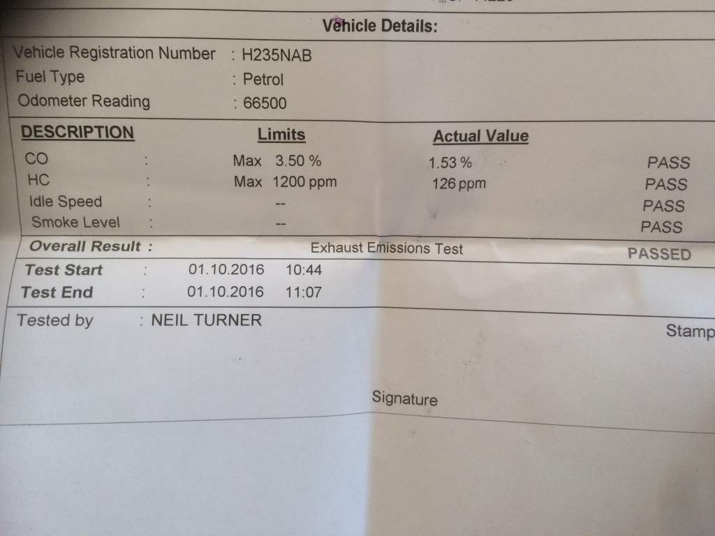

I didn't think it mattered about the cats, as the 300zx does not appear on the VOSA database.
Therefore it should be tested on a lesser stringent emissions test at idle. 3.5% Co2

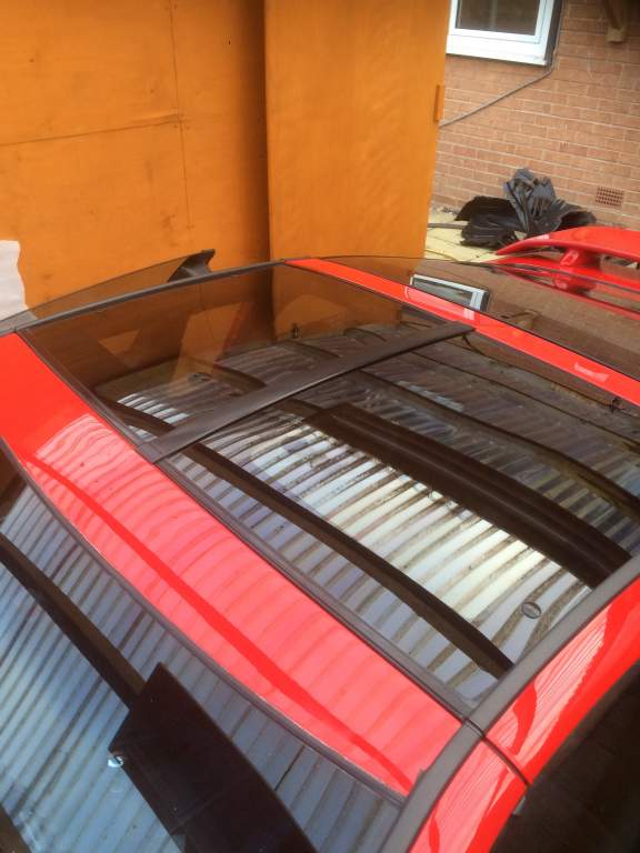

i have a few bits the roof trims need putting on started before but gave up hate things with clips and tangs and i need to do put the door sill trims on

i was reading the its pre 92 so should be tested as a non cat car

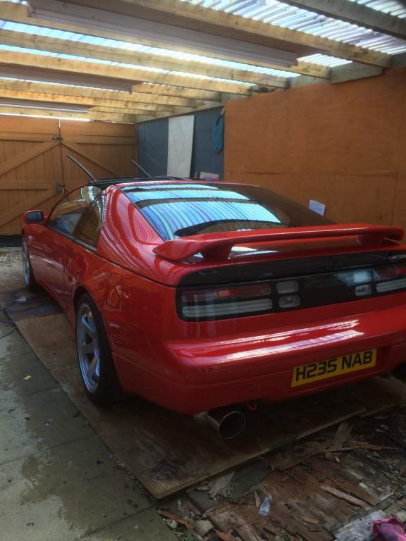

Awesome. It's sat lower than I was expecting on the Koni's. Any side profile shots? Glad your happy with it mate, get it MOT'd and enjoy it. Oh and don't stuff it into a ditch/post/Armco etc :lol:

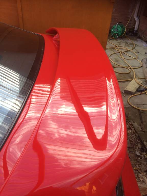

its first clean and polish and wax also made up the t tops and fitted them will get some better pics when its out going got mot 2 moz now
passed mot he could not find a one thing wrong with it had the whole shop stop work to talk about the car my afr gauge at idle is about 14.7 so thats prefect the co was 1.53% so was well under the mot limit and hc were 126ppm so its running nice and clean indeed with no cats
