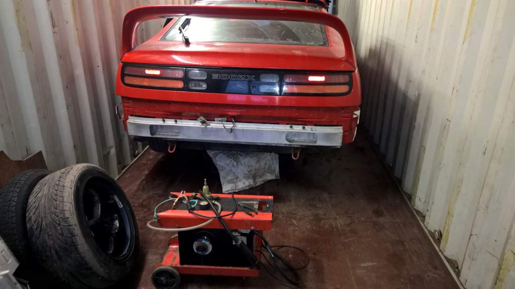

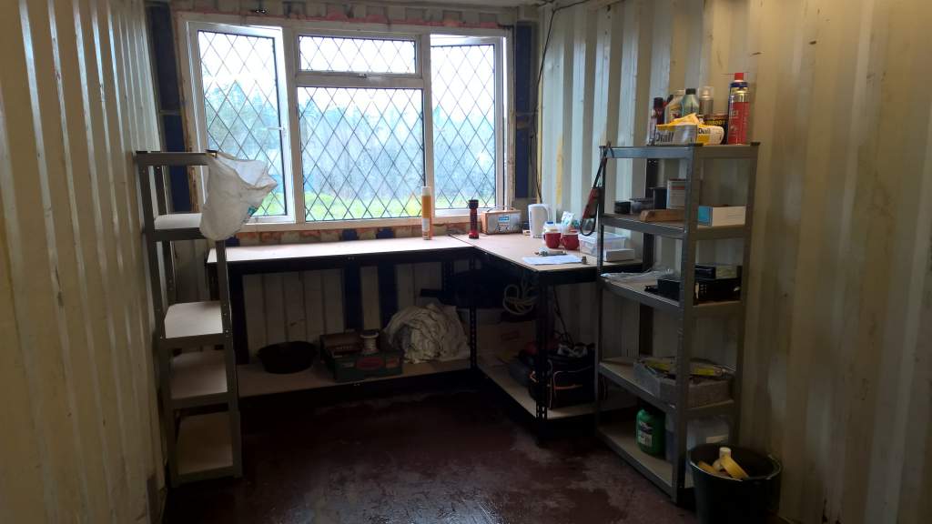

Its a 40ft container with a window cut in it and water and electricity, all for £15/week. Im allowed to do anything I like in it, as the landlord said, he doesnt care. He said it it catches fire, it will only burn everything inside anyway! Ive got a work shop area at the end, car in the middle and space at the front for a modern chic living/dining area... i mean space to dump stuff like bonnets and interior bits etc! Width is a bit tight, Ive parked the car against one wall to allow maximum space and ive got just enough space to work in, so far...

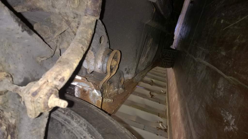

Near side sub frame mounting, please note sub frame not attached to car because bolts missing and bits bolts bolt into missing!!!

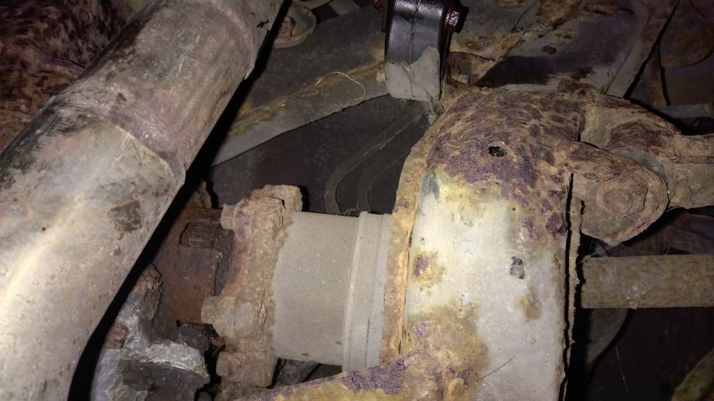

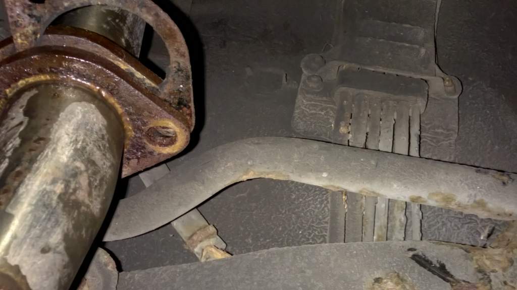

Near side subframe and drive shaft. I think a sand blast and a powder coat will bring back the sub frame.

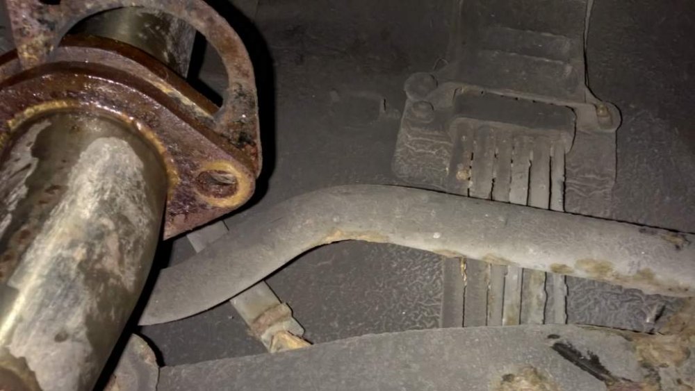

Boot Floor. Looks pretty good and solid, although ill need to do all the brake lines...

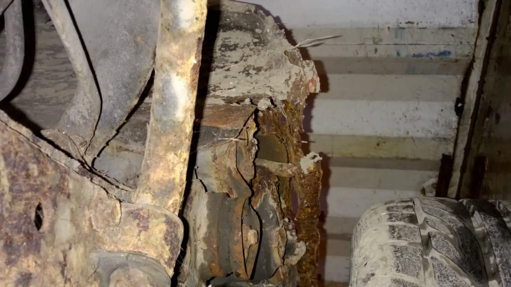

Offiside sill and subframe. err.. how to put this politely? The titanic has less holes and rust...?

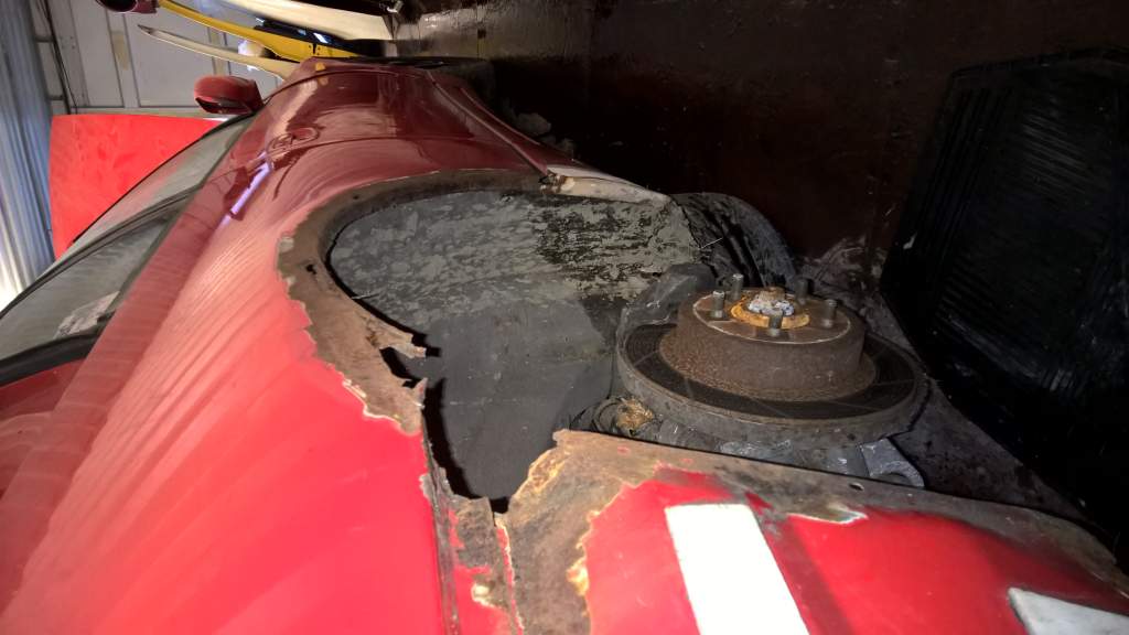

Offside arch. *starts to whimper*

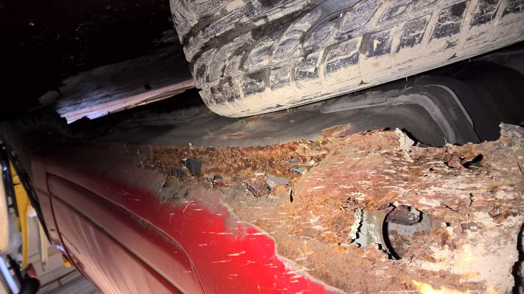

Driver side sill. *cries* what have I bought? :lol:

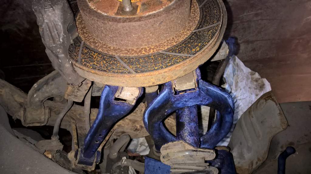

Spot of de-rusting. Im trying to do everything on each corner before moving to the next.

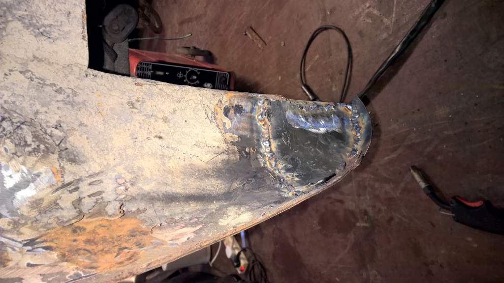

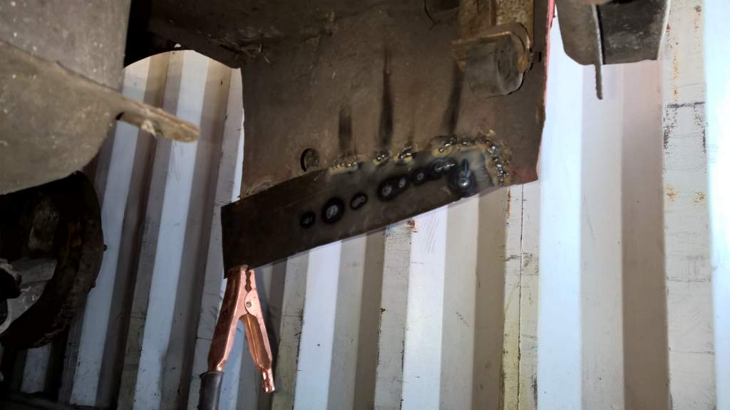

First bit of welding
Offside rear part of rear arch rebuilt. Just needs priming and waxoyl'ing.

I don't want to sound negative here (I know it will) but honestly I think that body is scrap, I admire your effort to try and restore this zed but if your only going to repair bits like you have in the picture I think your wasting valuable time and money, it won't last a year before it needs more welding continuing on from where you have stopped, you must get rid of ALL the rot, and honestly that welding looks to be very poor quality mate, as said please don't take offence as none is intended, I just think this car needs to be laid to rest looking at the pictures.
Body repairs on this level is tricky for a pro on a ramp, let alone up against the walls of a container.

Youll never stop that rusting welding in metal like that im afraid,needs to be primed before its fitted with weld through primer like Wurth Zinc Heil or similiar if you want it to last.
I have some of that Wurth zinc primer on the way. My friend advised it was the best and rust.co.uk taught me a lot too
