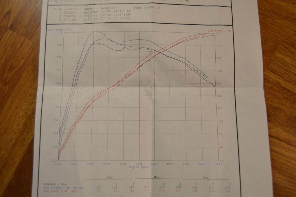

Ill take a shot of the of the print out...
That graph tops out at 6k rpm. Did it change gear then as the graph should peak and then go down slightly to get a Max HP. Was the gearbox in the power mode which holds the revs longer before changing?
Mate in the end I don't know what they did, but like you say the graph doesn't top out. The values of all 3 runs are all over the shop.
I've never owned an auto and the way the bellends were going on, it was like it was a big issue to run the car.
I'm guessing you/they never changed the switch to the power mode then, so it probably changed gear too early.
Live and learn bud. Onwards and upwards
Taken a few autos to the dyno, unfortunately your graph looks similar to mine,
Autos on the dyno generally the graph is whp not bhp, so 213 at the wheels. So for a 20 + year old auto isn't bad, was 280 bhp from factory, will have lost some over time, and automates are quite parasitic so will lose more through there, roughly speaking add 70 onto our auto figure to get bhp. So your about right imo.

Lets be honest though if they knew what they were doing and things were done correctly, why is there so much variation between whp figures across all 3 runs?
1st Run a high of 60
2nd Run a high of 212
3rd Run a high of 161
Which surely must state that something different was being done across all 3?
From what's been mentioned in here its as simple as Overdrive off, into Drive and off you go. If that was what was being done yesterday I doubt i'd of got such big variations.
If we're saying 210 odd RWHP as appossed to FWHP then yeah that probably is about right. You loose a lot between the engine and the wheels esp in the auto.
