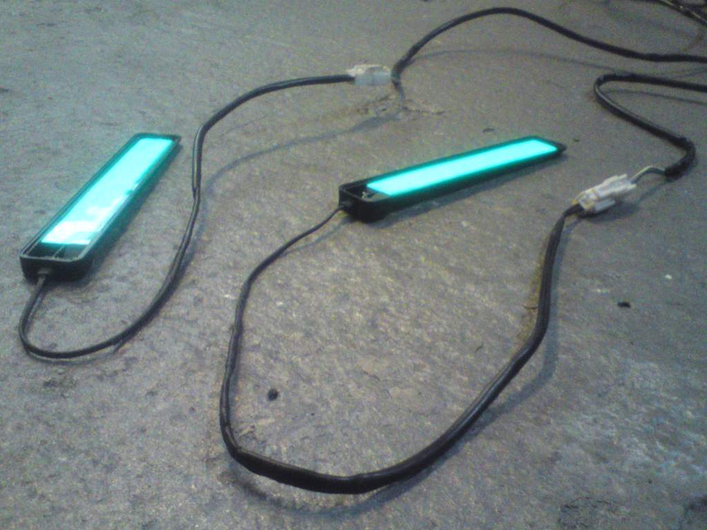

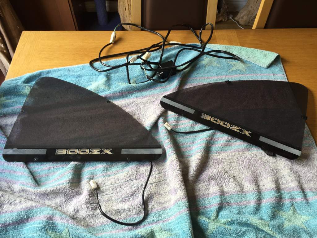

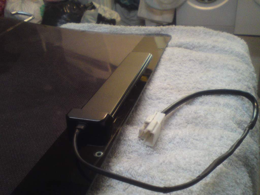

Got em at last, can't wait to get these fitted:-)
As per some others threads stated these got sent to me and i soon concluded that the invertor was useless and so were the original 20+ year old green sheets, they'd flicker at best.
I do want to use all the original plugs and wiring so i will have to solder in new sheets and a new invertor, make everything real tidy and as oem as possible.
Made a start which was mainly planning/thinking and thought i'd better take and upload up a pic and here it is, things going well and these will turn out very well :thumbup:.
These look really crisp and a strong green colour in real life which i'll try and show on further pics.
Great news, looking good Andy. Pleased to hear the wiring and original plugs are good, looking forward to the final result, Thanks mate. Great job.

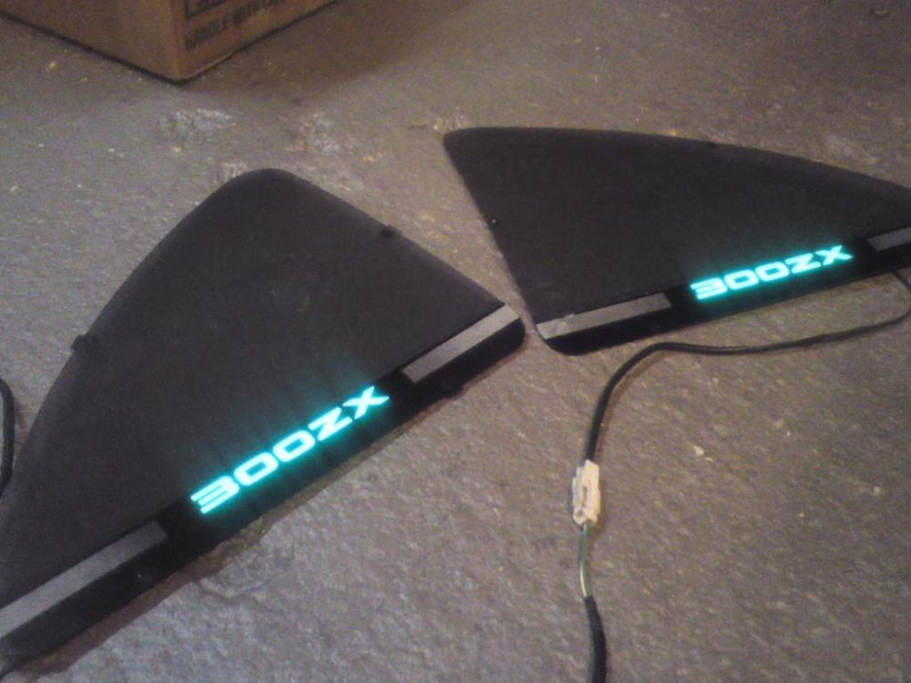

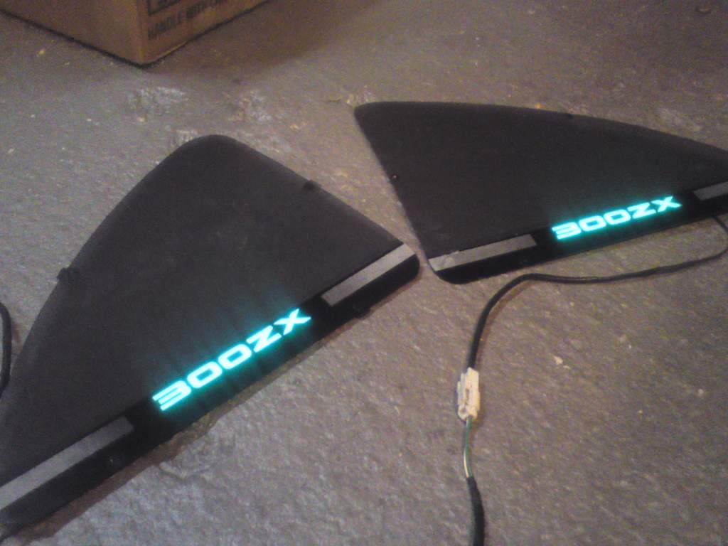

Some more work done on these today :thumbup1:.

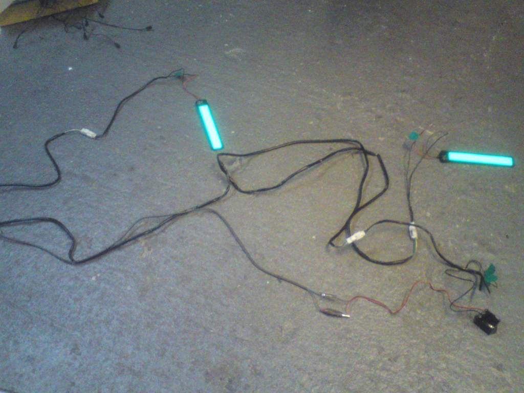

After attaching securely the new el sheets i then had to make sure and colour label and pre test that i'd got all the polarity's correct which i did at the first attempt.
I then got soldering and my aim was to make these as factory as possible, here are the altia shade ends

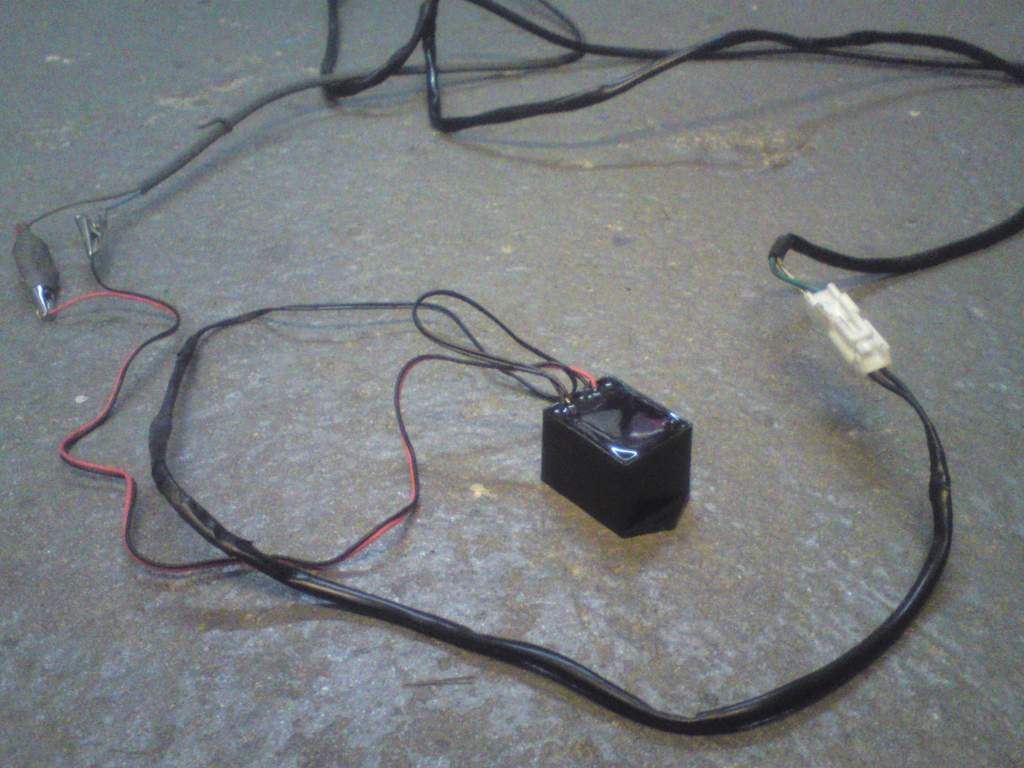

And the invertor end, one invertor powers both as per factory fit, hence the long loom. Just connects where you see the clips to sidelight circuit.

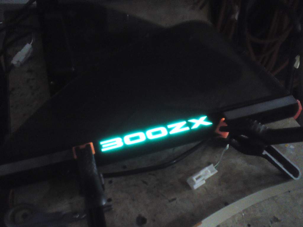

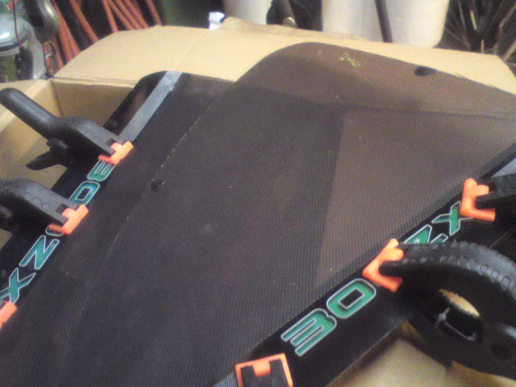

I then stuck them back on the shades, double sided sticky was used initially all those years ago, i left this in place and just applied a tiny careful amount of black silicone to help further secure, all incredibly tidy as you can see below.
For the time being these are lightly clamped but you get a glimpse of what they're like
When not plugged in these are green :thumbup:.

I've offered these in my swb and they're quite large so i conclude these are for the 'other' version for sure !!
I guess though they'd be nothing to stop you dremel cutting the plastic down in an equal fashion :scared: and then just scissor trim the black mesh tint that's on them.

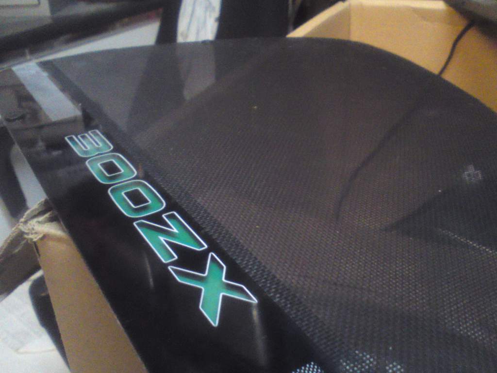

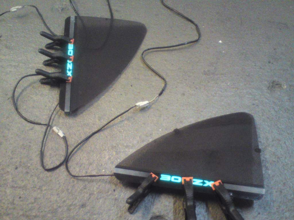

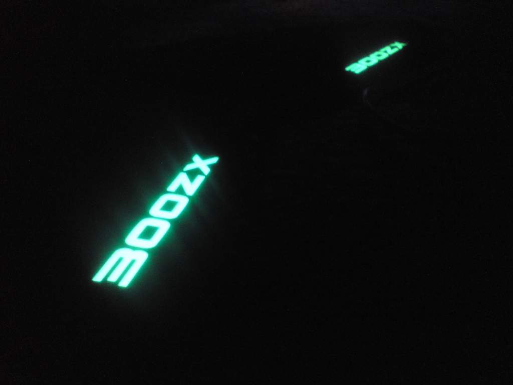

Some final pics before i packed, as mentioned before green also when off, this matches what was done on the op's rear garnish panel.
Simulating night time
I cannot get the true colour to show on a pic but i assure you these are traffic light green - nice things and i must admit a tad jealous :thumbup1:.

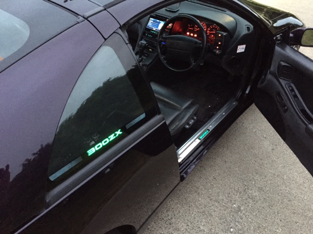

All fitted and working :-)
[ATTACH=CONFIG]97565[/ATTACH]
[ATTACH=CONFIG]97566[/ATTACH]
[ATTACH=CONFIG]97567[/ATTACH]
Shades, sills and panel :-)
Looking good mate :thumbup1:
