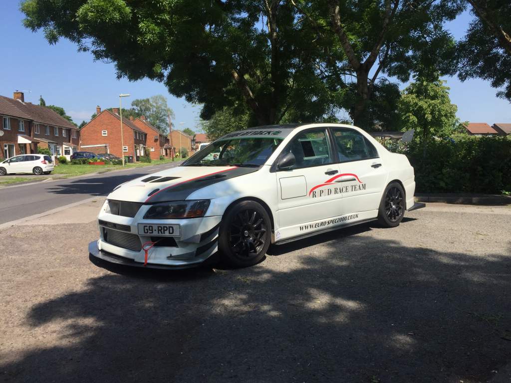

As Pete has been giving me an ear bashing I thought I had better post a few pix of the rebuild.
I did a fair bit of testing during 2015 and competed in quite a few events despite having a cracked and / or porous block. This left me low on power but I hope to have sorted out suspension and a few other issues that should help to make the car a lot faster.
Looks like a lot to do still and there is however I hope to be back on the track and testing in time for the new season. I plan to do more in the way of sprinting and hill climbing but of course ten of the best remains the primary event for me. Probably do Brands Hatch in time attack in club pro.
The main aim in the rebuild is to move weight to the back as far as possible. In addition I will be trying a few new ideas and I will add a few more photos as I get them over the next couple of months.

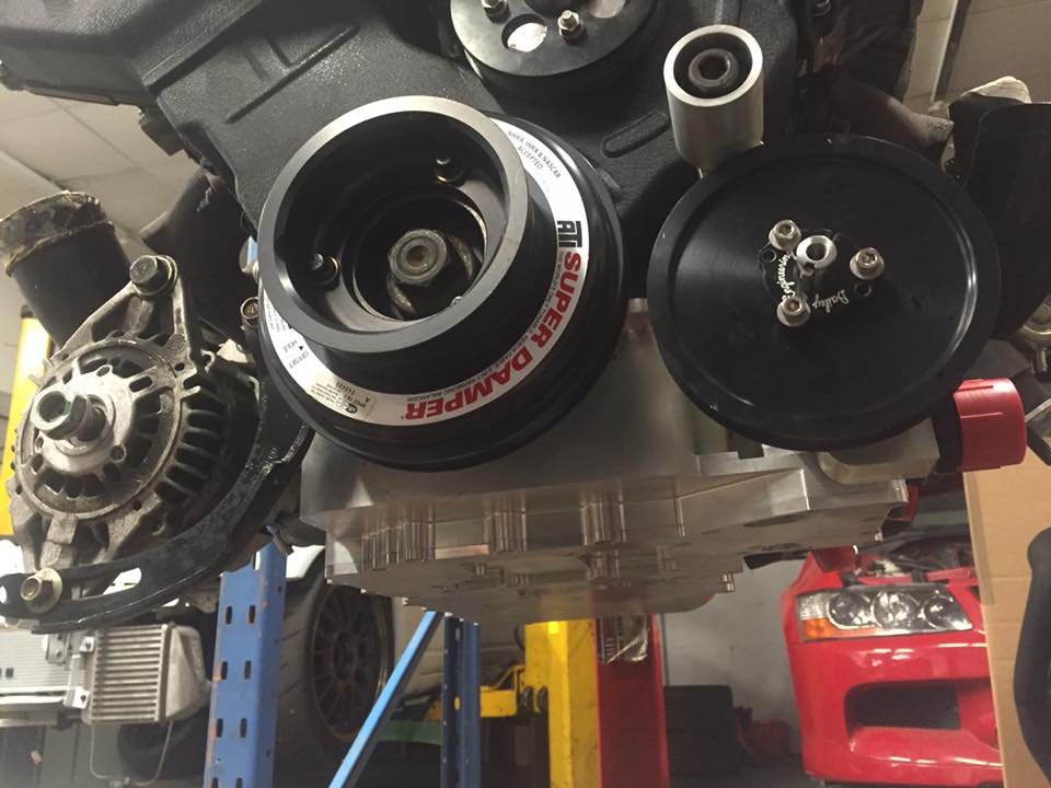

Just awaiting the lines and then into the car. Dry sump fitted with pump and superdamper looking good.
whats the pros and cons of the damper ?
They are built for high performance engines generally a quality build with quality components. It's a harmonic to reduce vibration pretty much at all RPM. For me though the biggest advantage is the reliability as this is what will be running my oil pump can't afford it to fail :)

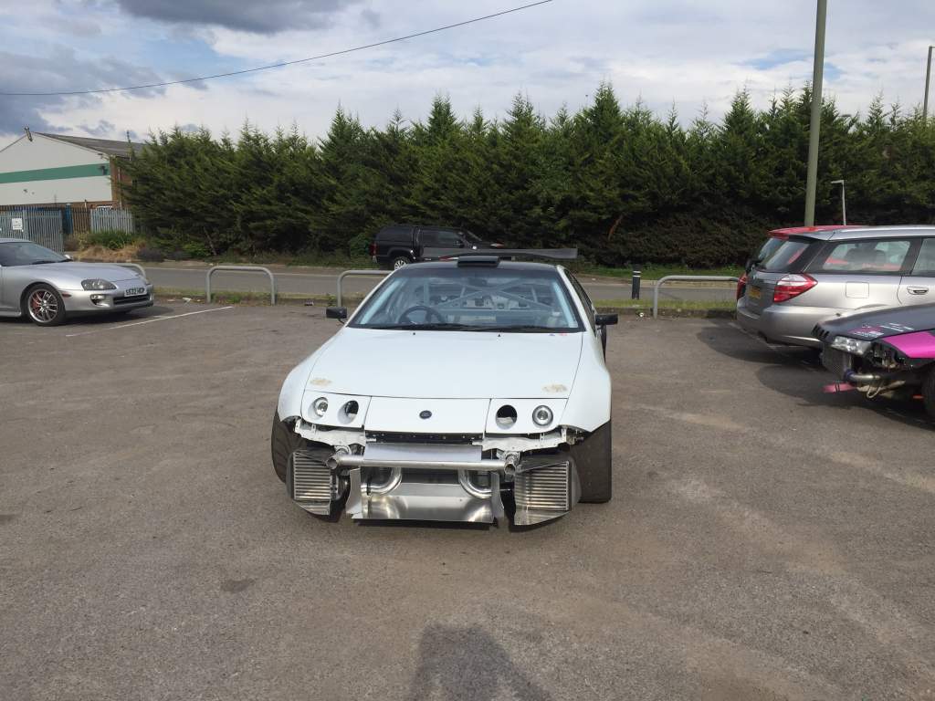

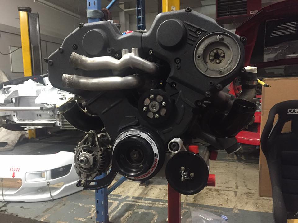

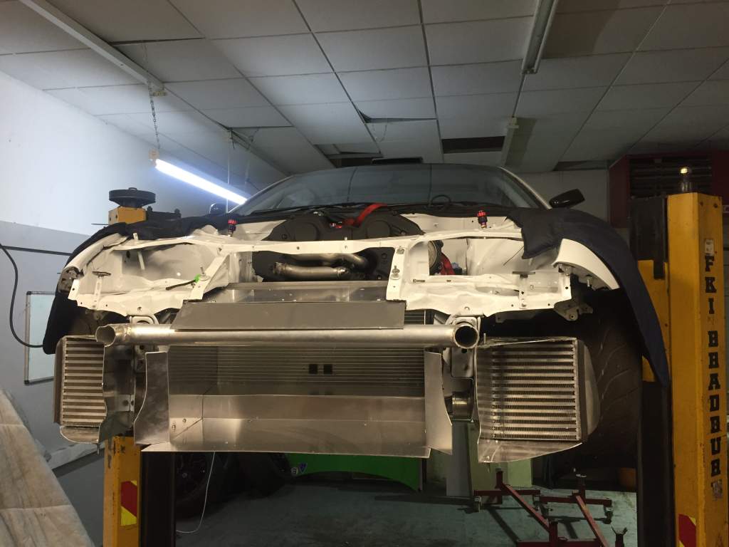

Engine is in but one of the scavenger pipes fouls so some thinking to do. Now the front end is much more efficient at cooling and looks great methinks.

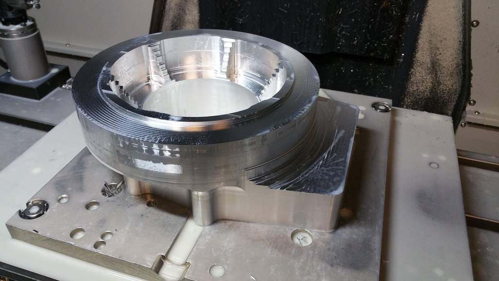

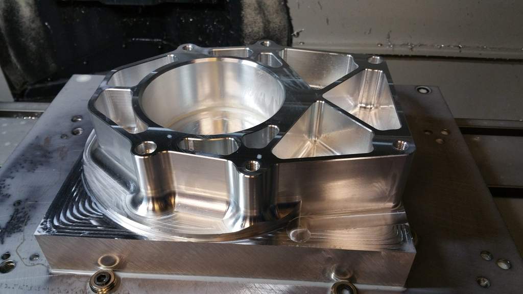

The adapter plate cost about £1K

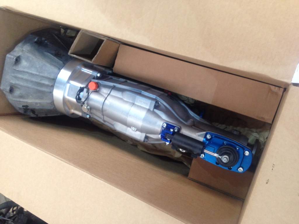

thats not bad is it. what did you box its self cost and what ratios are in it vs the stock box ?
never talk money my missus would kill me if she knew :) it's a 'lot' of money! I don't know the ratios as they are custom. I am still using my Richmond gears and asked Quaife to maintain the first gear as is on my PPG dogbox so that my drag starts will still be similar to what I'm used to. Then I asked that top speed was 217mph so sixth is set for that. All other gears are equally spaced though due to the high top speed they are pretty long but I'm sure I will cope with that.

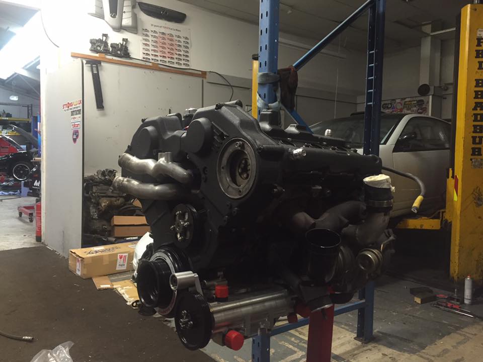

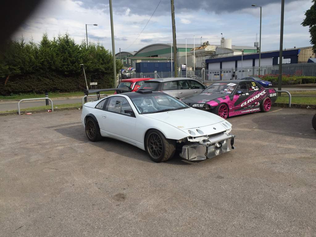

Unfortunately the zed will not be ready for TOTB. As this deadline can't be met I am going to give my wallet a rest for a little and let it recuperate. In the meantime here are a couple of pix and I think they show we are going to the next level. I think it will be worth the wait. I will pop a couple of engine shots later when I get it off the trailer.
