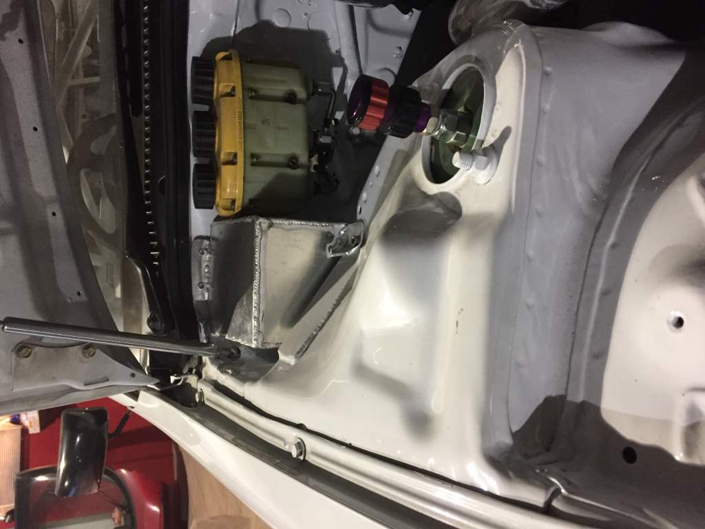

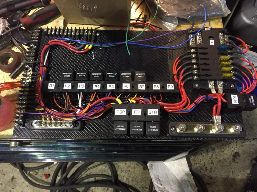

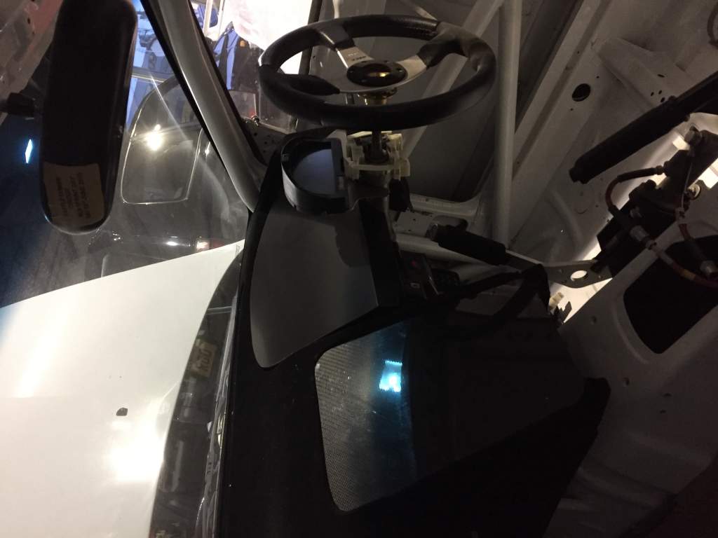

The work continues with a modular fuseboard will help with future expansion potentially. The dash is coming together as is the engine bay. We are awaiting some custom clutch plates and will be ready for a first test.

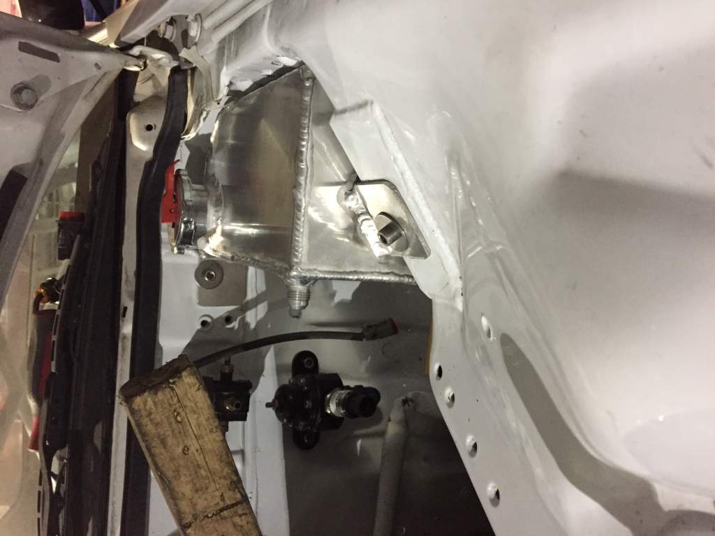

New ST-60 brakes at the front with a pair of ST-40 being modified to go rear. Full bespoke wiring now assembled and being installed into the car. We have the final dry sump fittings so these will be installed within the next week or so and we will hopefully be firing it up.
