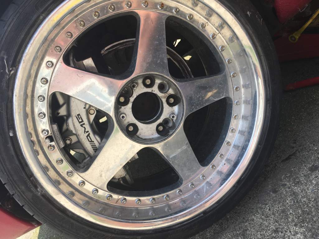

Hmmm:shifty:
[ATTACH=CONFIG]111705[/ATTACH]
Should I go fully polished or leave as is :innocent:
Very nice, they look perfect for a wide arch. :tongue_smilie:
They already look fully polished TBH!
ne
They are fully polished Howard, my buddy did these, thinking of talking him into doing similar with mine :innocent:
I’ll have to talk him round as he says he’s given up doing wheels:whistling:
Hmmm:shifty:
They're horrible - i don't like them at all and would never put anything like that on my own pride and joy :tongue_smilie:.

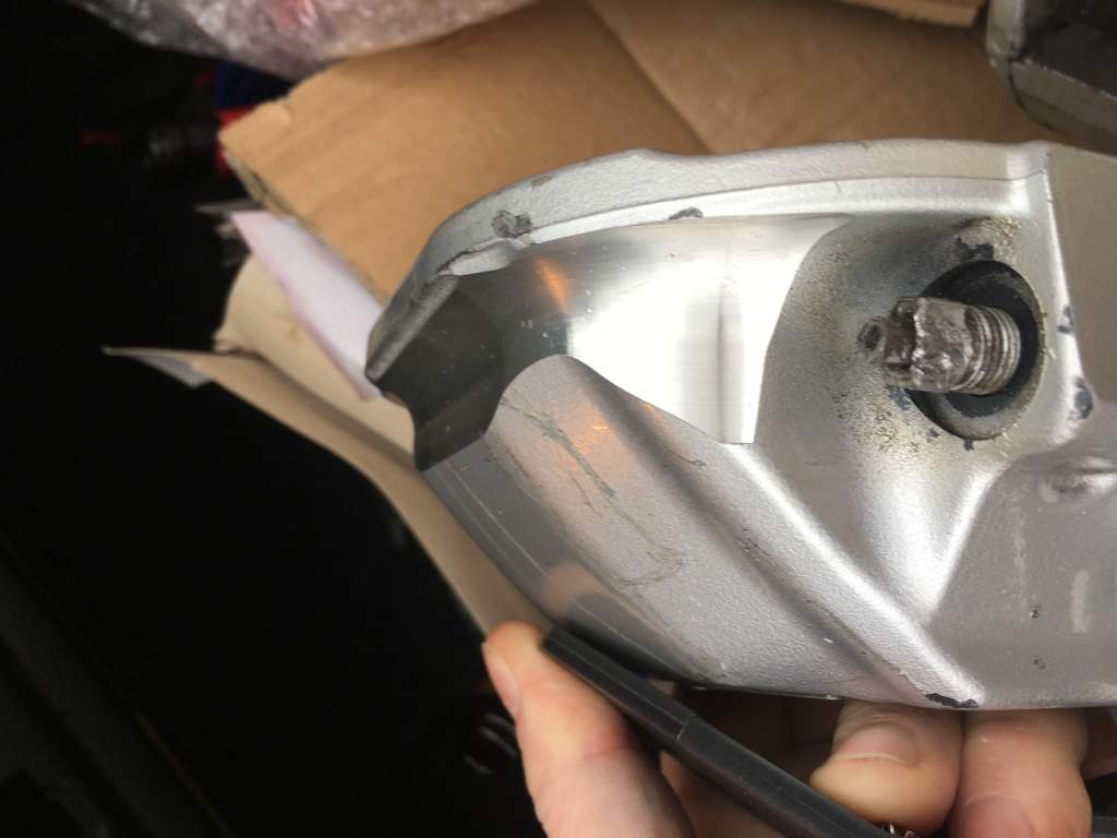

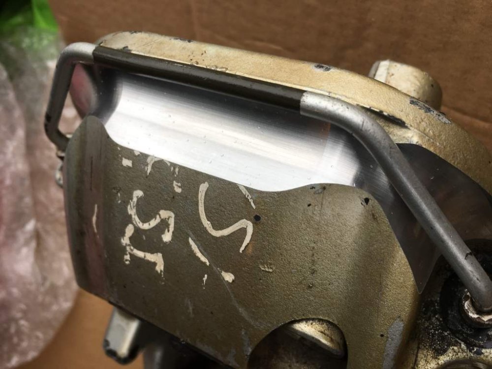

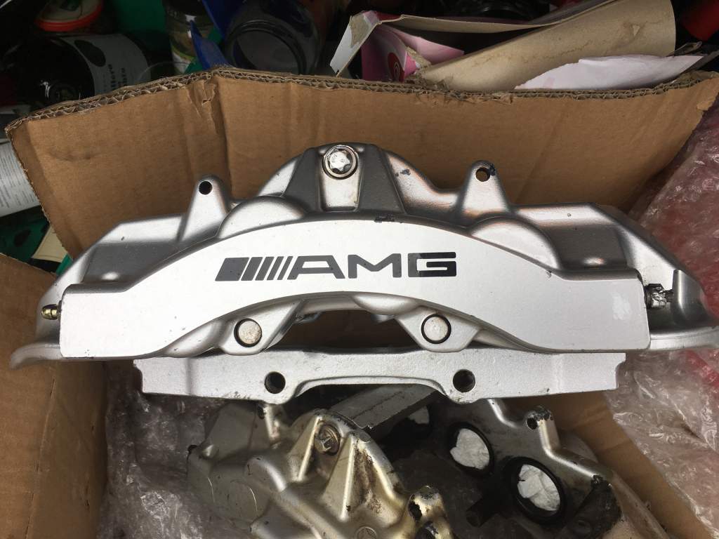

Called over to the machine shop and picked up my AMG calipers :thumbup:
Bottom of calipers machined to take the crossover tubes :punk:
Now just need to sort out adapter brackets, new crossover tubes, powdercoat and rebuild to fit to the blue Z in June :thumbup1:

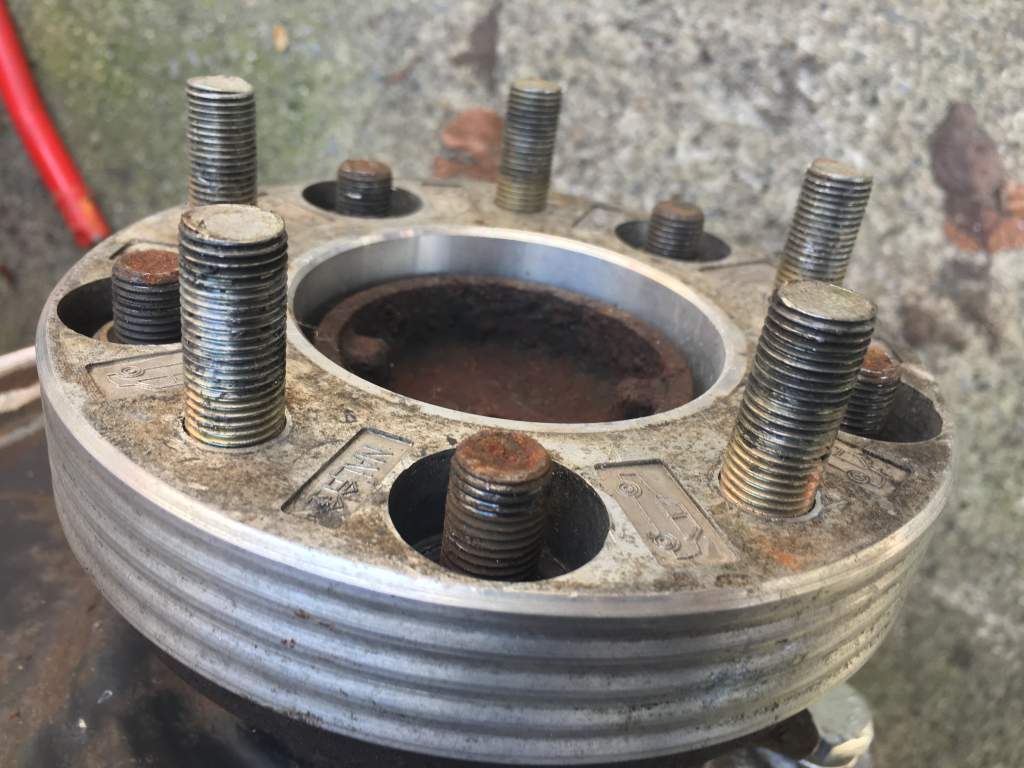

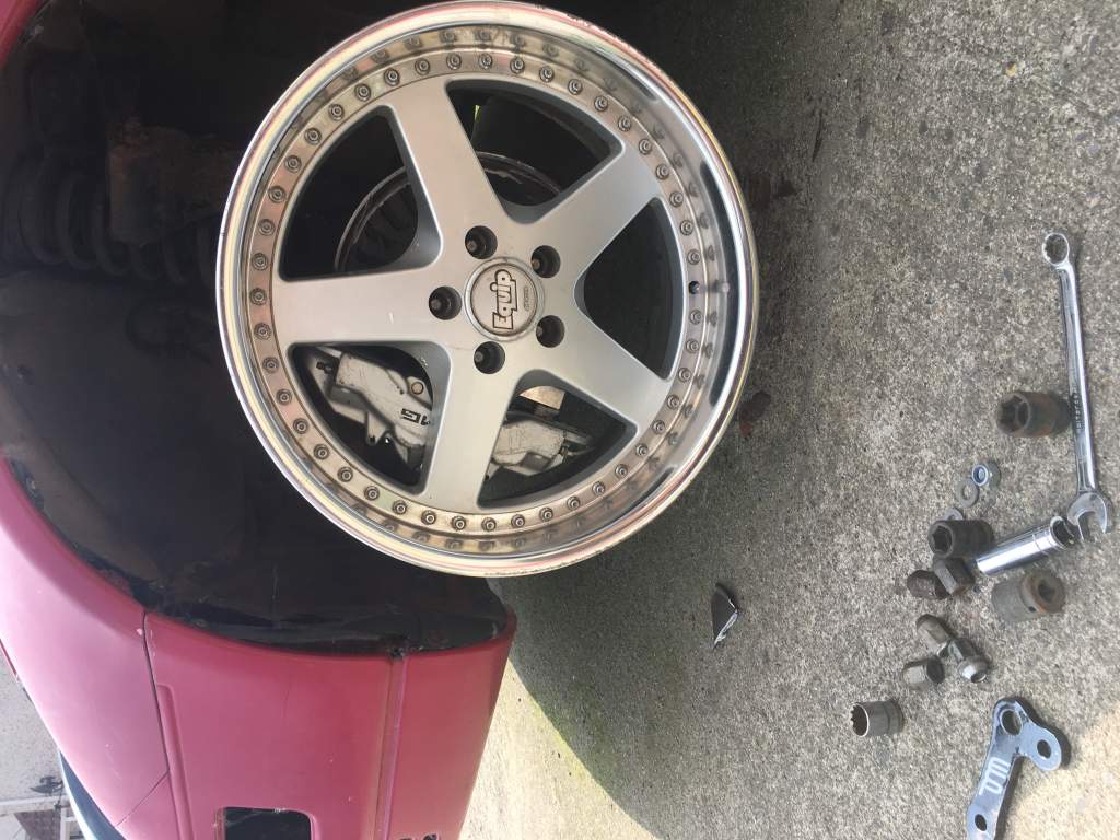

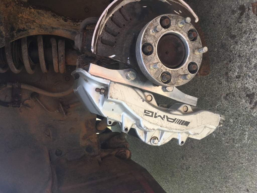

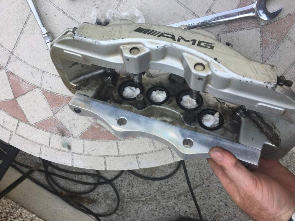

So, it was too hot to stay cutting down trees, took a break at lunchtime and said I’d revisit my AMG calipers, removed the original Merc bracket and installed my new one, I’ve hit a couple of problems,
1. My hubcentric spacers leave me with the studs protruding??
2. I’ve a “Good News” and “Bad News” scenario with my wheels...

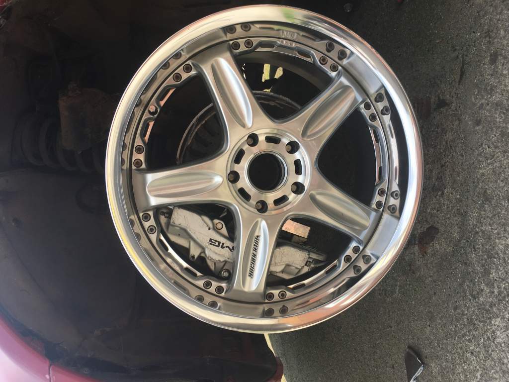

The “Good News” is that these 8 pot AMG’s fit inside an 18” wheel, the “Bad News” is that the spoke design on both my 19” Work Equips and my 18” Veilside Andrew’s means I’m going to have to push them out further than the 25mm spacers:thumbdown:
The other “Good News” is that the spoke design of my Volk GT-C’s is perfect both using the 9” and the 8” wheels, so “Food for thought” there:thumbup1:
Anyone any reasonable solutions?? I’m assuming I can just get shorter studs for these 25mm spacers and if I’m going out 30-40mm for the flat spoke wheels it shouldn’t be and issue?
Anyway, here’s a few pics ...
Some wheels have an opening in the rear face of the hub between each bolt hole so the protruding thread might not be an issue depending on your wheel design.
Spacing the wheel further and further out will change the scrub radius quite a bit which will affect steering ability.
Yes and my work equips have them, just as well as i have 15mm hubcentrics on the front, thought with a 25mm spacer you wouldn't have anything proud of the face ?
Let me know when you find a supplier for the rings Rich :flowers:
[ATTACH=CONFIG]112590[/ATTACH]
Once he puts the disc on he won’t. The spacer is sitting directly on the hub which leaves extra protrusion of the stud.

Where does the spoke interfere? The caliper face?
Can’t be too hard to find the rings?? Anyone any ideas, think the Nissan is a 66.1?? Maybe eBay?? I’ll do some investigating tomorrow :thumbup:
Yeah Stephen, thanks to yourself and Andrew for mentioning the brake disc, I think I was suffering from heat exhaustion felling trees in that heat. Im fecking knackered, back to the day job tomorrow, so can do some research:thumbup1:
Had another good think about my wheel fitments and as Stephen and Andrew have said, I'd no brake discs on the car, once these are fitted my hubcentric spacer will be sitting flush with the studs, this means my spacer will be out to the correct 25mm and those extra few mils will mean my spokes should clear the caliper face :thumbup: Problem solved:thumbup:
