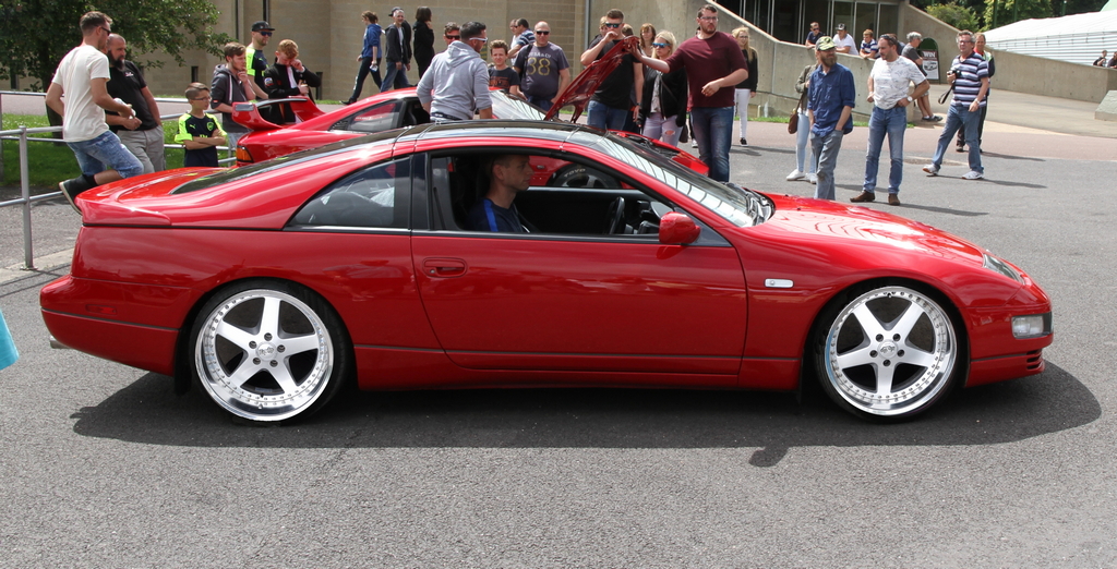

17" Work Equip 05 3 Piece Split Rims, polished rims with Light Shadow Chrome centers, refurbed Oct '16.
Fronts 8J +30 offset can bolt straight on but I have them fit with 15mm hubcentric Eibach spacers, tyres are 235/40/17.
Rears 9J +28 offset bolt straight on, tyres are 255/40/17.

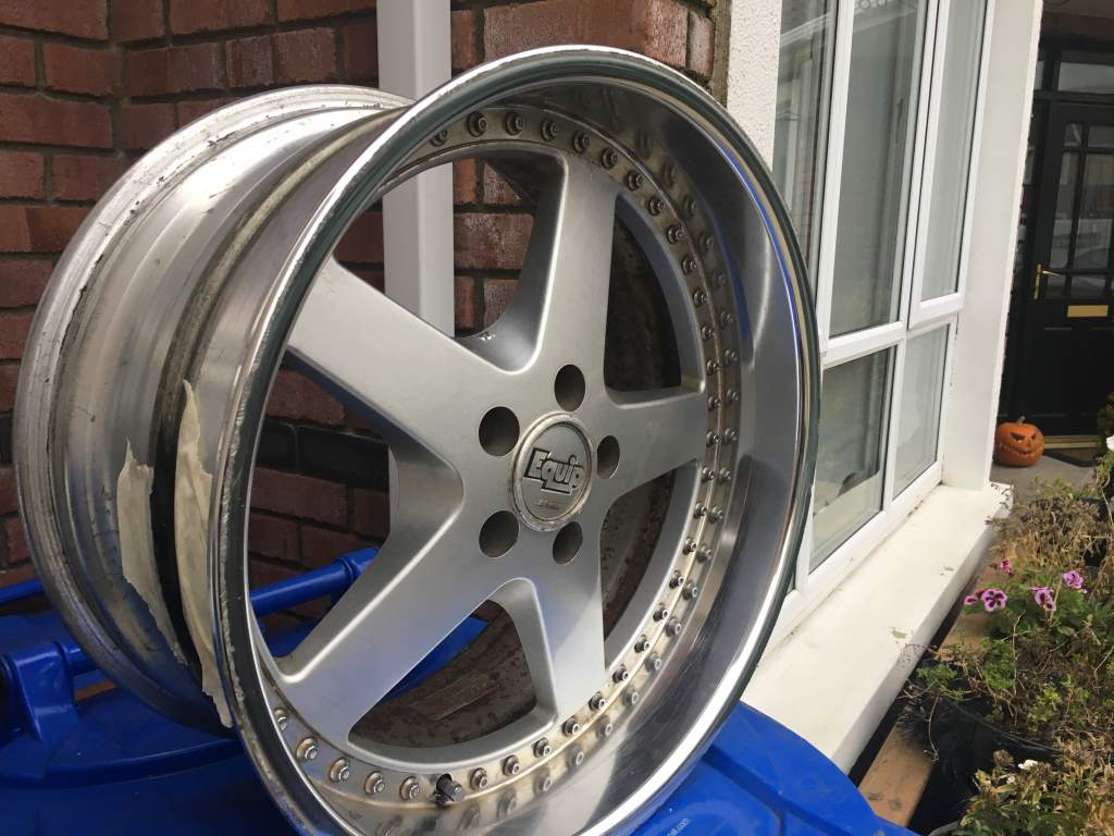

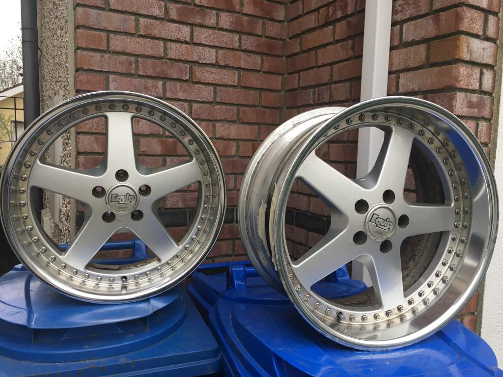

Got two of my Equips today:clap: one front , one rear:biggrin:
Hopefully have the car down to Bristol in the coming weeks:yes:

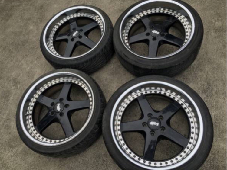

I stumbled across them when talking to a guy who knew a guy. Have found another set in 19”, black centers though, 8.5” & 9.5” x 19”, offsets are a bit off :whistling: though. Et 26 front and et 14 rear, mega expensive but I told him to fire them onto my account for the minute until I decide whether they’re worth something to someone :whistling::lol:
Could be refurbished and polished or repainted and swap out a lip or barrel to get the desired offset
