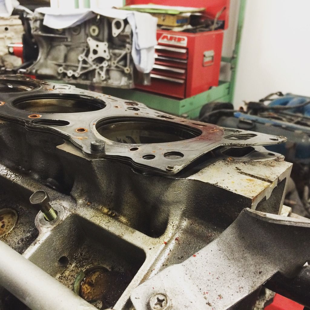

I do plan to use the engine myself and fully dismantle it to see what actually happened.
Not being technically minded i'm thinking this is a head gasket failure or could it be something else ?

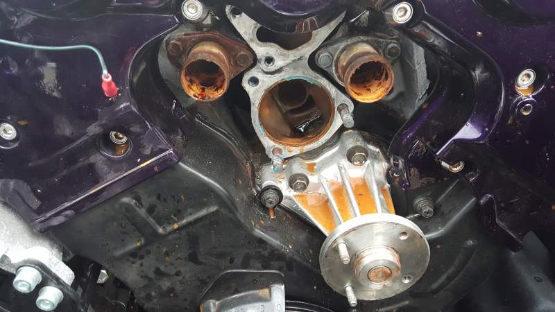

When I broke down the water temp was sitting around 80 which is normal.
And the oil pressure went to nearly 5 psi in just under 5 minutes followed by a stall.
Can water pass to the lower plenum via a faulty water pump ?
As just a month before the incident happened we had what we thought was a crank knock but after stripping the belts
we quickly came to the conclusion it wasn't that.
If the noise was the water pump and it just somehow failed a gasket or something ?
Can't check levels of the rad or other areas until tomorrow now but i'm sure it must be something dumb hopefully not as dumb as me putting a water pipe on a vac hose, :)
Hopefully nothing major, are you using oversized pistons? Could be a cracked block
our apprentice did that too his car, somehow connected the washer hose to a vacuum, still hasn't lived it down.
Most likely a failed head gasket, water and oil jacket mixing. Was the coolant normal?
That's a HUGE amount of water for a blown HG!
I'd second the theory of a cracked block.
Shitty news for you fella
Don't forget it's been sat, it may have been gently filling the sump up.
Mine was sat for two years with a head gasket this badly warped, had a TINY bit of emulsified oil in the block, certainly not two litres!
In truth until you split that block its guess work.... I've seen cars still running with a sump that's like brown milkshake. Every case is different, size, placement etc. Interested to see what's happened though. I recon there will likely be further damage than simply a blown gasket if I'm right though.
I wonder why it did that specifically. Was the head warped as well?
Mine blew due to det. Nope, head was a straight as a straight thing. Sod knows how!
And it took 112c water temp and 120c oil temp to do that.
For such a drop in oil pressure, you'd be looking for a failed oil pump, a significant oil leak, or an internal failure of an oil way.
