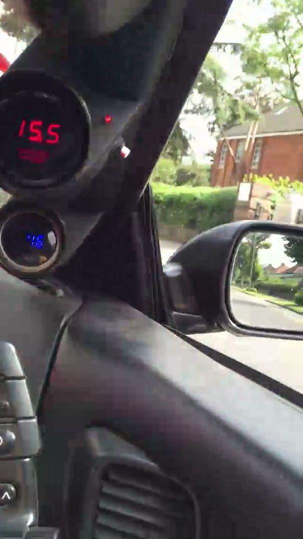

Not only is the manifold/downpipe leaking making it sound like a tractor now there's a squealing noise on full boost at 20psi but no noise at 16-17psi. Any ideas. I've added a video in second gear full throttle at 20psi.

I couldn't hear much either. If you keep hitting 20psi in second gear outside a school though your gonna get pinched.
Oh sh1t your right, not very responsible at all. Delete delete.....I can hear the noise in this vid. It's a kinda high pitched pulse noise. Can't believe you can't hear it it's really obvious to me. Listen again. It's not a whistle or whine but like a child screaming.

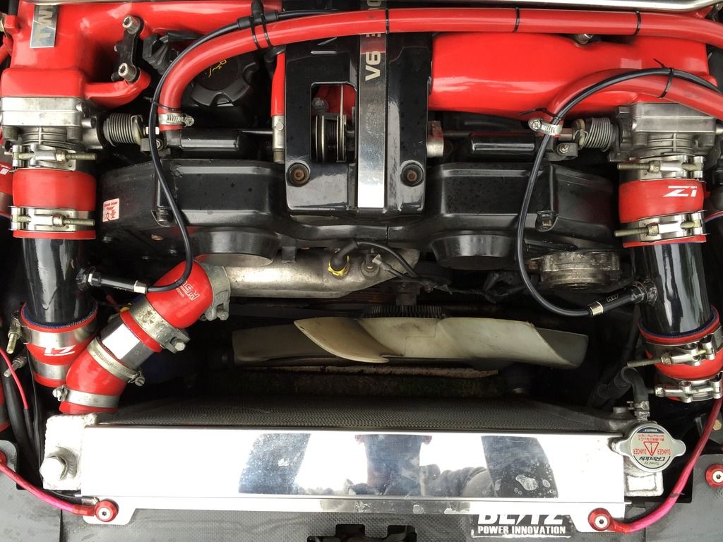

Correct, but now that I've listened to it so much and it's gotten worse it's actually coming from nearer the back of the engine where the downpipe is. I'm betting it's my z1 downpipe that's cracked would explain it getting worse especially after I've just had the rest of the exhaust fabricated it could have added extra tension/weight and spread the crack. Problem is I can't see the crack coz it rapped in fibre glass. Fingers crossed. Will have a go at removing it myself soon. Remember it being such a pita last time I removed the drivers side DP.
Removing an aftermarket down pipe is easy, it's rusted solid stock ones that cause problems. Starter motor off, 3/8" ratchet and a UJ and a ring spanner for the bottom ones it will be off quicker than it took to get the car off the floor.
I hope so mate. I remember having to make a tool to get one of the top ones off, welded 3 old ratchets together at a certain angle lol was madness. Mine are five bolt design so hopefully should come off easy. Defo not rusted so much. I will jump for joy if it's only the downipe that's cracked. Will take it to my boys who made my exhaust they are awesome.
