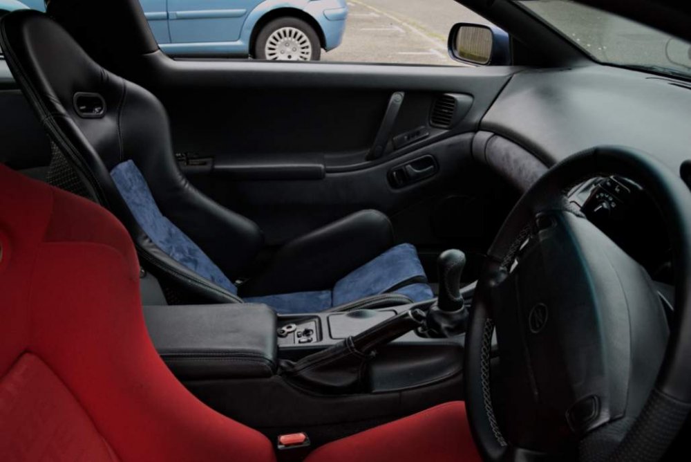

Original Interior:

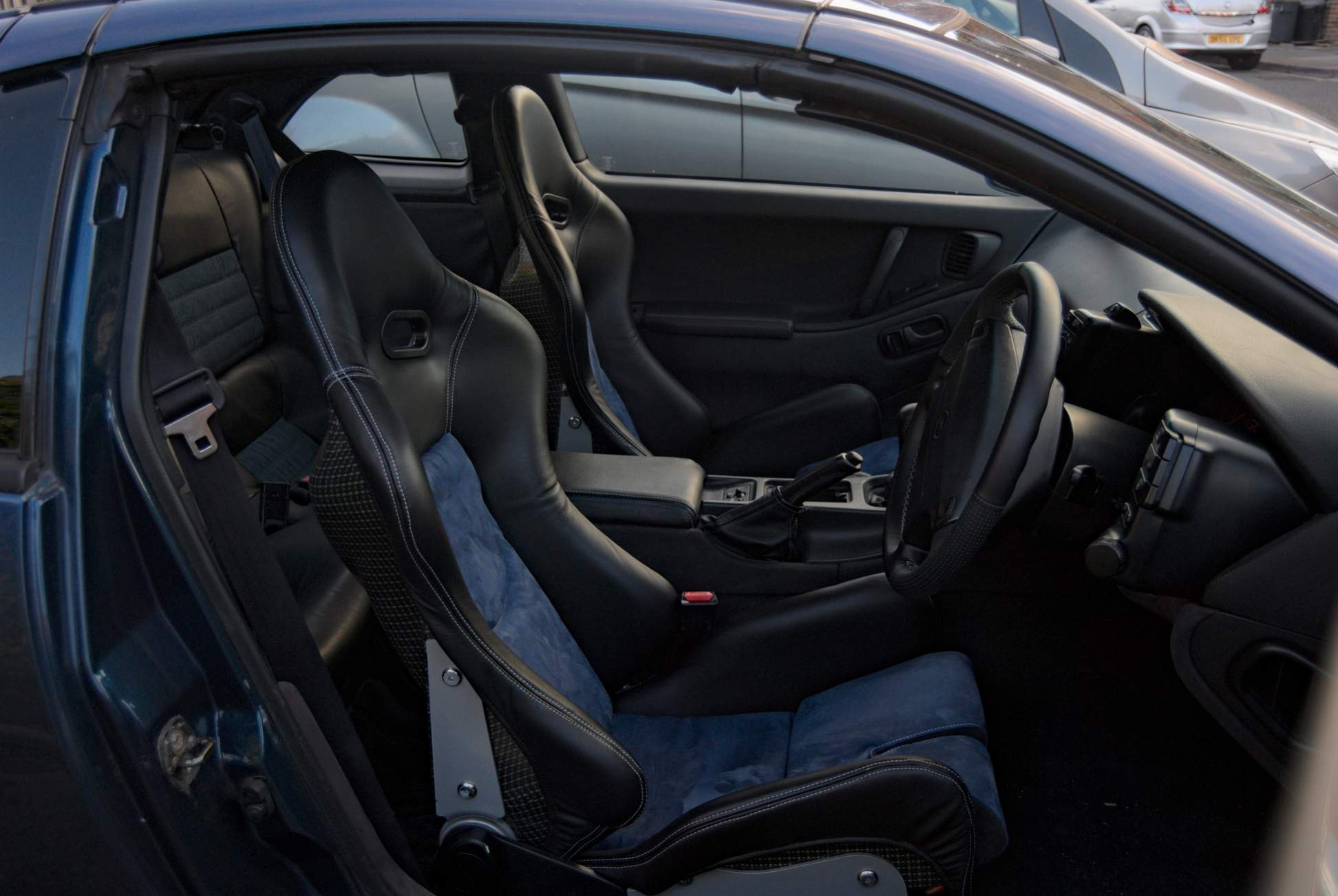

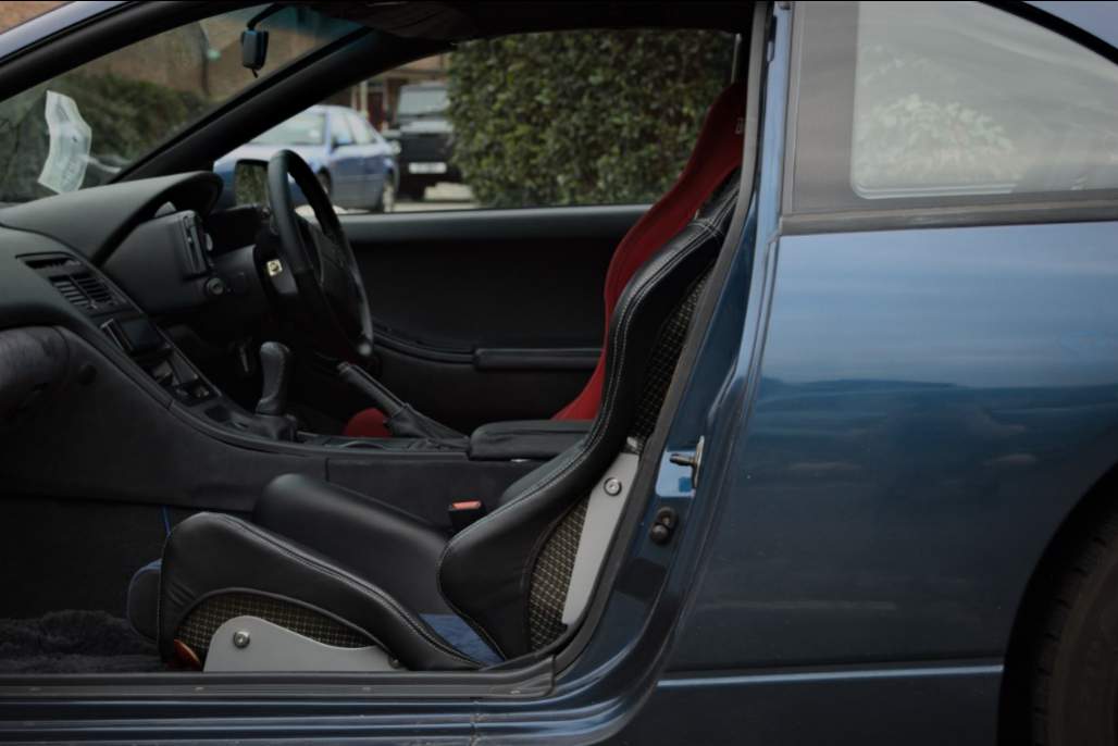

Update - Seats almost complete so only final touches to do. pretty happy with the result. Will make some charcoal alcantara inserts for them at some point too so I can change the colour.

Niiice, can the seats slide on the rails or are they static?

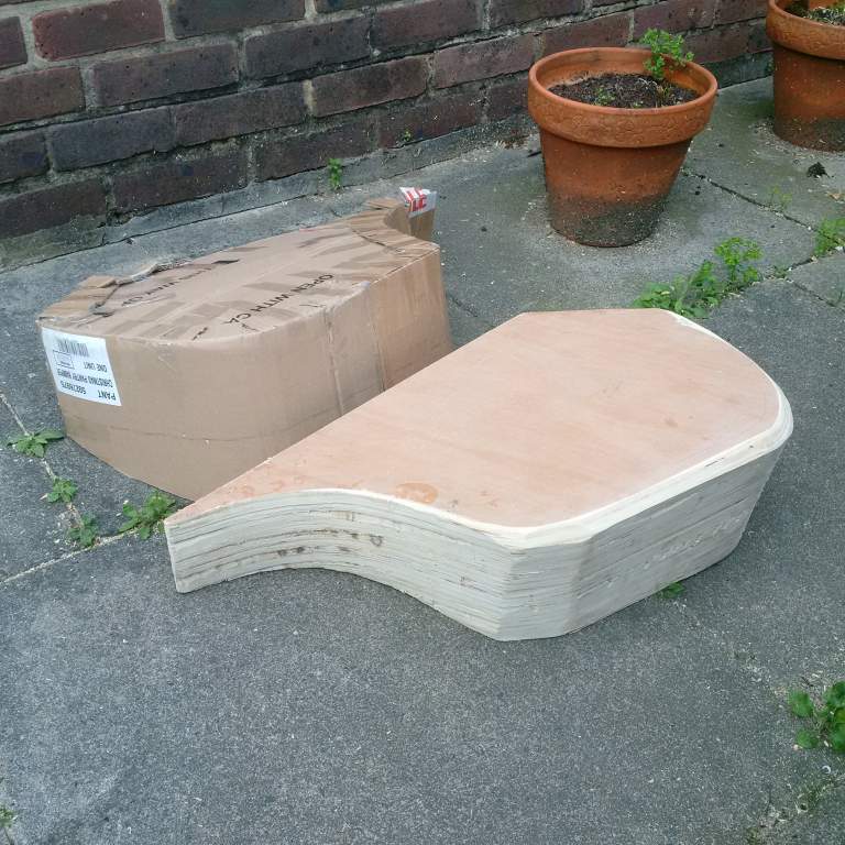

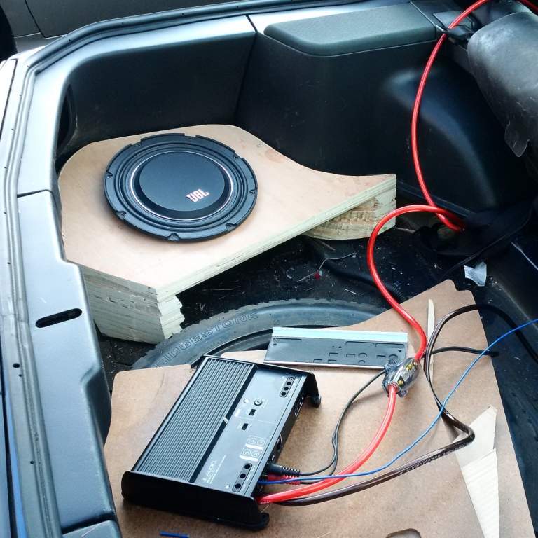

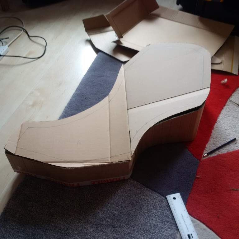

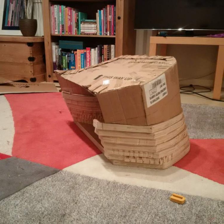

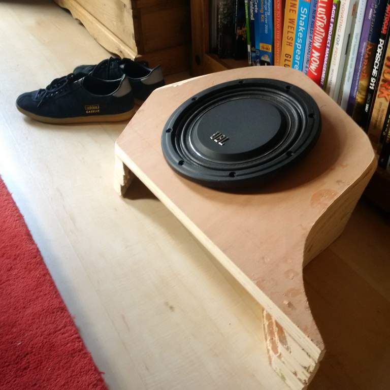

So even without the bottom or side on the sub box it still makes SUCH a difference to the sound! Sounds like a proper sound system. Love it. Not that I ever listen to music as the exhaust note is good enough, but the option is nice.
So now I am wondering whether it needs a bottom to the box or whether I could just fix the top of the box onto the boot floor instead??....

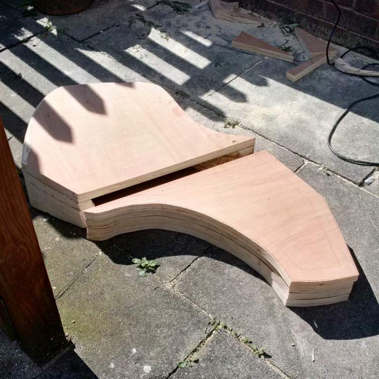

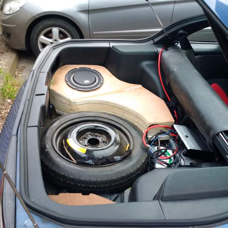

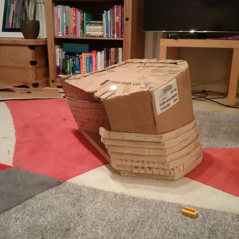

Update time: Sub is sounding amazing! Much much better than I expected. Turned the amp right down and adds the perfect depth to the sound. Doesn't resonate or feedback so you can't tell where the bass is coming from, it just fills the cabin. just roughly cut at the moment so need to sand it and cover it but very happy!! May even make a fiberglass one eventually to save some weight.

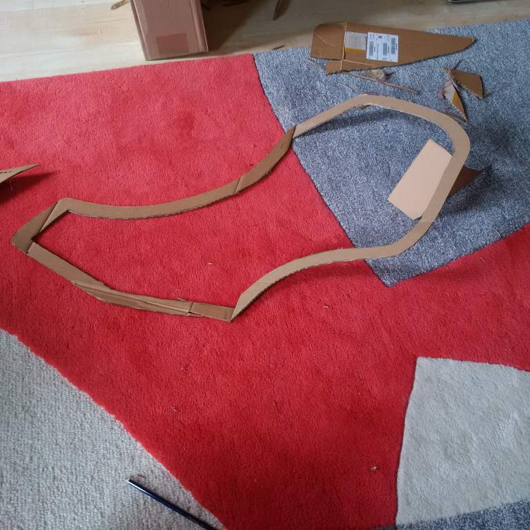

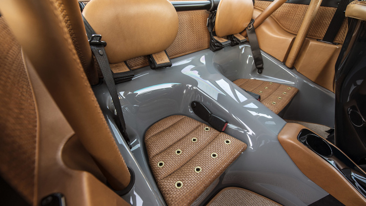

And now I have to decide what to do with the seldom used rear seats. I would like them to match the theme which is reasonably minimalist/sleek with the Carbon kevlar bucket seats and charcoal alcantara. I have been inspired by teh singer porsche rear seats and am going to mock up some designs for building solid seats with alcantara "cushions"... ie.
i think this could be matched with the other carbon work going on in the car, and may work cosmetically due to the seats being composite.
i would look to keep the two piece design as the main advantage of the LWB is it's practicality.

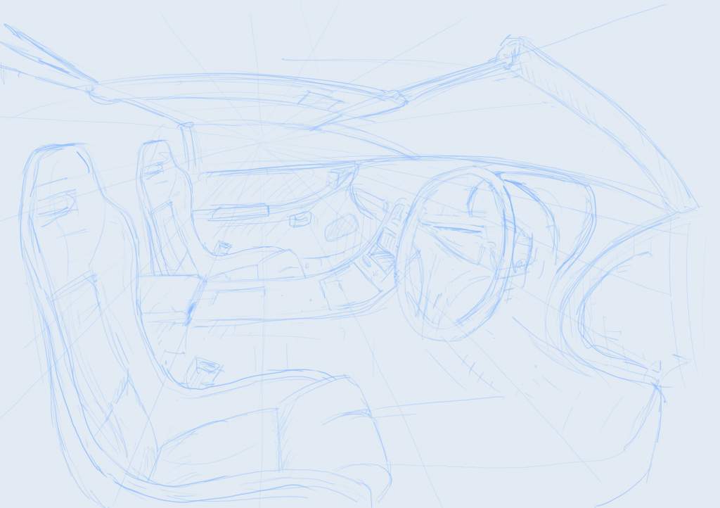

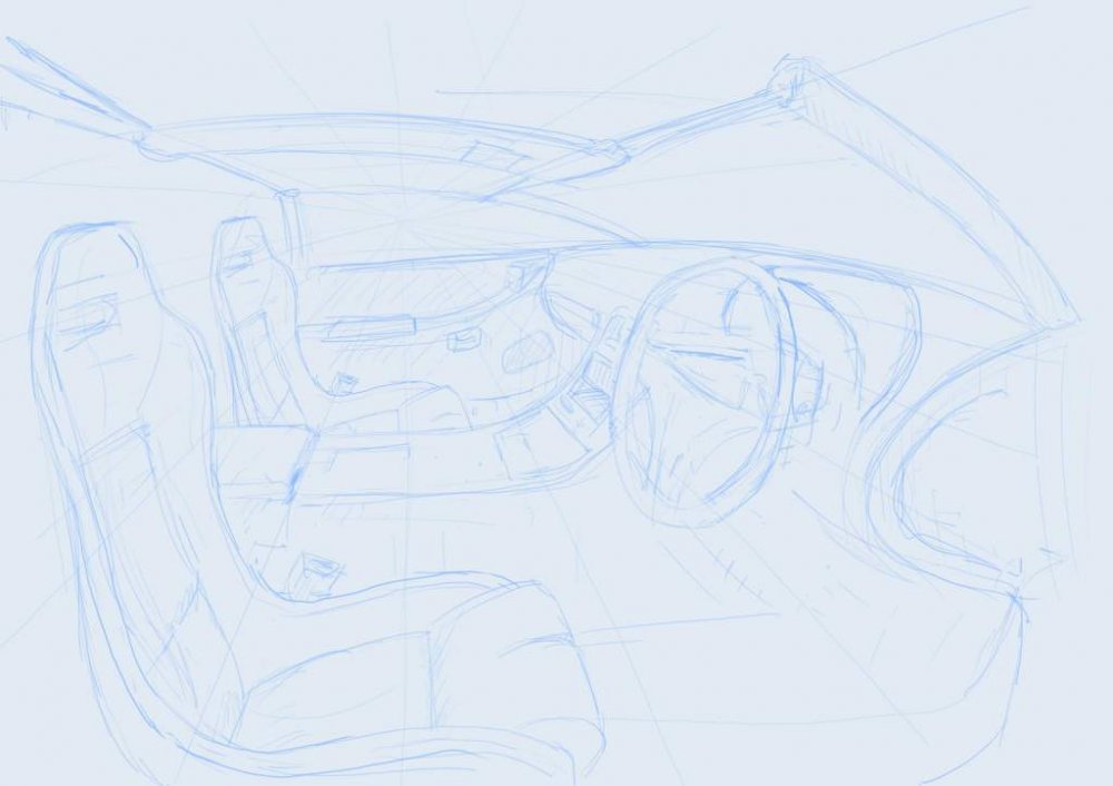

Decided to start practicing up some sketching tonight as I want to render some concepts for the rear bench, here is the first attempt at a rough pencil sketch from memory... more to come hopefully.

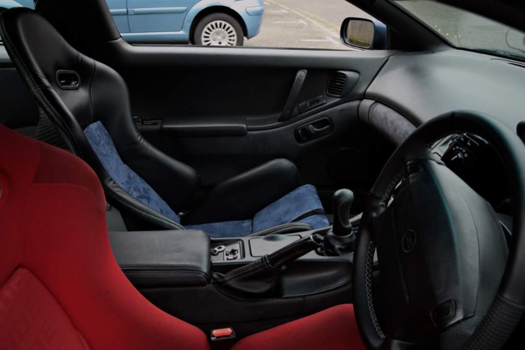

Attempted to cover my drivers door card in Alcantara this evening. Pretty happy with how nice the alcantara is to work with, but I think I might prefer a charcoal rather than this deep black... Will test fit tomorrow and see!
Thoughts??

Oh really that's interesting. I guess I havent done leather panel work yet so this just felt like a nice change from sewing!
The seats have cushion inserts with I am chancing for a black alcantara as the blue has faded as you guessed haha. Dont mind that I have it a go but on to alcantara in a black for those too, but keeping the black leather surround for the seats. Wanted to keep the style really sleek and simple which is why I chose deep black, but I am worried that the pleather on the panels is too faded and dull looking compared to the alcantara :s

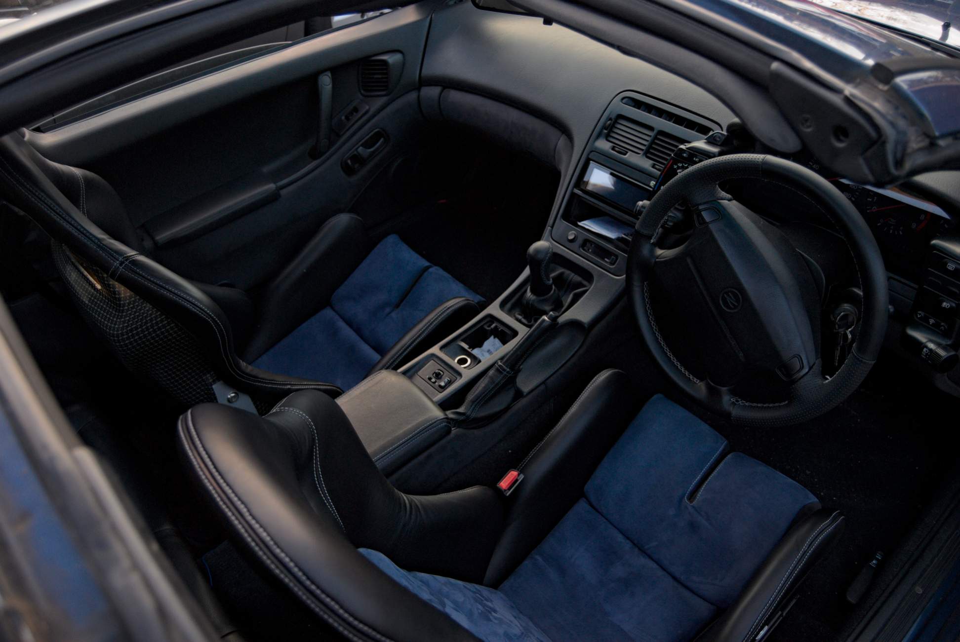

Interior back together and alcantara covered. Going to do the rear panels soon too.
Now I desperately need to get on with those seat cushions

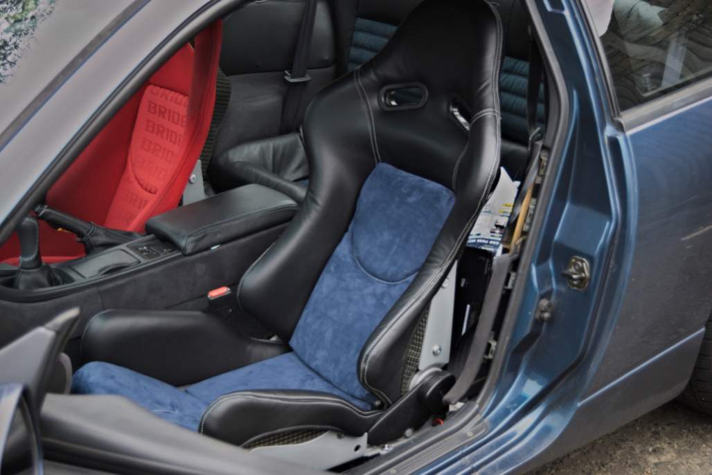

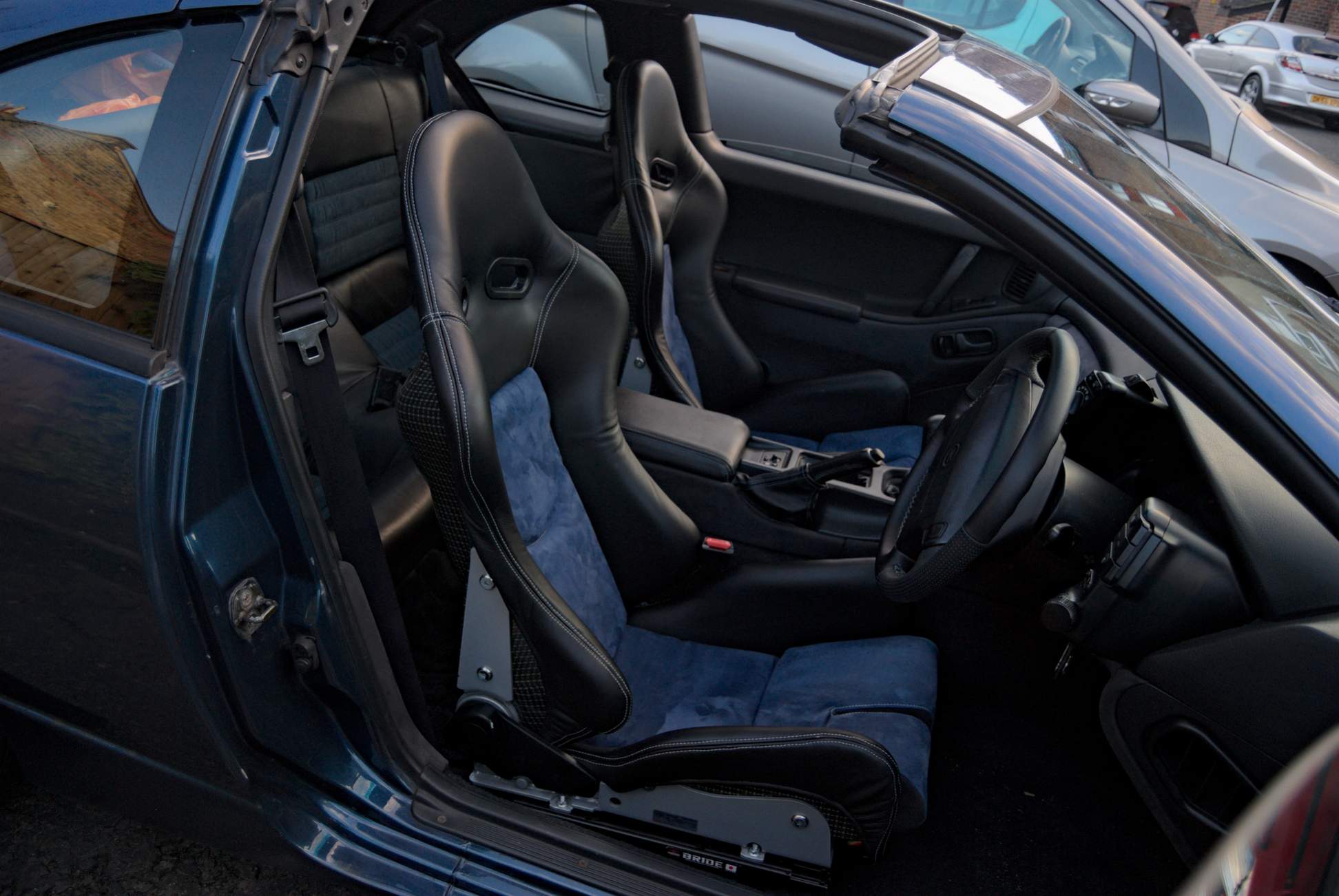

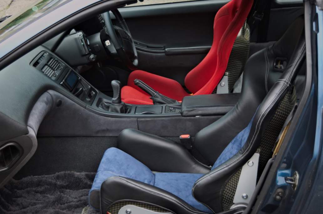

Spent a bit of time finish one of the seats today. Built new cushions which give me he perfect driving position and a lot conifer than the stock bride cushions. Added more lumbar support.
Now just wondering whether to add some sections to the backrest like this:
Nice, but what's with the connector? I'm pretty sure that's the electric seat connector block but its just for the seat belt on your seat?
Thanks Ali. That is the seat belt light. not sure if it is a series 4 thing, but when you have the belt unclipped it will put a light on the dash
Ok, on earlier versions the block is a much smaller thing for the passenger side as it doesn't require power.

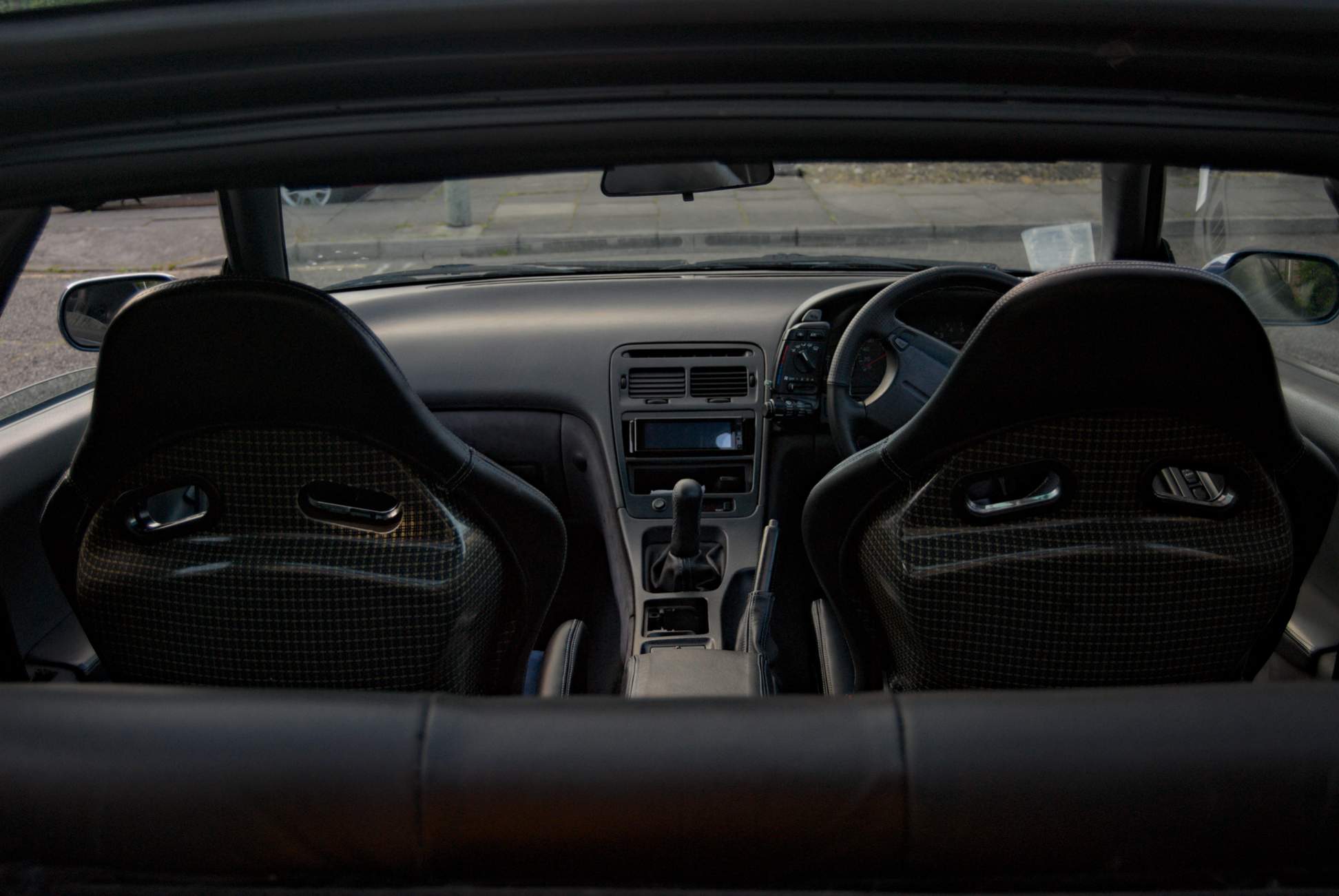

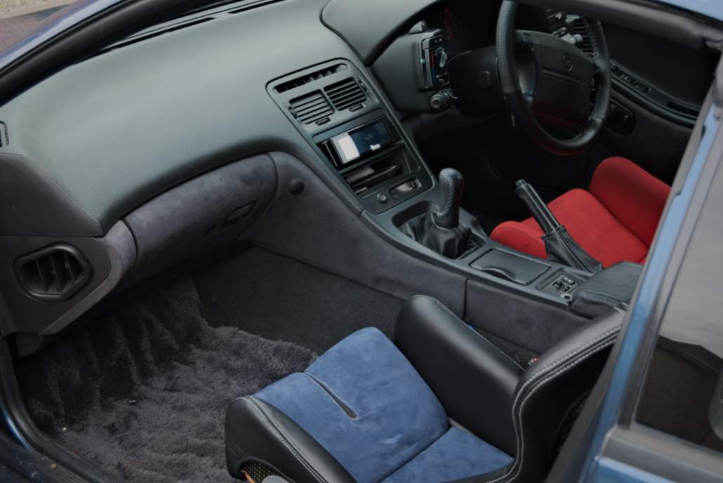

Some good progress today with a new carpet from Ali, and the seats back in. Loving the black on black look!!
