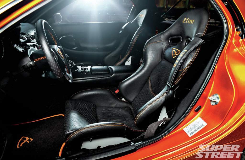

Anyone had experience with the Bride Gias? Seen some pics of them retrimmed in leather for a less aftermarket look and they can look quite flash I think

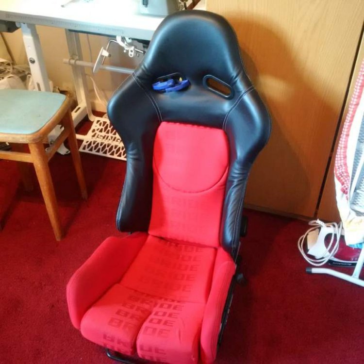

here is the progress this weekend.

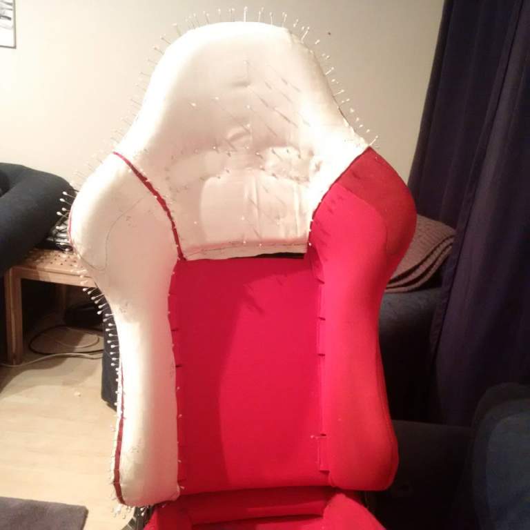

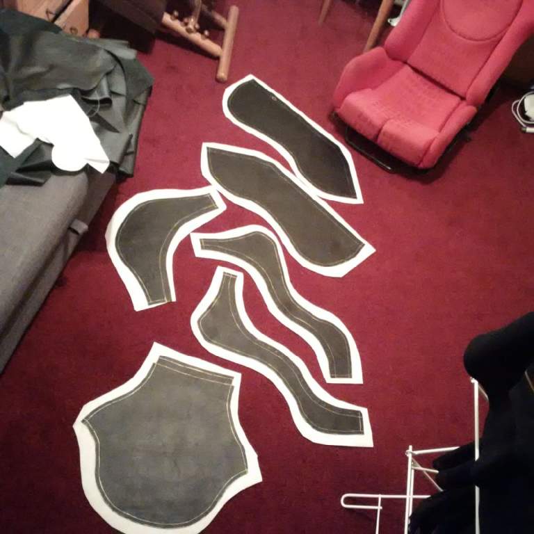

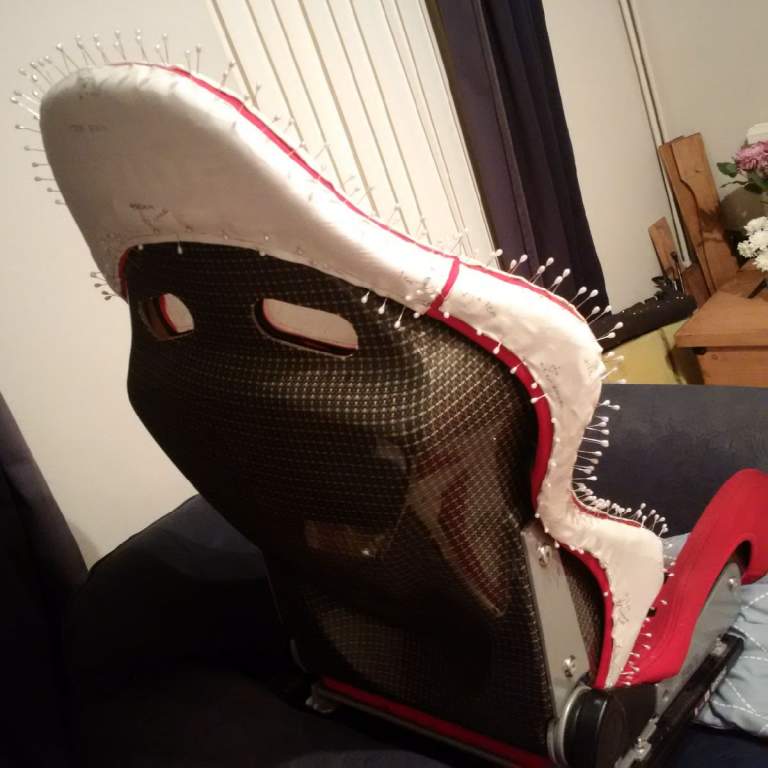

Pattern creation:
This is where I made an error I think. The foam backing I used doesnt have any give in the material, so this prevented the leather from stretching easily during the fitting stage. Next seat will be using a softer foam backing.

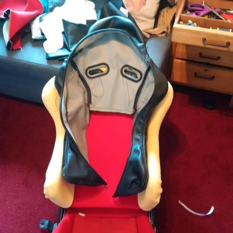

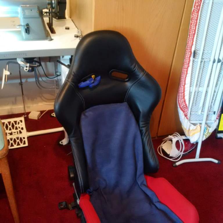

Will it ft?!

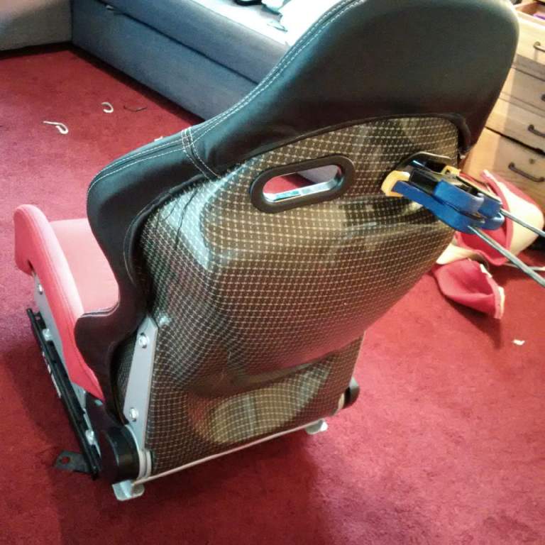

Unfortunately the clips on the seat belt holes snapped so I will hav to find a way to fix those. For now they are clamped :)

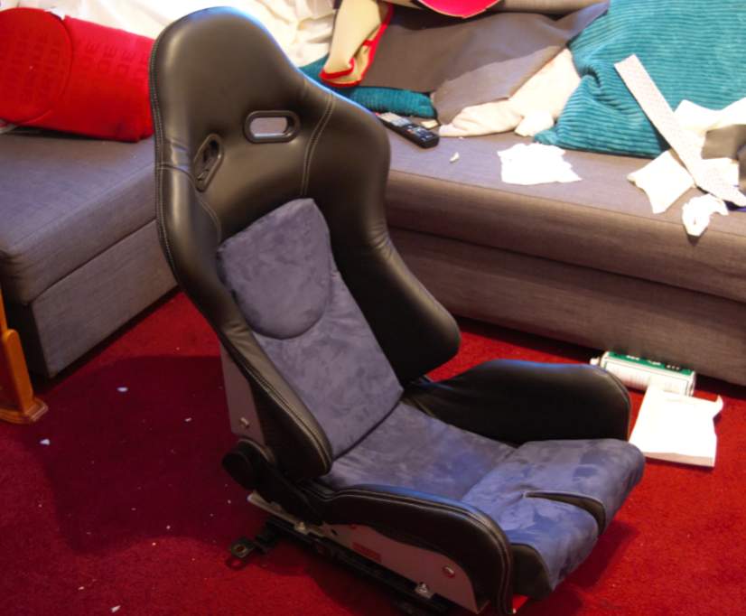

This was the first test fit. I havn't put on the velcro fasteners which will hold the cover tight yet, and there are a couple of areas on the bolsters where I will add a little extra foam to prevent the pulling that is happening at the moment, probably as a result of the lining not allowing much stretch.

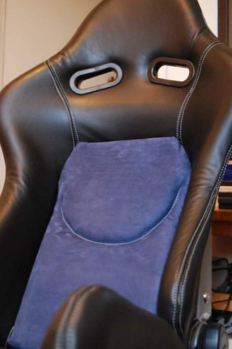

This is the blue that will be used on the inserts...
First and foremost, you shouldn't be making your patterns with the original cover still attached to the seat! That will just give you false measurements! The seat should always be stripped down to the bare foam before any kind of patterning is done.
The scrim foam you've used to back the leather should have sufficient "give" for this. The scrim backing itself just adds a tiny bit of stiffness to the panel, but there shouldn't be any issues with it preventing the leather from stretching enough.
The wrinkles are most likely due to either the pattern being slightly wrong (due perhaps to being made whilst the original cover was fitted) or because the fitting side of it isn't quite right. Might be worth removing it all and refitting it to see if those sections smooth themselves out, William. Padding the structure out with more foam will give you a slightly uneven look, unless you cover the entire seat in an additional layer!
As for the harness slots; they're not actually supposed to be removed. You have to cut the new cover once it's fitted and then tuck everything in uniformly behind the slot covers, assisted by either double-sided tape or a little bit of glue here and there.
As I said before, this is a very ambitious project for your second stab at retrimming! I did a pair of Cobra Misanos a few years back, which are a similar sort of layout and design, and they were a serious pain....

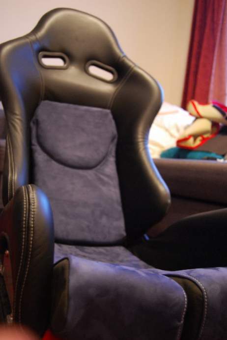

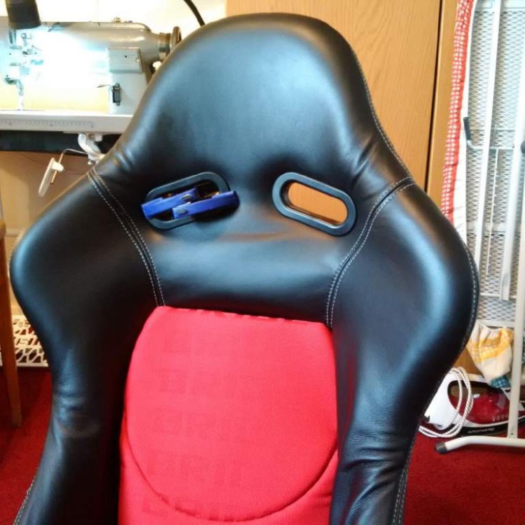

some progress today :) Just need to fasten a few areas and this seat should be complete! Beauty of these seats is that I can put any colour in the middle and not require a complete retrim, so i may do a black alcantara insert set as well at some point to match the black alcantara going in the interior dash and door cards.
Sorry I can't help it but it looks like a really happy face :laughing:
haha yeah it does, not so noticabble in the flesh :p not 100% happy with the back panel, but haven't worked out what design would improve it yet.
