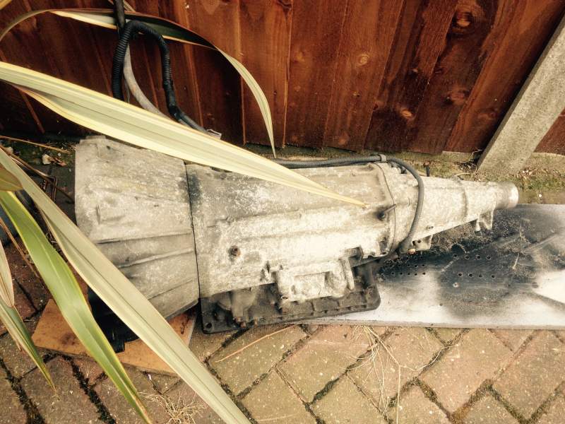

Well going to go and buy some stud removers from machine Mart tomorrow to sort the snapped stud problem when removing the test pipes to replace the transmission. Then get a new stud from SEF.

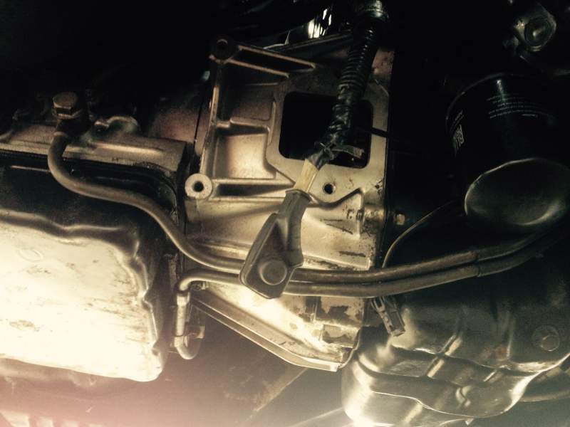

The Transmission is now mated with engine successfully and split rear mount temporarily fitted for testing purposes only as I had to order a Nismo one from the USA as they could get it here in a week thank god!
Filling with Dexron III tomorrow, but waiting till later in the year to replace the Transmission sump with the old one that has the drain plug fitted.

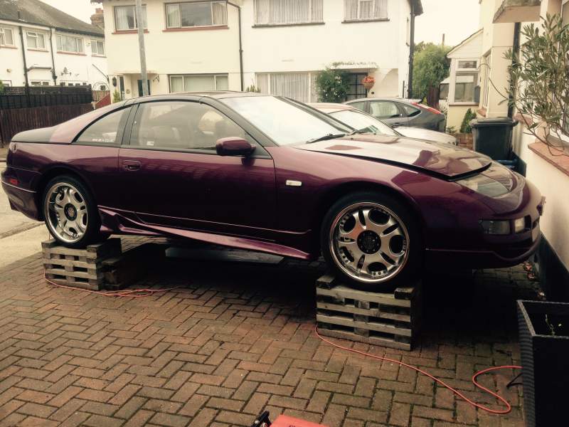

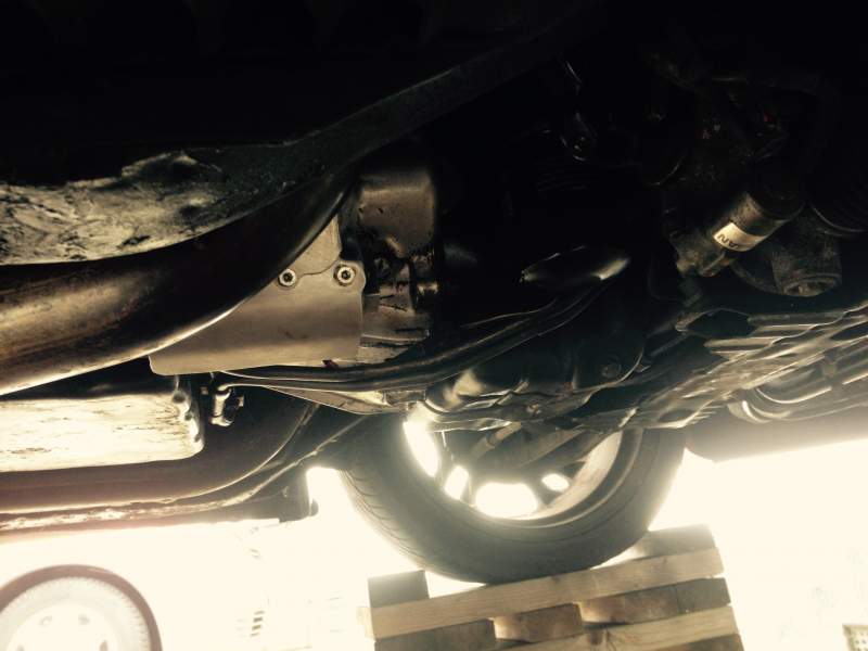

I am sitting her looking at these pictures trying to decide if I should carefully remove side skirts and store away in loft........ or smash them off to make it easier to remove them.....lol
Did you keep the Veilside front bumper?
It's in back garden now feeling unloved and lonely..... lol

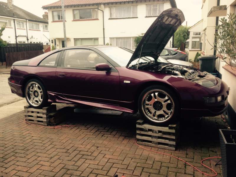

how did you get it up on those blocks ? does it levitate with the vileside side skirts lol
If it did levitate they would be staying on..... lol
I jack up front and slide the 1/2 of the blocks under, then repeat for the rear and then repeat, locking in the other 1/2 of the blocks...... like giant lego / jenga.... lol
It makes it just high enough to slide out gearbox, it's level and extremely stable to work on.... better than jacks when working underneath for long periods....
Only draw back is not being able to remove wheels, suspension, steering, etc...

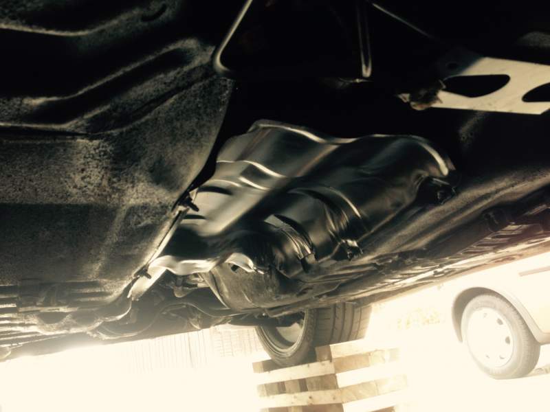

Did you build the blocks yourself?
Yep Lee, 2x4 and a few 4x2 thrown in..... I built them for welding the sill as I wanted it sat on all 4 wheels, so when I cut out the rot there was no twisting where it was jacked up unevenly....
They are very handy for things like exhausts, underbody sealing, servicing engine like oil changes / diff / gearbox, etc....
If anyone is taking out a few stud walls and has spare off cuts or lengths, perfect instead of in the skip...... save the planet and build these instead...... lol
And it is good for practicing your Jenga moves..... lol
Well I am getting her back together slowly....
Starter rebuilt and fitted

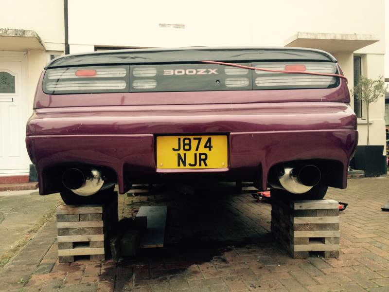

Exhaust nearly finished
Diff oil changed
Should be running again tomorrow.... fingers crossed as long as the transmission I fitted is all okay...... and I did it right..... lol

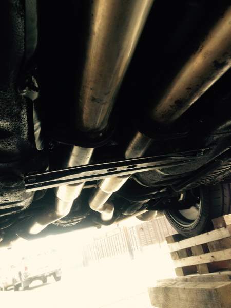

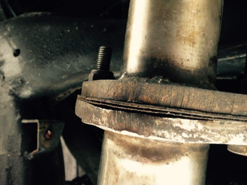

Outside early and hit another problem.... The 2 bolt flange on the replacement exhaust has been buckled and is banana shaped....
My neighbours must love me trying to straighten it at 9.45 with a lump hammer...... It was like church bells, or at least I tried to make it sound like that in case anyone complained..... lol
Anyway..... The exhaust is now on and as straight as a lump hammer and straight edge will allow on a Sunday morning..... May have another go later today with some heat added....... lol
Off the do bolts on transmission to engine and fluid top up....
Testing when battery is recharged again.....
