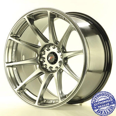

These are the wheels I'm looking at. Would 30 be ok for rears or 35?

Hey yea thats all gud sound advice from everyone i was just going to say nismo recommended in the lmgt4 18x8.5 et30 235/40/18 and 18x9.5 et38 265/35/18 my car came with these wheels only in 17's and these offsets car is lowered and fitted car nice no arches rolled, them wheels are nice theres a guy here in Ireland sells nice wheels very reasonable prices all shipping prices on the site its JDM DISTRO have a look at the" japan racing" wheels they are strong too have them on my drift car goin to order some for my 300zx soon
That's the website I was looking at but I've just bought some different ones as they didn't have the offset I needed. Might look at these again next year when I get the arches rolled so I can go a bit more extreme.

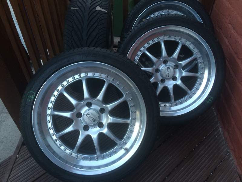

Yes of course I'll get the pics up I'm jus waiting on my 350z brembos to come back from refurb getting them done in white with black brembo decals seems to be the new thing goin on a white 300 with Matt black wheels hope iv made the right choice of colours for the brakes lol
I know, I was surprised when he said they were still available, thought they would've been snapped up already. Will be fitting them this weekend.
They are cool will suit a 300 perfect they look to be in super clean condition nice one :-)
