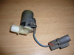

Offside/Drivers side is the windscreen washer. Just try the windscreen washer button on the dash. The motors are stuck to the bottom of the bottle and you can access it by looking through the wheel arch or possibly taking off the undertray. Could be a motor for the front or rear washer jet come loose, maybe a cracked bottle too.
Be worth checking checking the radiator level though and maybe flushing the system if it's been sat for too long.
