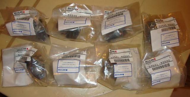

Simon, these are the Nismo bushes I used when I replaced the stock worn out bushes. They are a harder
compound of rubber than stock, but have not changed the NVH to any significant degree. You can get the
bushes from Japan if not available elsewhere.
This is the Nismo catalog page for Z32 front suspension showing the bushes and part numbers.
nismo z32 suspension bushes.pdf
Oooh! Wonderful! Pricing looks good on those too. Mmmm. Might just get me some crappy ones, get them shot blasted and powdercoated black and get the Nismo bushes pressed in! :)
I'm sure NVH will be substantially better than the bearing joints irrespective!! :)

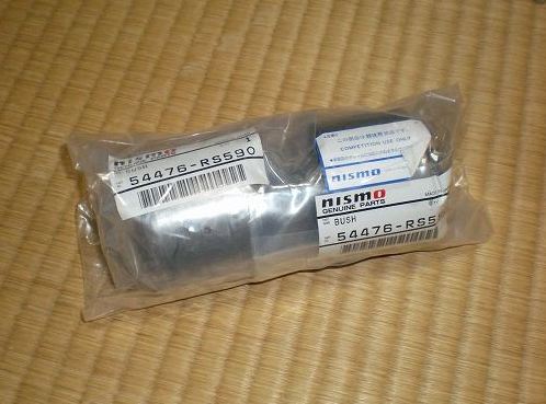

I will be buying the bushings from the US I think, but I want tension rods that are already in half decent condition. In fact, JoelyP and I are soon to be putting an order in a big order for upgrade Nismo bushings shortly. :)
Rear lower arm nismo bushes are no longer made I think you may find.
Correct - no longer made....but.... :p
