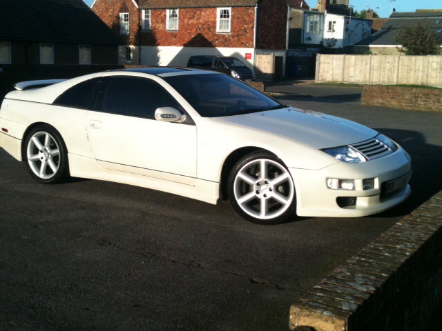

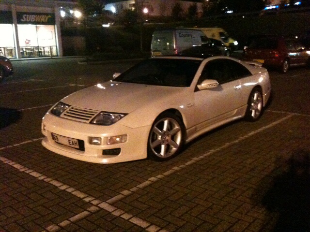

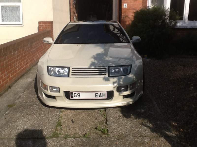

Might stand corrected but UK models don't come in pearl white!
Mine is pearl white & think I like it, a lot :)
Why else a Z?
must admit that she is a beauty!
