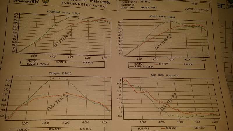

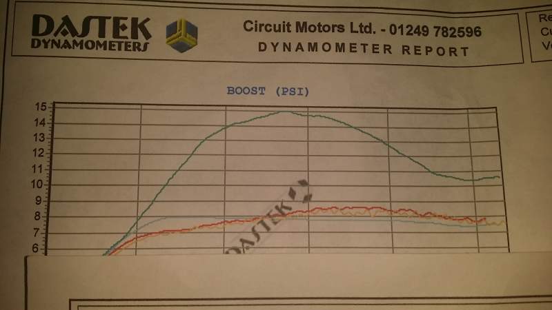

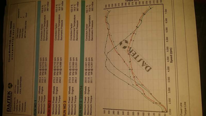

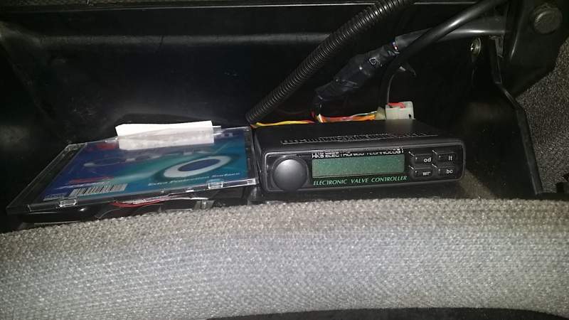

on the boost controller it was set to 1.75 Barr. On the dyno graph it's at 15 psi.
on the controller I turned it down to 0.65 Barr. Just to be safe
Wow. I've seen some poorly set up cars in my time, but that is appalling.
It's far too rich on all but the blue run, and even that is isn't good. The green run is bad. The boost response is terrible, all gain and no duty or a severe boost leak. That may account for the high setting on the controller with a peak of 15psi. You've actually got peak power at 4921rpm before it takes a nose dive, no wonder it feels bad to drive. You'll notice that the other runs are making the same power at 6700-7000rpm. Genuinely can't believe that was "tuned" like that on a dyno.

personally what I think is that they have upted to boost and fuel pressure but not remapped it. Figures like this would not happen with a mapped ecu. Surely not

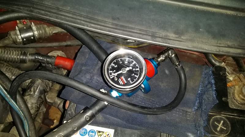

Today before work I turned the boost down... was running at 1.75 Barr. Turned it down to 0.9 Barr. Boost is running fine. Felt much better today. StStill running at 6 bar of fuel. Leans out if any lower. Rang mechanic and they gonna see me Tuesday if need be Wednesday aswell. I think it could be a blocked injector the reason it's misfiring on idle. Also perhaps a vacuum leak?, would that explain the crazy fuel?
Nothing explains 6bar base fuel pressure.

also with the 6 bar of fuel. It could be the gauge is reading wrong as it is a cheap one. Gonna replace it with my spare SARD regulator.
Edited by Joel1993
Today I sswapped the zed afr to my spare SARD one. It's now running at 3 bar of fuel so lucky for me it was a faulty gauge :)

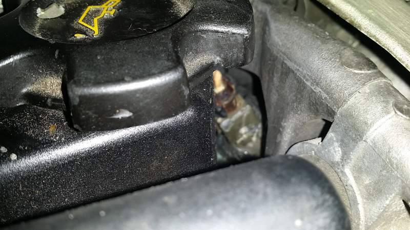

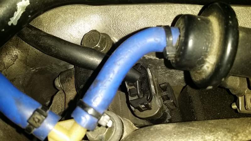

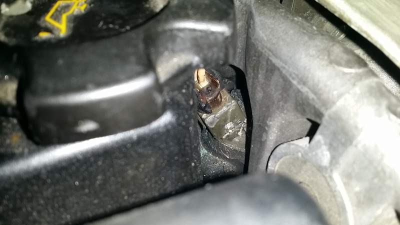

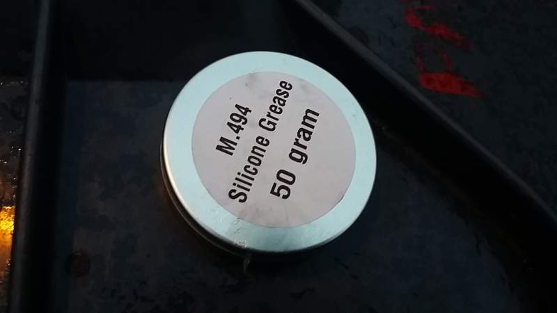

Alright then. Got my sard fuel regulator on. Happy with the results of quality objects. Also noticed why there is a slight misfire. The injector connector has worn very badly, also the metal bit on it is missing so it's a bit loose. Took it off and green stuff everywhere. Cleaned that and put some of this grease in it to help prevent moisture. Feels much better but needs a new connector. Also the coil pack connectors need to be change :)
