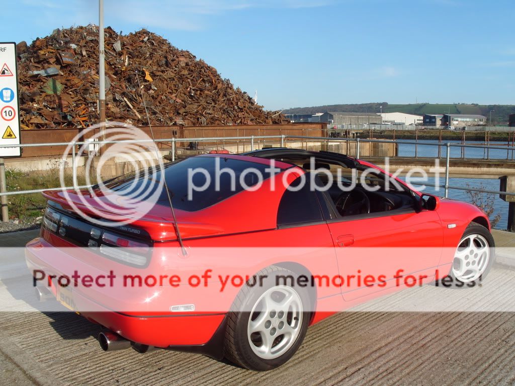

but here Is my 300
not planning on doing much to it tbh, looking at getting the body work fixed up (luckily no rust because its an import) and a few other things.

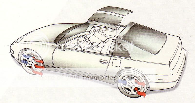

The oem alloys on the 300zx are directional. They flow air onto the brakes to help cooling which means the left hand side are built different to the right hand side.
So your near side(passenger side) wheels should look like this.
And your off side (drivers side) like this
cool that's good to know! will get them switched round then.
Make sure that your tires are also facing the correct way if they are directional and welcome to the club :)
it seems only that one is facing the wrong way...
