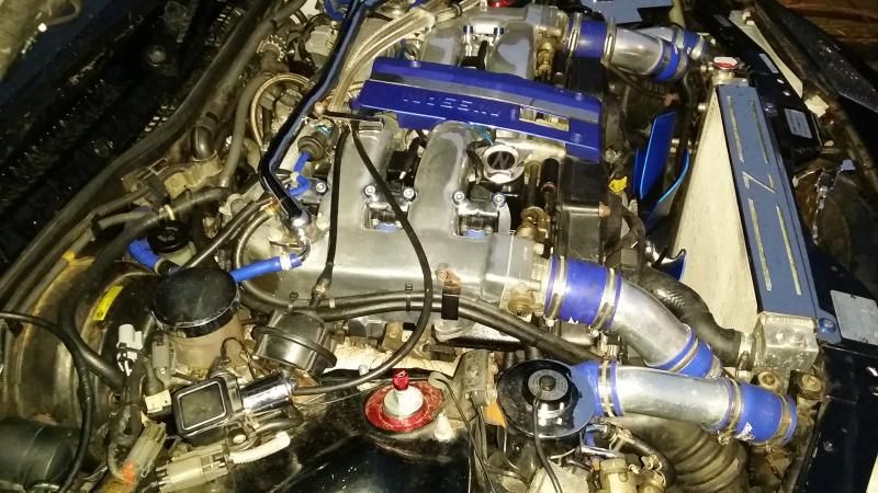

Post a picture of your engine bay.
Here you go Noz

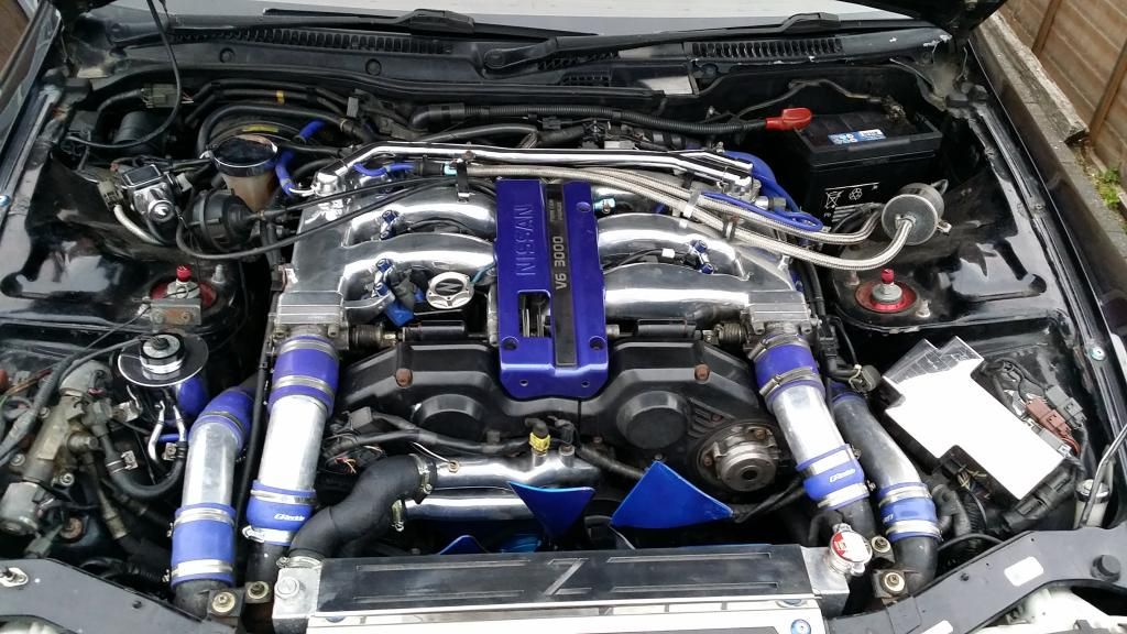

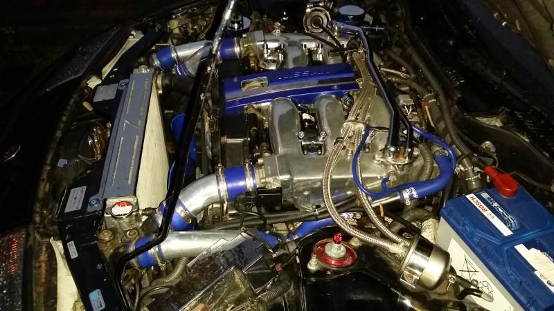

Just as I thought. Although I can't be 100% based on that picture alone, I think you're going to be chasing your tail forever on this one.
Got any more pics of the engine bay? Both sides?
What exactly are you looking for mate?
I could probably get pictures of whatever you want tomorrow

Did you see this Noel? Need to understand what you want pictures of and what you're thinking.
