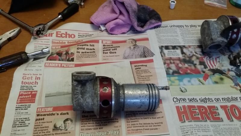

I'm debating on fitting recirc valves back on to the zed (still unsure) where I currently have Apexi twin chamber BOV's.
What I'm wondering is whether I should just be a straight forward swap or if there's a possibility of stuff missing?

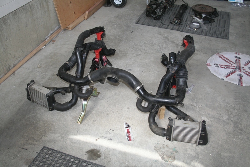

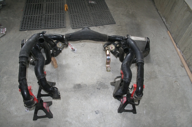

Ill take pictures tomorrow. But in short they go where the old recircs go.
Basically, I need to know how the recircs would look in situ

It's basically like this. http://www.twinturbo.net/nissan/300zx/tech/bov/bov.html
Reading it, I'm guessing one of the pipes will have just been blocked off but would need to make sure I'm putting the right pipes In the right places

Right. So went out to try and fit the recirc today and found I had 2 of the same side... Doh.
Anyway, I also noticed that the half circle shaped pipes have been cut down for the bungs in the BOV kit to Block that pipe off.
