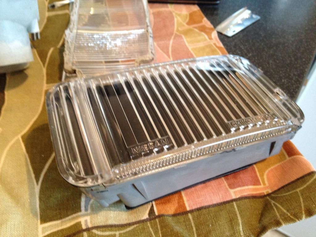

The fog lights are slightly harder, especially with masking and removing the clear tabs (without breaking)! Chuffed that people are using my ideas. :)
Not sure if I'm going to do the foglights or not... it's certainly not a priority at the moment.

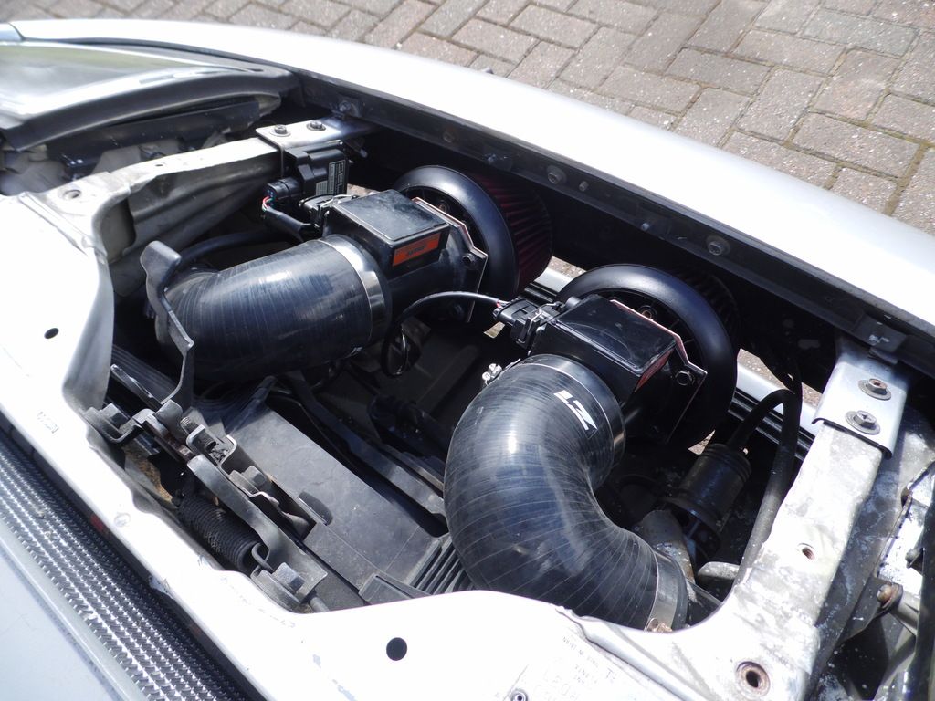

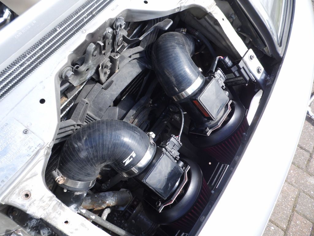

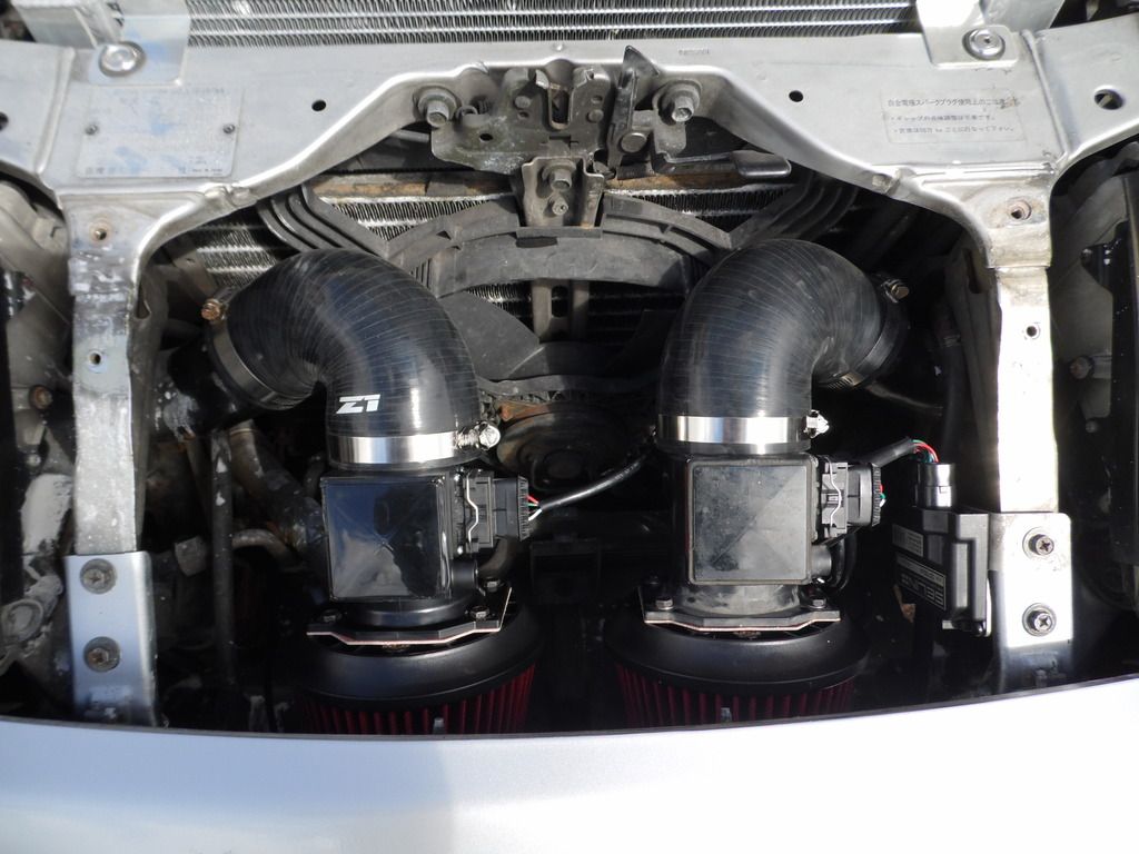

Next job (when I can bring myself to do it) is to fit the dual MAFs, the Selin translator and the new Apexi filters! :biggrin:
That would be this morning then!
All fitted - took maybe an hour at most. Absolutely plug'n'play and no issues on start up. :)
The new Apexi filters should help things along (genuine ones as well) and I'll report on what difference it makes once I've actually been somewhere... maybe this afternoon if the weather holds off here.

just looking at the gen 1 in z1 over in the us. says you need to map the car to get the most out of it. or you can pic add mode with out remap
According to what I've read, the "AVG" setting is for ECUs that are programmed to recognise a dual intake, whereas the "ADD" mode is for those that only recognise a single intake.
So my Selin's set on "ADD" which (all being well) will be fine :)

We've had a nice little run out this afternoon to see the in-laws for Father's Day and I can confirm that the Selin does make a difference!
Pick-up is noticably quicker and more immediate - I'm genuinely surprised by the difference it's made! The car's much more responsive to drive now :)
An expensive modification? Yes. Worth it...? Hell yes!! :biggrin:
