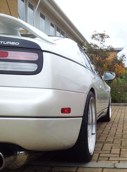

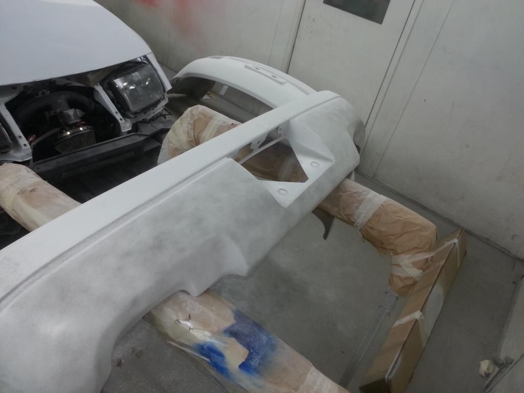

Yes it's moulded in on both the front and the rear. The stuff on the sides is some sort of bitumen. The sides are easy to sand, the bumpers are actually quite hard and bind up sanding disks very easily. I had my front sides and rear done about 7 or 8 years ago and it really smartens up the look of the car.

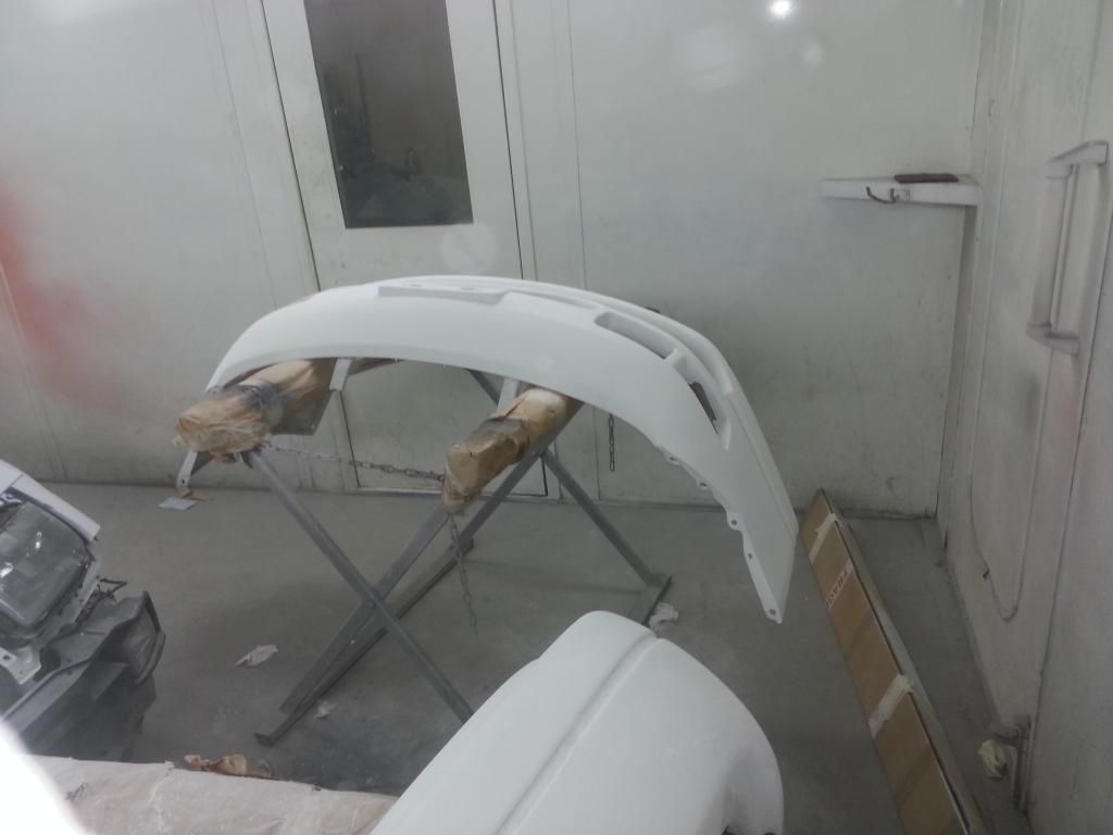

Front bumper takes an age, but if you're changing it, then you're saving yourself a lot of labour!

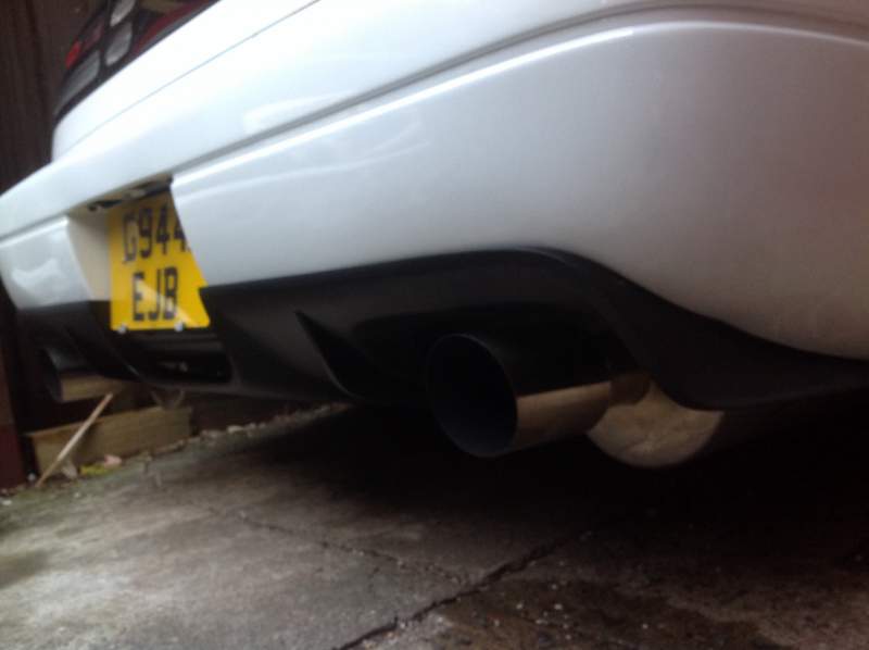

The smooth look definitely looks better with the diffuser. It is easy to sand down.

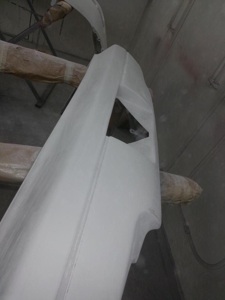

Just get a 120/180 on a da take it pretty smooth then jump to 240 then 320, couple of coats of high build with flex in it,
Leave it dry dust it with a matt black aerosol then block sand i started with 320 up to 800...
