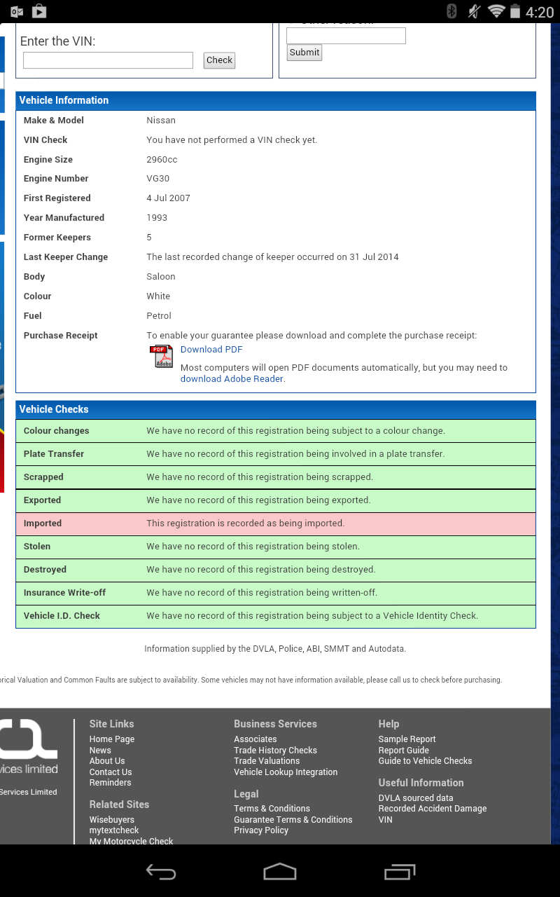

That's not cool, is the chassis rail compressed then or something? Has the car be written off at some point or repaired without that happening, I say repaired I mean bodged, as I would expect far more damage than that was done at the time. Did you do a HPi check?
I looked through all the paper work as if it was written off and repaired then it would state that on the log book wouldn't it? Didn't do a hpi check :(

No.
It's only on V5 in case of a Cat A or B.
Cat C or D is not required to be on the V5.
I know you're probably feeling crap, but why on earth did you not do a HPI check?!?
It may never of gone through the books I guess, just fixed at home and sprayed up sold on. Not very scrupulous but it happens, it may not of even been the previous owner it might be historical by now.

Not quite, A cat D isn't on the V5 either............
