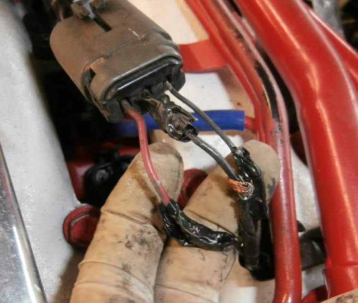

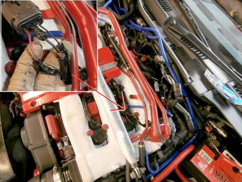

So you can see from the picture a generally ok job from a non specialist garage doing the rocker covers and plenum pull, but letting it go with a misfire was somewhat remiss though, anyhow a quick look and could see the coil pack connector had been changed very poorly with twisted cables and rubbish insulation tape/
Looking closer the poor connection and even less than useful insulation take did reveal something though, the cable colour`s where wrong as is the cable size for the coil pack connection.

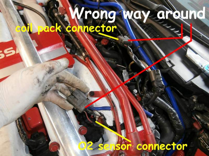

A few moments with a test meter and the problem was revealed, the coil pack connector and 02 sensor connection had been installed the wrong way around, the cable runs under the balancer bar and so had to be released to switch them back and sort out the dodgy connection, 10 minutes later and purring lovely, seen connectors mixed up before but cannot believe a garage could not trace it and then let the owner take it away....tut tut!!

Sorry, just so I'm clear, the O2 sensor was plugged in the coil pack on cylinder 4 and vies versa?
Yep!!

What a shit Idea that Nissan didn't make the connectors non-interchangeable!:ph34r:
Agree especially where connectors are close together, another common one I see wrong is the near side variable valve timing solenoid connector and the det sensor connector both two pin units with the same detent lobe and are clipped a few inches apart.
