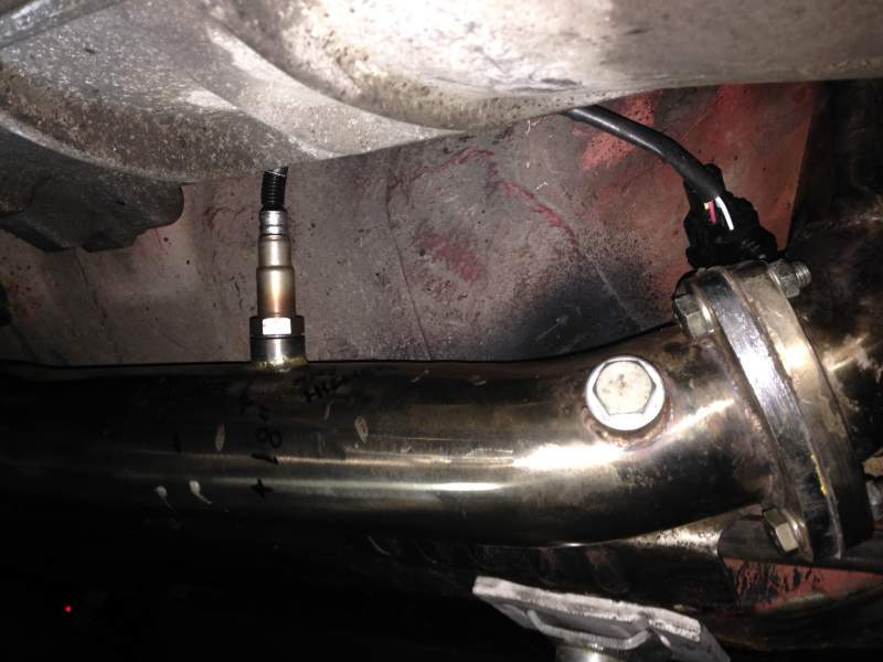

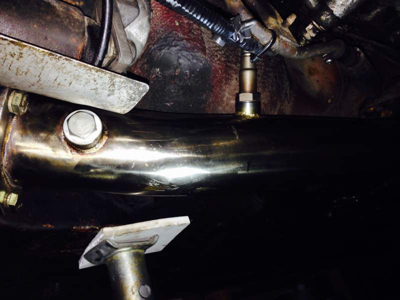

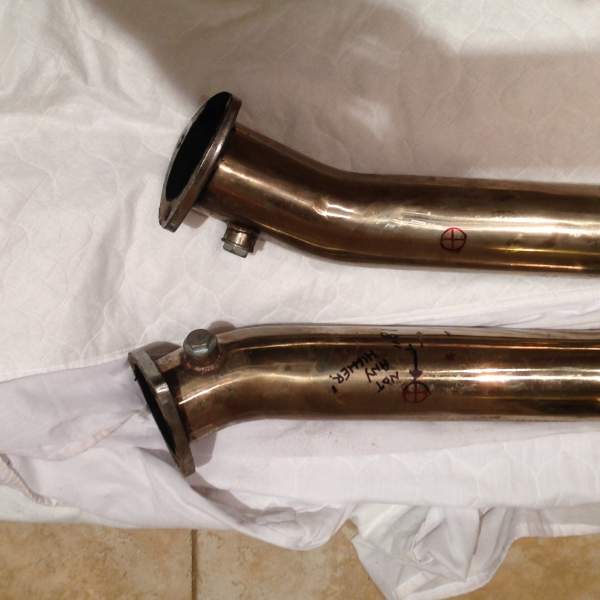

Finally managed to get the test pipes off. Drivers side was the problem with bugger all room to get at one of the bolts from the downpipes., as have a 3" exhaust there is even less room. Have marked where the bungs are going to be fitted for the AEM widebands, hope my welder at work will have time to do this for me tomorrow? Then wire up the gauges fit in the custom made fascia and set up the "failsafe" aspect of them. One more step nearer to getting the car mapped by Noel.
Ps spin doctor from the turbo housing to the flange of the DP was 10" my instructions say to mount 18" from the turbo, so you can see they are quite a long way down the test pipe. Obviously check your instructions for whatever gauges you have.
Edited by bigh
Added info
Got the AFR bungs welded in today and refitted the test pipes this evening
Just need to wire these up now.

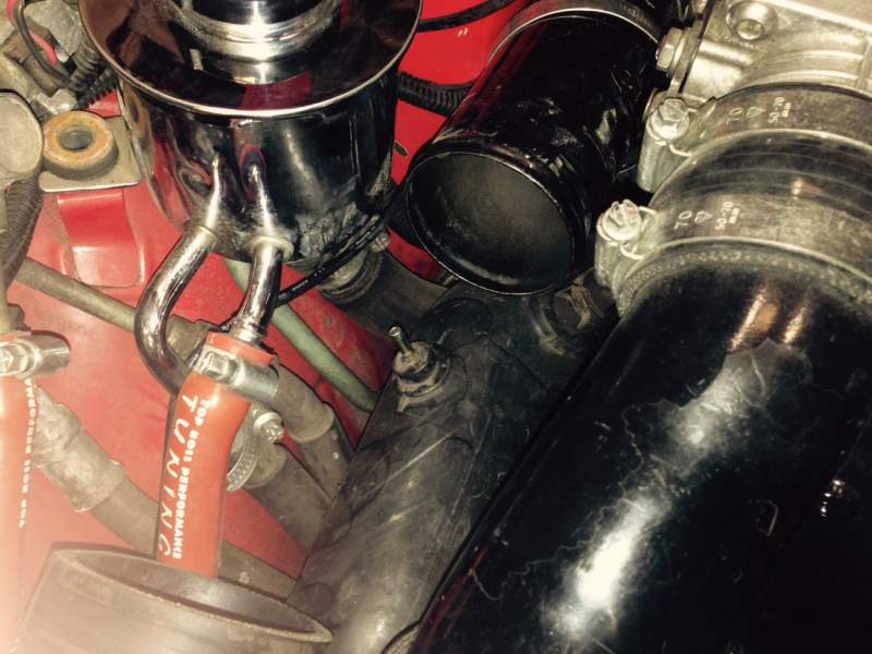

Then on to a smoke test to check for any leaks. This found a hole in the vac line that runs from the lower pipe to the side of the throttle body. The hole had been caused by the larger pipe that rest next to/on top of the line, had rubbed through the hose causing the hole.
After replacing this line and re connecting the intake pipe work Greg carried on with the test. Unfortunately after the system was pressurised another plume of smoke appeared, this time by the injector next to the oil filler cap.
After finding this it became obvious that the car wouldn't be getting anywhere near the Dyno today. So although a frustrating trip at least the problem was found prior to the mapping, and no serious damage being incurred. Once I have the 'O' ring replaced I will be going back, hopefully to see Greg work his magic on the rollers.
Frustrating indeed. That clutch issue playing up again is also a pain. This might be worth a read as it may be a simple fix?: http://specialtyz.com/blog/?page_id=178
I've replaced that little vac line myself on mine more than once for the same reason, poor design. As you say, it's reassuring that these checks are done beforehand and it's also a lesson learnt as these simple checks can be done by ourselves before we turn up on the day. Did you happen to notice what the smoke generator was and did he just remove the MAF and install it into the inlet with a bung? How long did it take for the smoke to reveal itself? I try to do boost leak checks regularly using compressed air, but the smoke method seems much more efficient, so I'll get some smoke grenades!
Has you plenum been modified to allow removal of the injectors without a plenum pull?
Thanks Joel, I read the Specialty page last night, not looking forward to reaching up under the dash though. I will be adjusting it the pedal and replacing the OEM line with a single one straight to the slave, so hopefully get rid of the problem once and for all.
Sorry I don't remember what the brand of smoke generator was, however I do remember that Greg said it costs around £800, so not in reach for most of DIY mechanics. Yes the two MAFS (Selin) were removed, 1 fitted with a bung and the other filled with a pump up type "ballon" that had a valve in it to pressurise the system. Probably took 3-4 mins, pressure reached about 6 bar I think, (should be twice that apparently).
The injector seemed to be leaking from the lower injector seal, or possibly the seal between the fuel rail and the lower intake manifold, so the Plenum needs to come off :angry: for a full inspection.
