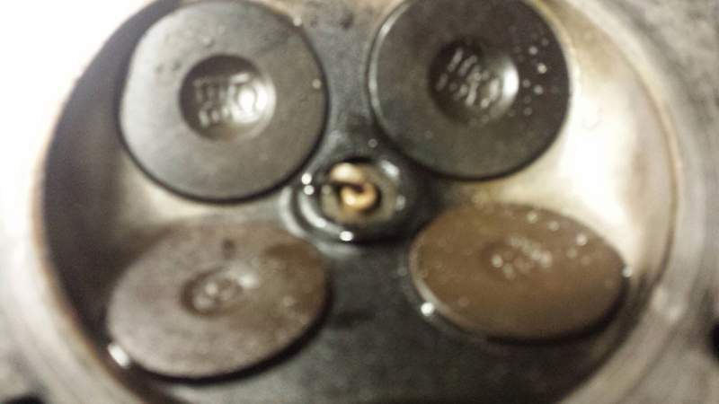

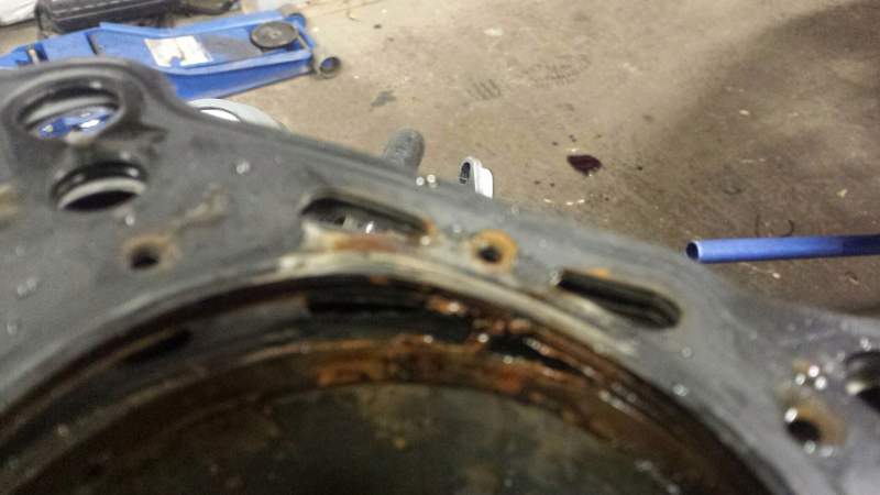

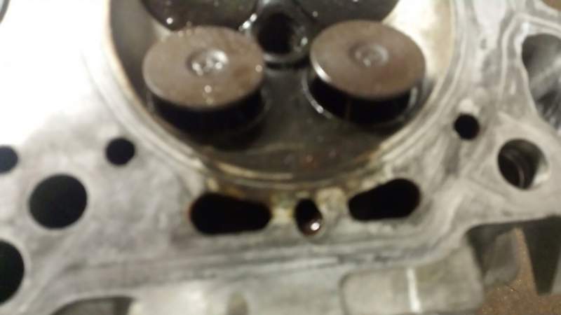

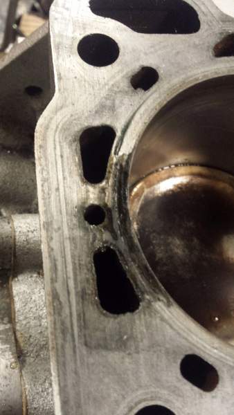

Well Jim got the heads off the other day and you can see where the Cometic gasket failed
No detonation damage
Naturally:smartass:

Hopefully you won't have to see that view again! Looking at the spark plug projection into the combustion
chamber, what plugs are they?
I hope not to Andrew.
Re the plugs they are NGK I cannot remember the exact variant atm, will have to find the invoice.
