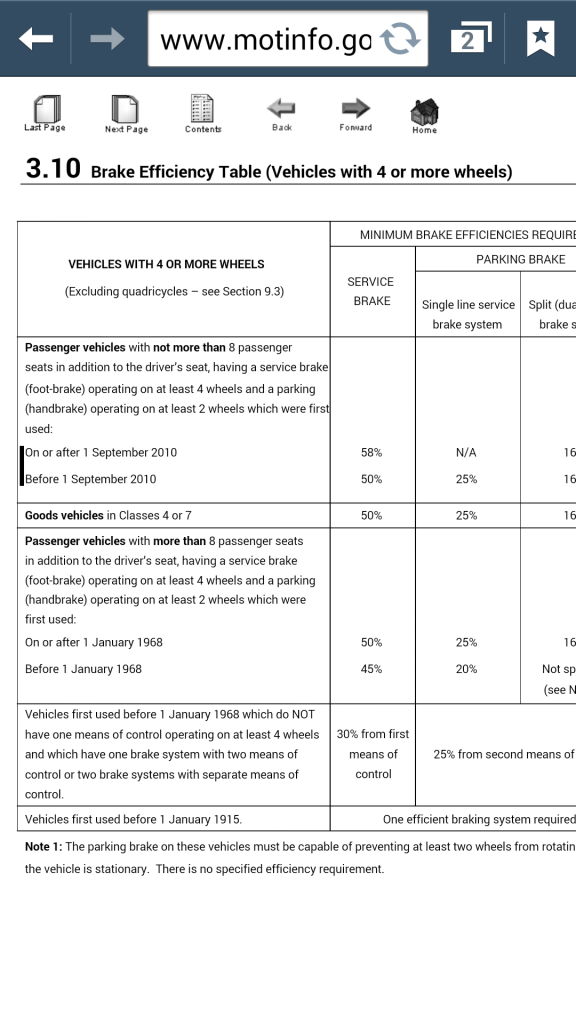

The difference in front to rear does not matter,
50% front 16% rears is minimum,
If there all working right they should pass even with the biggest brakes in the world on the front has long as the rears have a minimum of 16%.
Sorry if I read wrong but sounded like your saying it failed cause fronts are a lot more powerful then the rears...
Just go back and put a complaint in and ask for a retest or your going to ring vosa and say its an lsd diff and was tested on the rollers...
they may think and pass it quick lol...
Tell them it should be tested with a deceleration meter with 50% front and 16% rears being the minimum.
