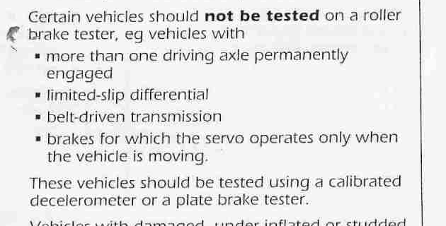

How did he brake test it, hope it wasn't on the rollers, lsd or 4wd should not be tested,
Should have been tested with a deceleration meter...and its hard to fail one of them lol...
I can see the reason for 4wd with permanent drive. What is the issue with lsd on rollers (each wheel tested as a pair)?
Hold on Terry you will have all of the UK z owners worried, at a pedestrian 3.5 miles per hour the brake roller stresses is negligible, any stresses on the LSD in normal road use will far exceed those resulting from being put on a brake test roller that works at 3.5 mph!
You are correct in principle ( see Vosa MOT recomendation 3.7 Brake Performance (Roller Brake Test) attachment )
http://www.skylineowners.com/forum/attachment.php?attachmentid=8719&d=1107464275
but been pedantic over the test was exactly we and you we saying not to be, zed owners have enough to worry about, in 14 years doing Mot tests on Zeds never seen a diff remotely damaged from it two minutes in the brake roller, saying that to fail on the roller the brakes do have to be bad as it is such an easy pass level.

Its said not to test it on the rollers with an lsd it can brake the diff,
You shouldn't lock 1 wheel while the other is spinning, I wouldnt test it on the rollers at all if it breaks I'll be the one paying for it,
Has a tester if its lsd and every tester I know will not test it on the rollers,
And if he tested it on a deceleration meter it would have passed if it didnt there must be something serious wrong...
What was the brake weights,
Did he test both wheels together, did one lock why the other one was still low atl lanes can give incorrect readings.
The wheels should each be tested independent, but does not have to be so if 1 wheel is wet slips on the rollers and locks,
The other could be reading low...
And if each wheel is tested independent then 1 wheel will be spinning on the rear why the other is locked which is where damage can be done to the diff...
And this bit says it all for the tester:
If it will break it or not it should not be tested.
so your tester jeff was doing it wrong and put your cars at risk of damaging the diff,

I don't think the second garage is going to look at it till monday, national tyres did use the rollers, because I said your computer will shit itself when it sees the difference in brake power. The man was a robot, had no shades of grey it was black or white. "Mate my brakes are not standard" "The rears aren't strong enough, the car has failed" etc etc...

Given we know it does not cause any damage on the 300zx what your talking about is the actual Vosa advice that I highlighted, the key here though is the rules, regs and advice has to cover every car that can come in and every kind of roller tester so becomes generic in its application, any tester worth his salt will know what does and does not work in the real world and an experienced tester will have learnt many area`s of the test can be misleading, from this Terry I take it you never test cars with lsd or abs on the rollers? so you have not gained the knowledge then from actually trying it out to see if that is the case, widening your experience procedures is always a good thing and a little application of good sense goes a long way, but do accept in principle the rules state otherwise.
