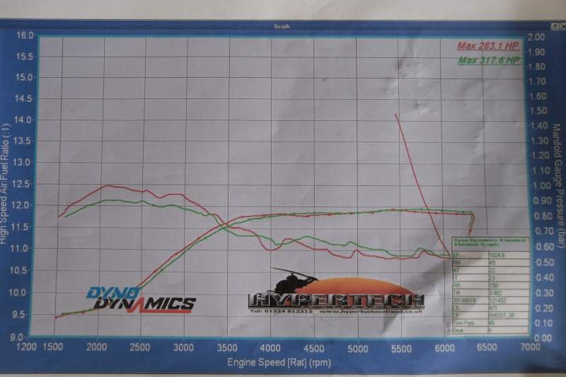

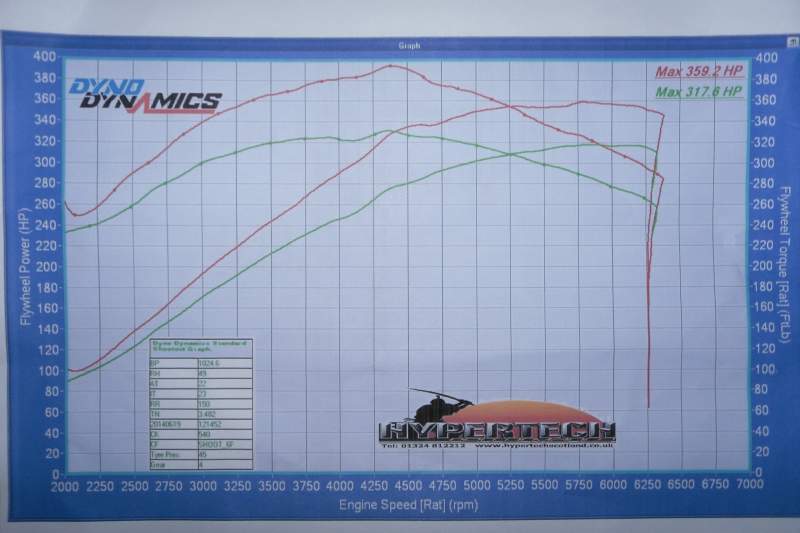

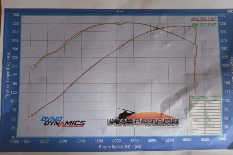

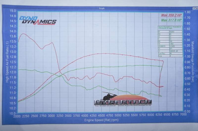

First dyno run of Zed, not sure what to make of the figures...
I've attched copies of printouts.
Car is a 93 Import Twin Turbo.
Has boost jets, zedworld chip, japspeed decats and kakimoto backboxes, apexi filter, arc side mount intercoolers and running colder plugs.
Boost jets are supposed to be giving a bar, but on the graph it's making around 0.83 or so.
Torque figure seems ok to me, but power seems low?

is this wheel bhp or at the flywheel
If that's at the fly that's not right. Mine on stock ecu(no chip) stock boost (9psi) and auto turbos made 283bhp at the fly or 279bhp corrected fly wheel figure whatever that means.
In my experience you should be making 330-340fwhp on that chip and 14psi.

Mate that looks a good graph to me, really smooth and making stock power. You are lucky your jets are giving you that boost, mine gave me 21 psi that I didn't discover 'till about 1500 miles later when I fitted an after market boost gauge that went higher than the stock one. I immediately fitted an electronic boost controller to lower it and it ran a lot better. A generic chip will never be as good as a rolling road session. My rolling road session was cheaper than the jets and chip that gave me 21 psi then 330hp after I reduced the boost to 14psi with ebc.
But that aside that looks a lovely smooth power curve and I assume its RWHP.
I would assume that too, if you guesstimate the trans loss and put it on you've got that figure 330ish fwhp.
so its making 37 more bhp than stock if at the fly

It's defo flywheel horsepower.
The car drives fine and feel quick enough, but just going on many other cars with similar mods, I seem to be down on the power front.

I know it isn't running a bar boost like the boost jets should be going, more around 12psi, but was still hoping for more than 317bhp.

The AFR should be able to allow someone with the knowledge to say you can safely turn the boost up some more or not, have you tested for boost leaks? tbh as I said earlier generic chip and 14 psi normally equals about 330-340fwhp depending on the chip and overall health, so at 12psi its not really far off that.

It's pretty lucky/hard to make 350-370 that gets quoted on the average chip you'd need way more than 12psi on stock turbos generally as well. If you want to make power on stock tubs a custom map is the way forward, safer too.

The boost figures I'm quoting are from the dyno run sheet, the in car boost gauge is reasonably accurate though as it sits before 14 at where I would put a 12.

pm noz mate, he is the guru, but I bet that car is totally fine and the figures are wrong, or he set the air pressure (atmospheric) wrong or there was a dead crow under the rollers or something. I think a boost leak is unlikely with that steady peak boost.
I am prepared to eat humble pie, but I hope for you and the car's sake that I am right.
