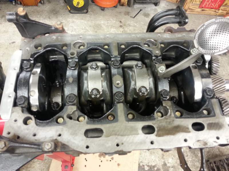

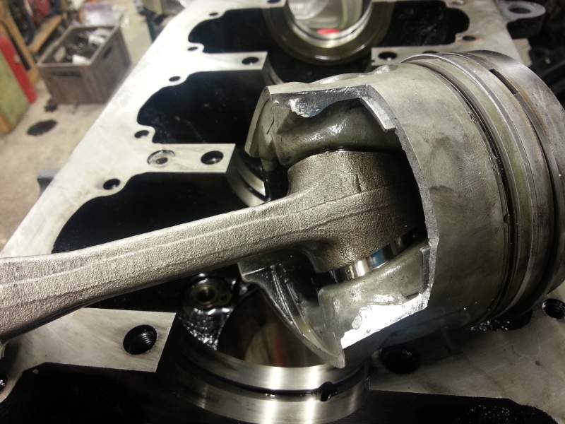

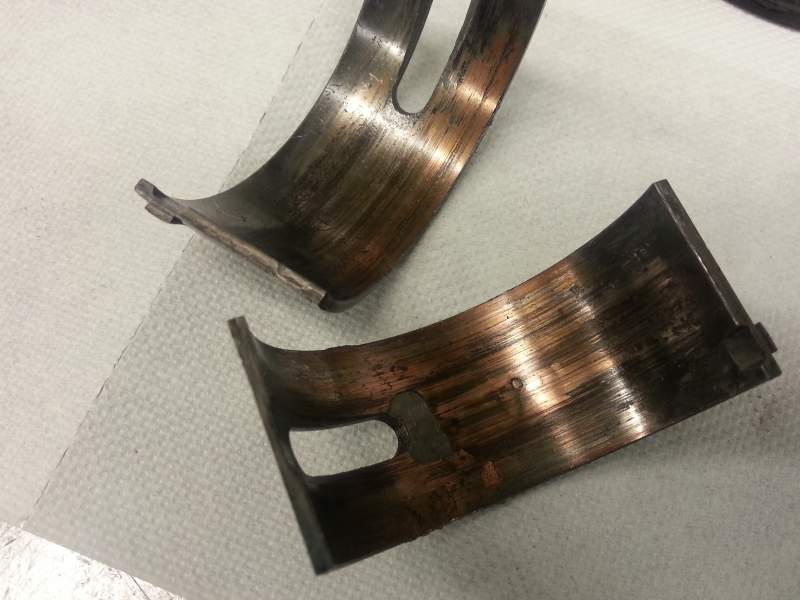

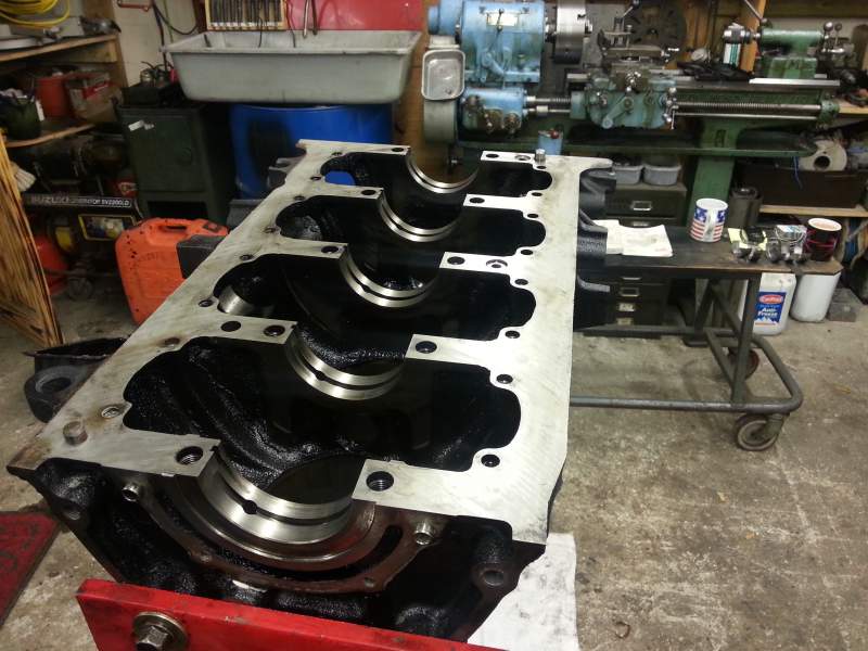

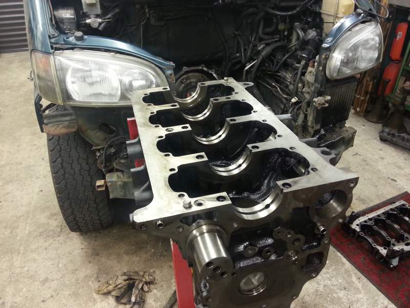

Recently i bought a truck with a tap on the motor for the right price so i thought ide have a bash at an easy fix and replace the camshaft that had a flat lobe,also removed the front engine cover and replaced the timing chain along with a few other small bits like valve stem seals ect. Built the motor back up and she started first time like a good one BUT still had the tap:confused: Thats all i need for an excuse to get dirty so out comes the motor and tears it down to be greeted with this:eek:...Reason being some knob jocky had used too much jointing compound on the block to mains crank cradle and had blocked up number 2 under crown piston oil squirter and over heated the same said piston. Luckly a light hone will bring the cylinder back and the crank needs a polish. Full rebuild kit including 4 pistons..all the plain bearings..oil seals..rings and gaskets to OEM quality only £260,lot cheaper than a zed i hear you say:tt2:

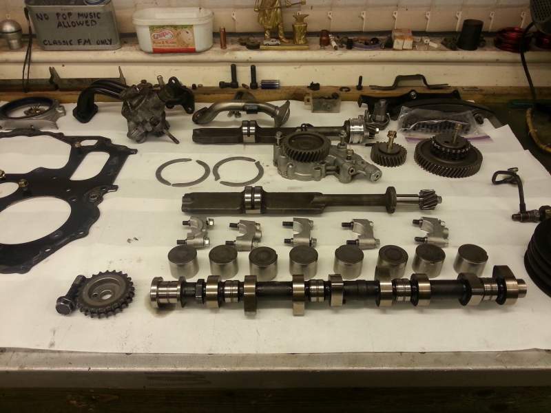

Can tell your a fuddy duddy you have no pop music only classic fm on your radio lol

Built the motor back up and she started first time like a good one BUT still had the tap:confused: Thats all i need for an excuse to get dirty so out comes the motor and tears it down to be greeted with this:eek:...Reason being some knob jocky had used too much jointing compound on the block to mains crank cradle and had blocked up number 2 under crown piston oil squirter and over heated the same said piston. :

noticed that after i uploaded it can be seen...lol

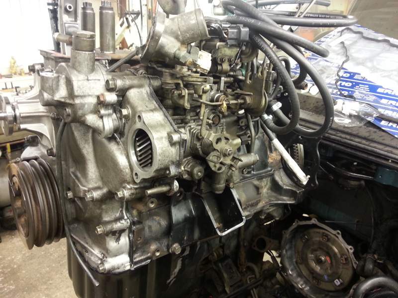

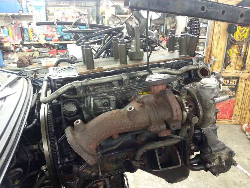

What jap motor is it Bri,i noticed the balance shaft in the pic,is it a mitsi ? they like using them,top work by the way fella :gunsmilie:
Them transits still Got to be careful still had a transit in the other week and parts of the cams had broken, Dagenham dustbins lol...
Nice work on the other engine...
Honda and alfa use them shafts I've seen them removed on preludes.
yea a mitsi 2.8td Jim....very well built engines inside mate

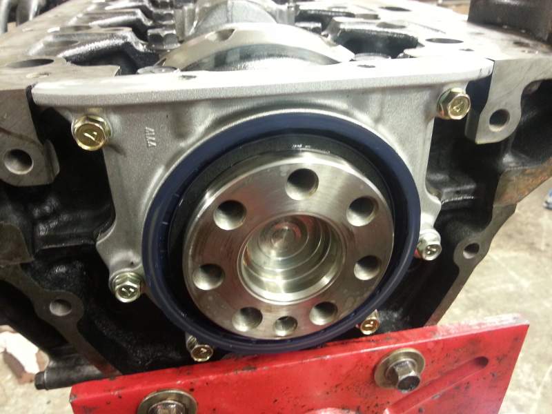

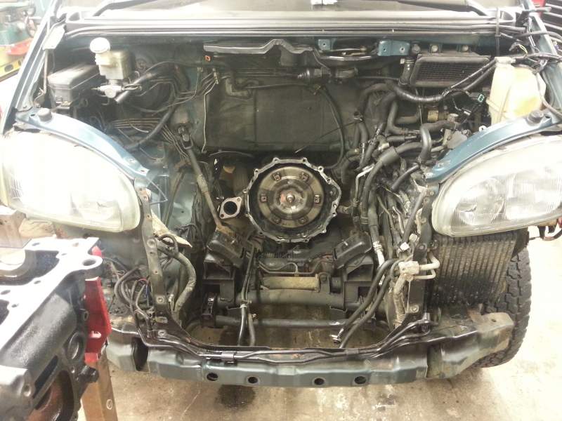

little behind on the pics as these are weeks old but the truck motor is now 250 miles old and ticking along like a Singer sawing machine plus sailed through MOT with no advises. Even managed to shoehorn a Zed steering wheel into it to make me feel at home:beta1:... will update new pics in next couple of days for those interested in things Mechanical

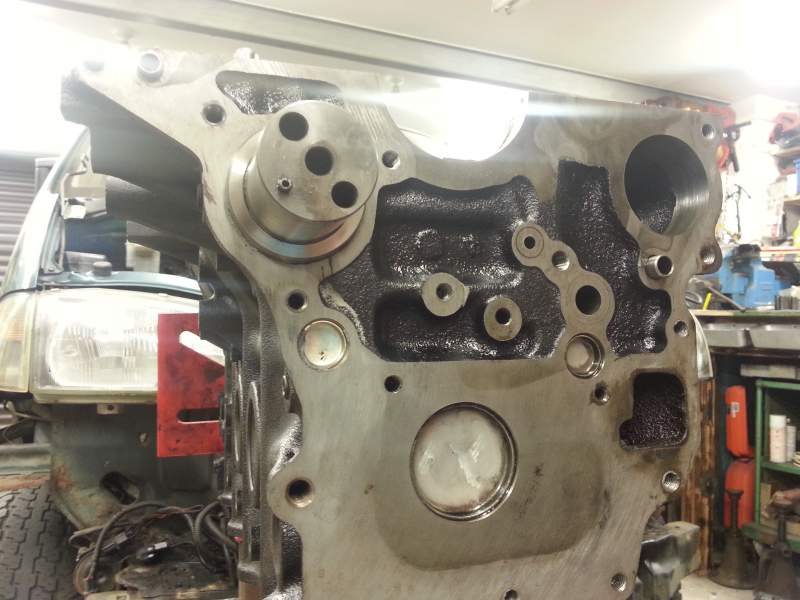

I like that hoist plate u made...
the zeds are a pain in the arse no lifting eyes lol...
