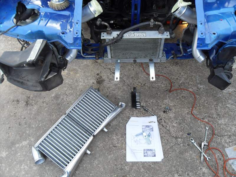

I got the kit a few years ago and got around to fitting it last weekend :) I'm not running by all means but looks ok, I'm relocating the oil cooler and I have ditched the aircon rad and I am getting a bigger rad for cooling, quality wise seems ok and wasn't too bad to fit.

if i was going to leave my aircon rad in then i wouldnt have considered putting in a fmic but i did get rid of that and upgraded the oil cooler to.and if your not looking to gain over the 500 bhp mark then dont bother unless you have a kit that needs somthing there, cas without it would look silly in my opion

Having this one never caused any cooling issues and it,s made for a 300 so all the pipe work fitted perfect , i did use a front mount for a different reason but it never caused any issues !

IIRC the make was Autobahn , off ebay .
