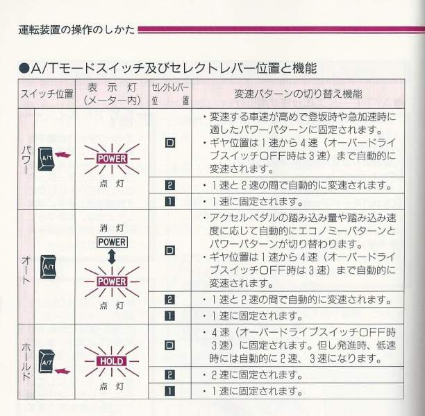

It's even in the manual so can't think why anyone has a problem:
OM_Auto_buttons.jpg:devil2:
