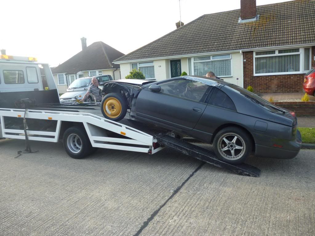

Was bored at work so I thought I'd make a thread from start to finish of how I bought my zed shell from Sussex stu till now.
I know I have a couple of threads with photos of respray and another with the build but thought I'd put all the pictures so to try and see how it came along...
I still aint finished so I will just update it has I go along...

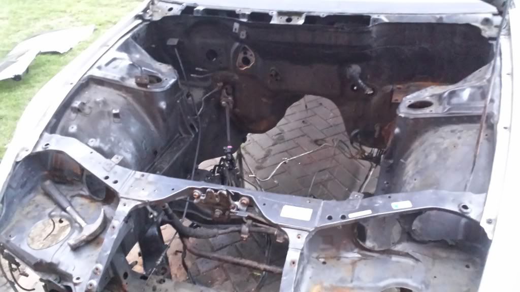

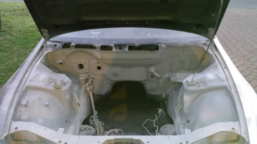

This is how it looked when I 1st got it

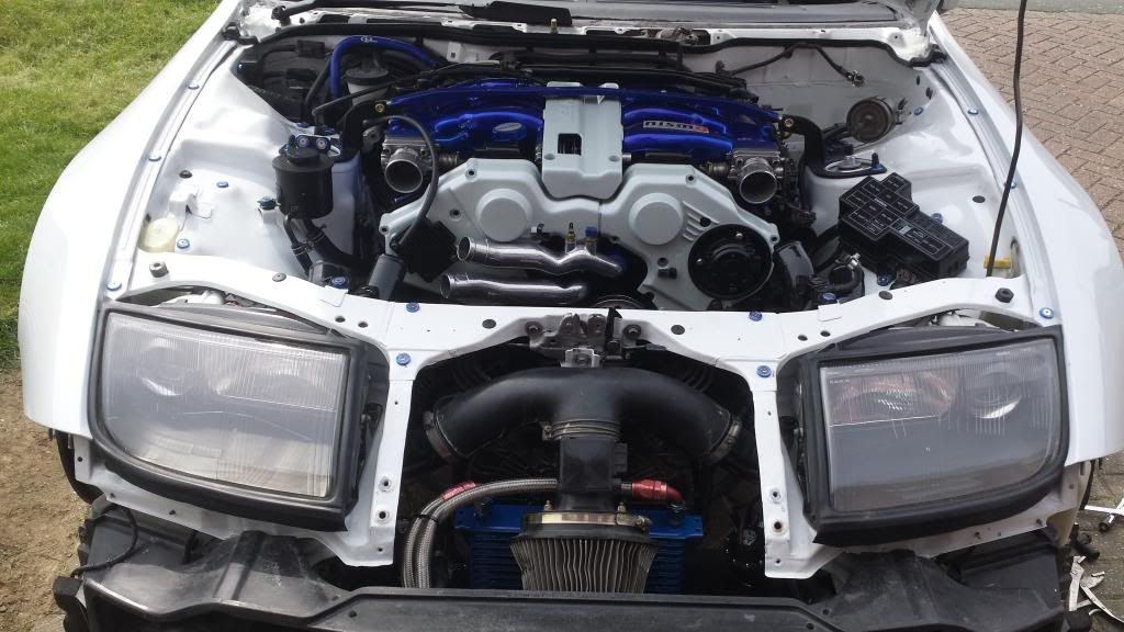

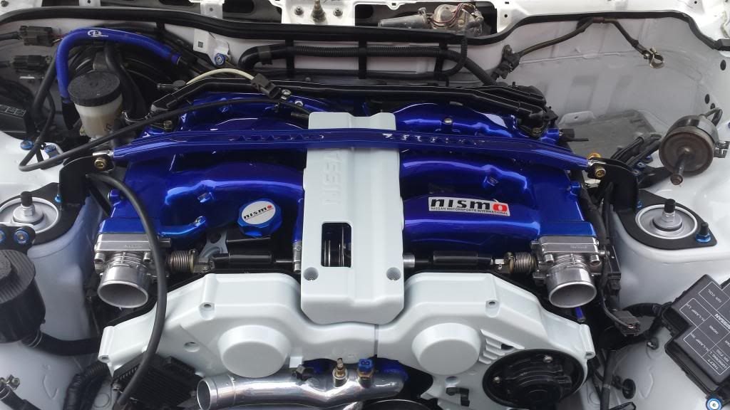

The engine bay

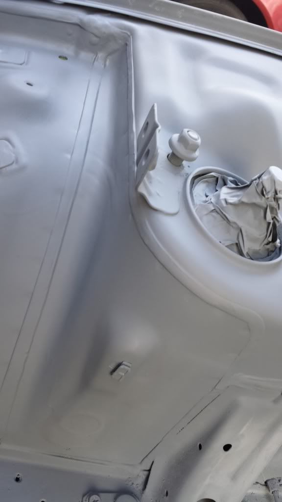

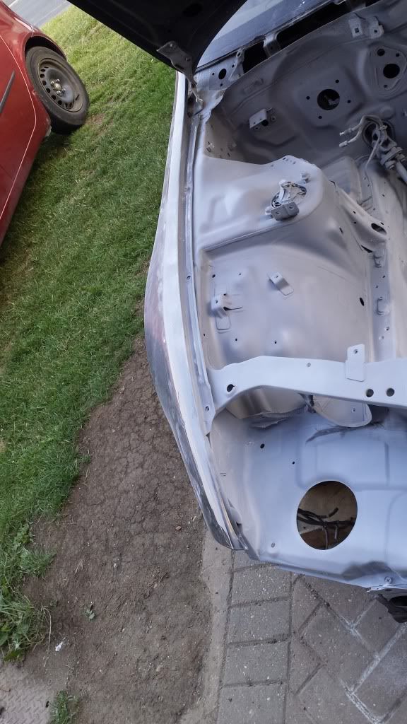

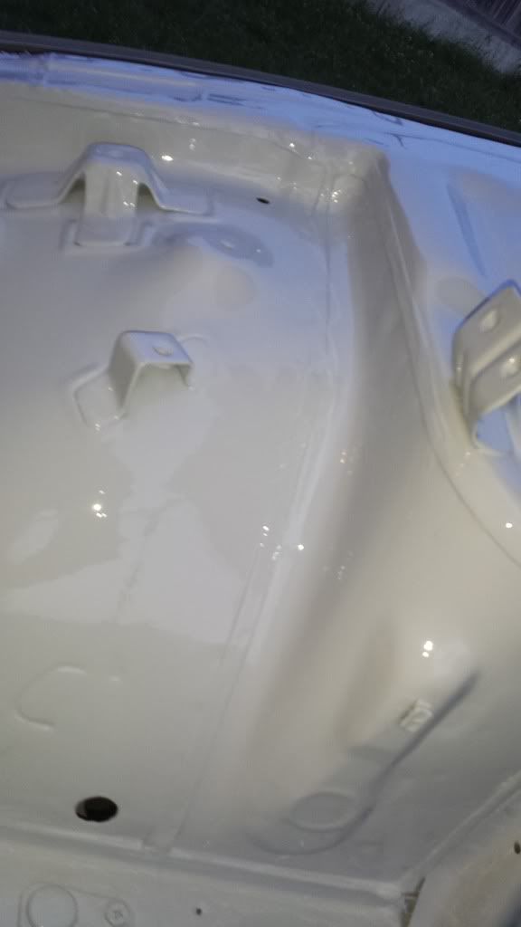

I took it back to metal etch primed then seam sealer then 2k primer
Then some 2k white

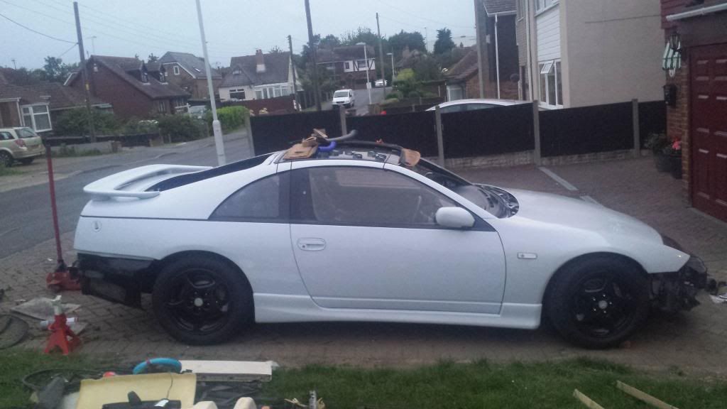

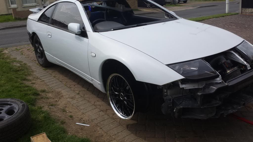

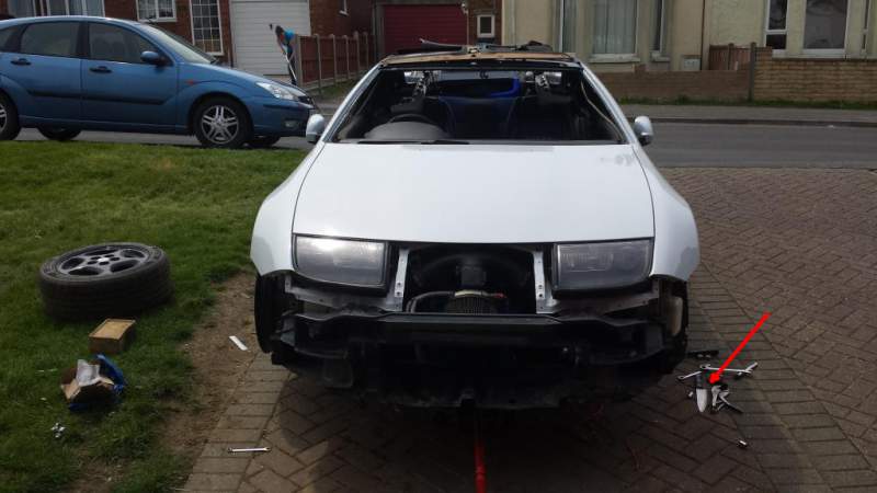

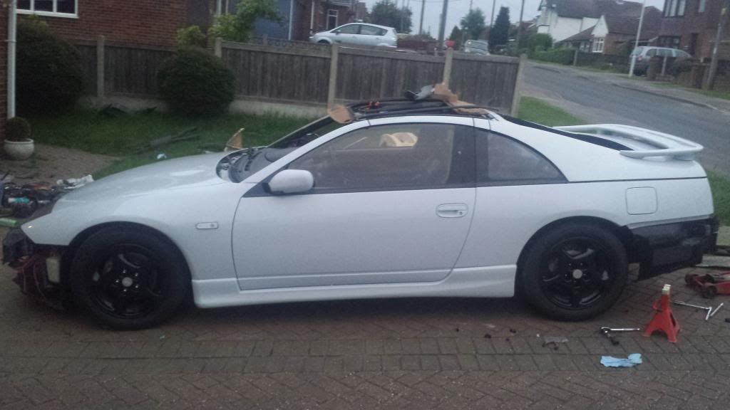

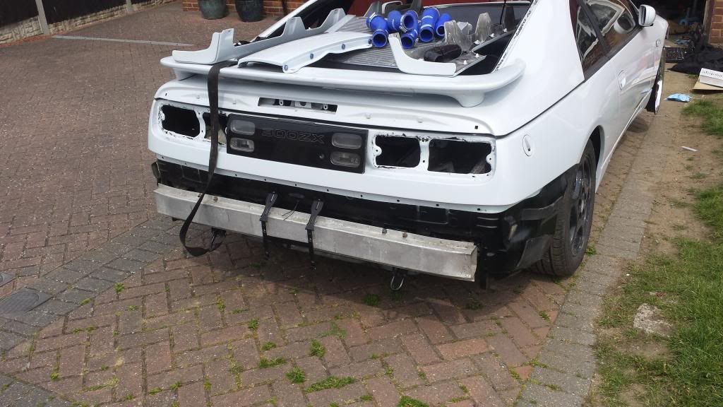

Few more pics of the zed, its nearly back together now, got to fix my wiring loom, put the windows in and the radiator etc,

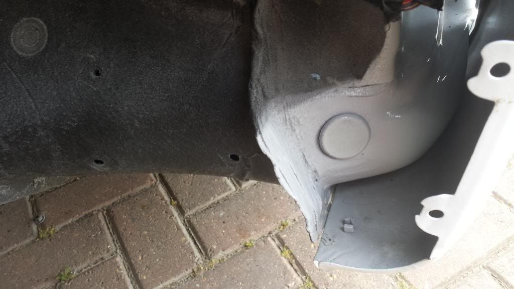

Took bumpers back off to make sure everything is ok,
Hopefully over the next week or two I might get to start it,

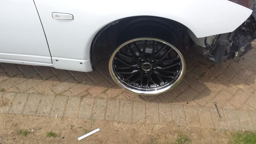

Tried a new wheel on there been in my bedroom about a year lol, it fits ok...
We didn't forget to paint behind the back bumper, we painted it black thought it would look cleaner from underneath lol...

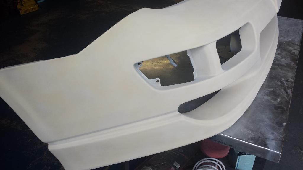

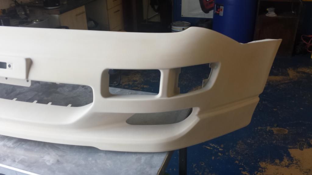

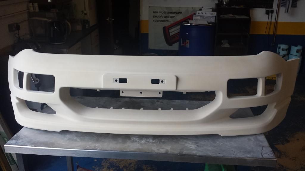

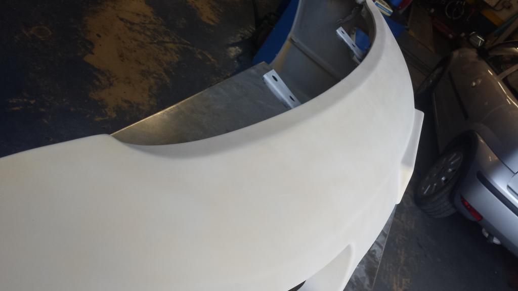

Hi guys got this back today, I bought it new about a yr or so ago,
I decided I'd paint it so I put some adhesion promoter on it and then high build primer and painted it myself big mistake lol, then my bro in law painted it,
It spider web cracked I put it on to thick and used no plasticiser,
So bro in law sorted getting it back off instead of da sander he Got it bead blasted with glass and water,
It came back with no paint at all but had a little texture to it so I took it to work today and da sanded with 180/240/320/400/600 lol and its came up better then new...took bloody all day what a mission,
Now his gonna paint it again properly without me messing it up.
Heres a few pics
So if u need your bumpers stripped back I recommend bead/soda blasting works great...

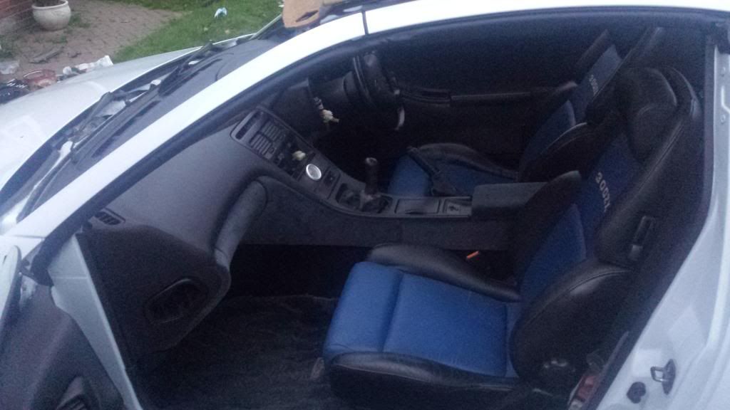

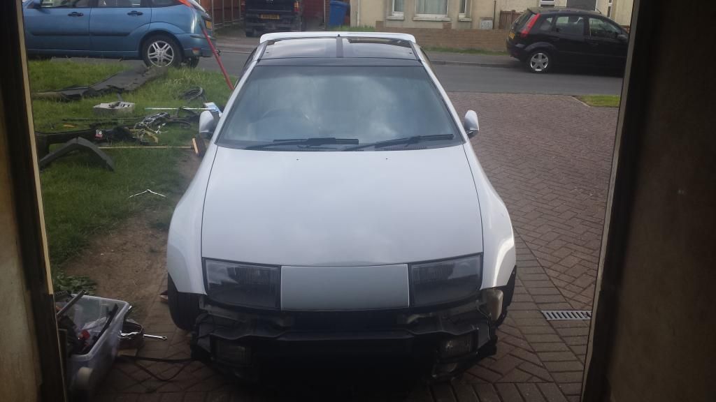

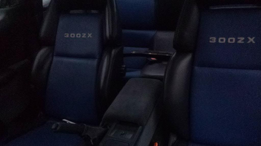

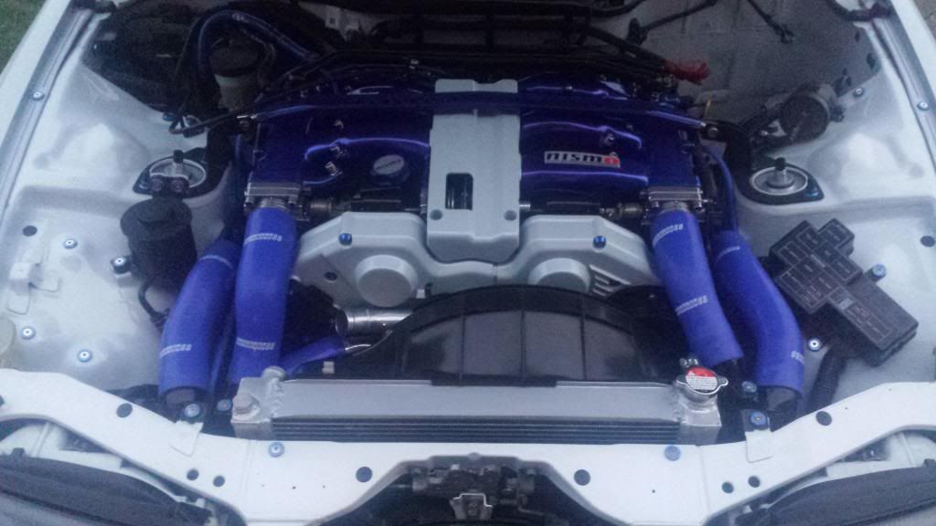

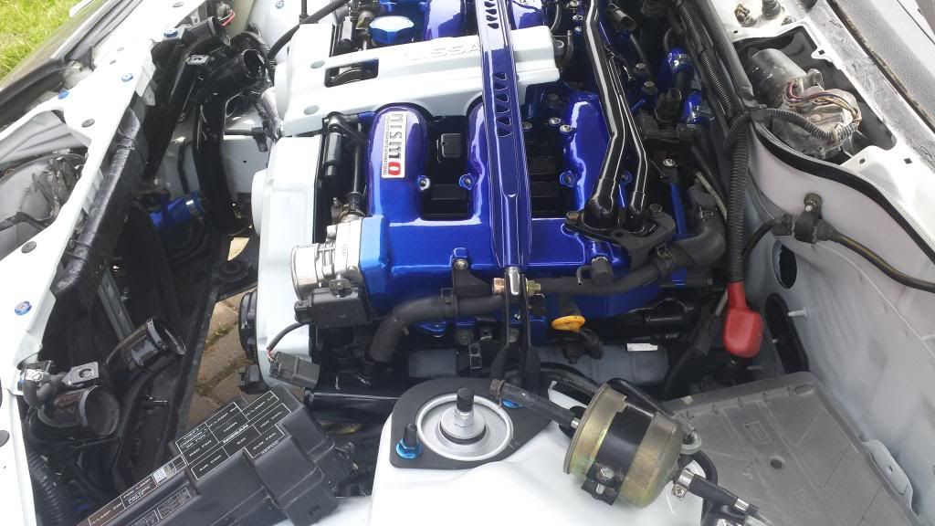

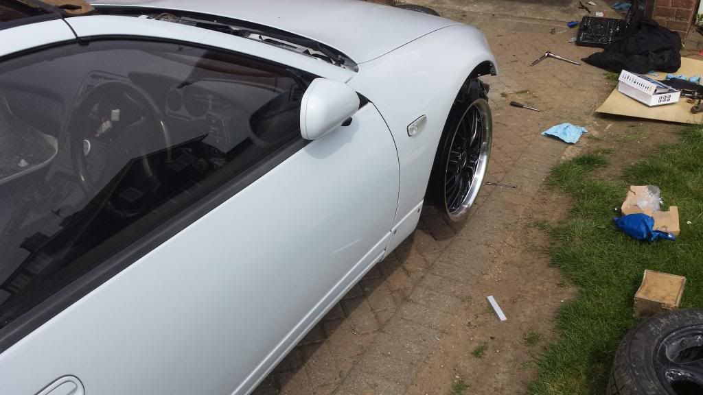

At the weekend I also managed to fit side skirts properly and the interior is nearly all back togethe...

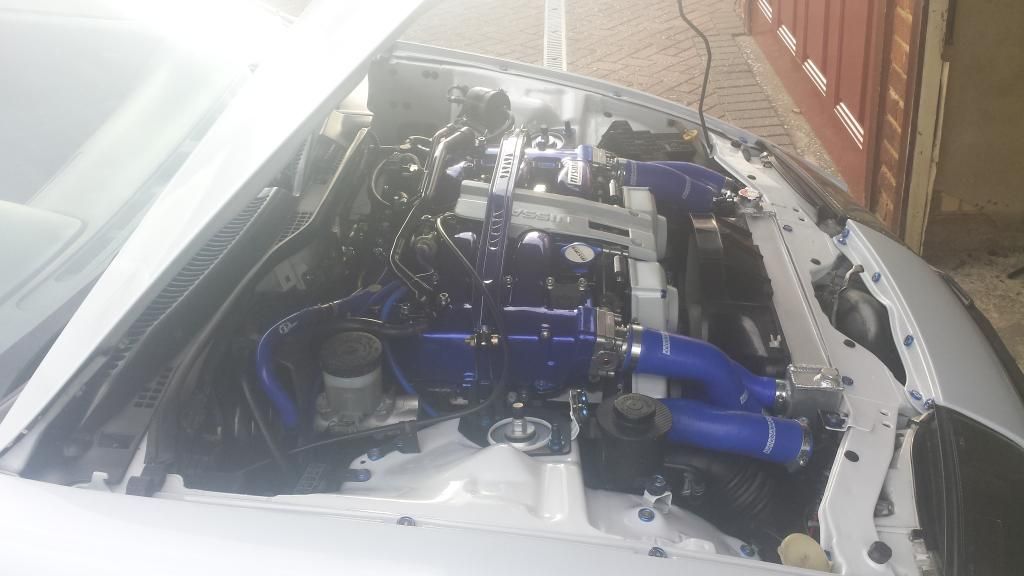

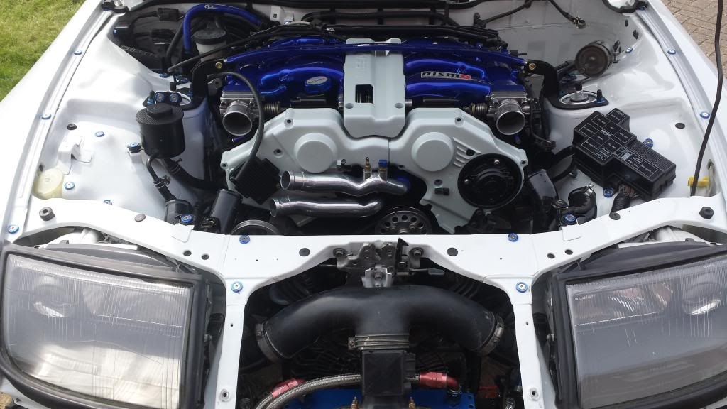

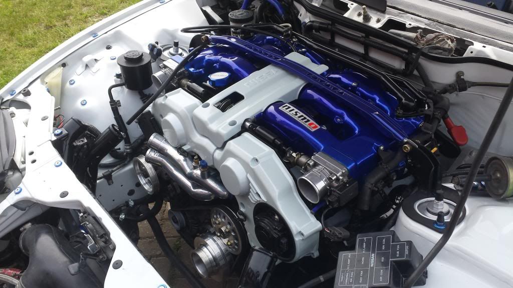

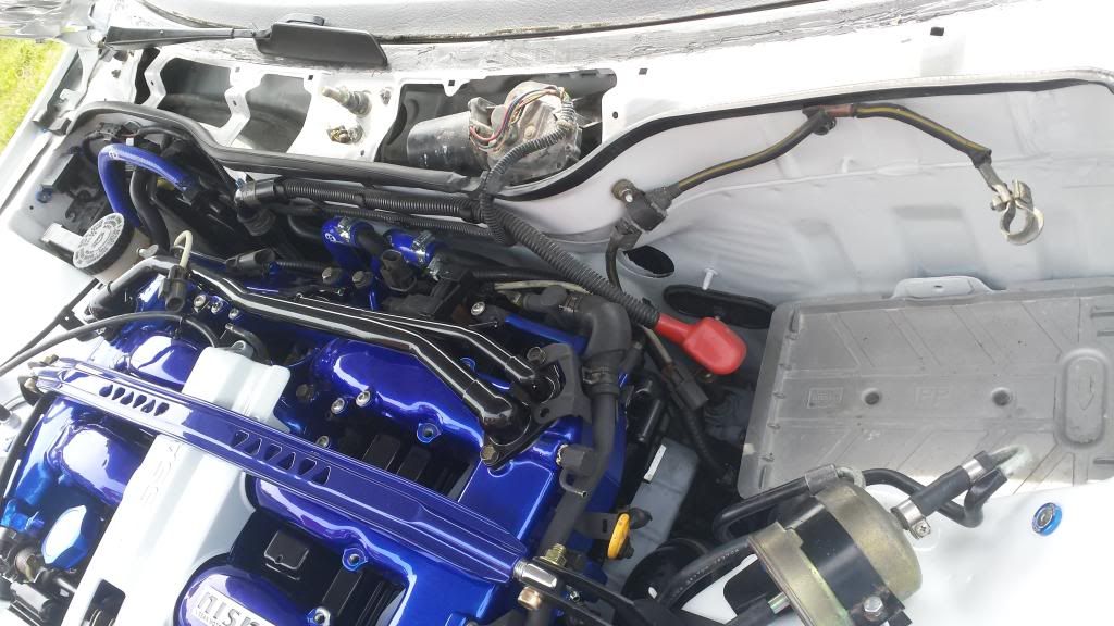

And the engine bay is near on finished too...
Anyone like my bonnet rod holder thing lol...

I haven't done much just waiting for my bro In law to repaint the bloody bumpers,

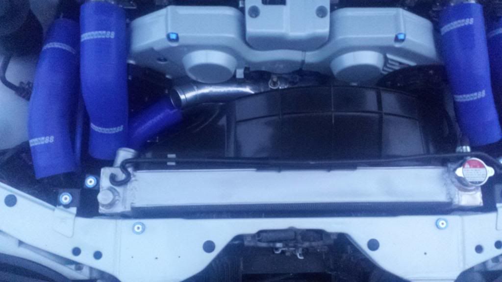

It actually drives now and have driven it so it works ok lol...
I'll put up a couple of pics now...
