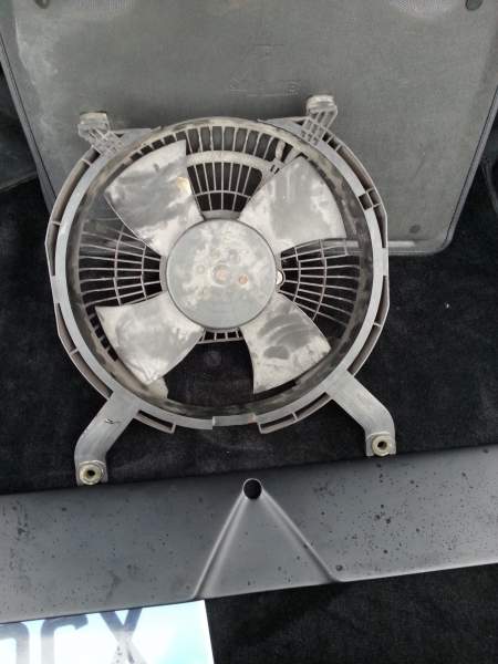

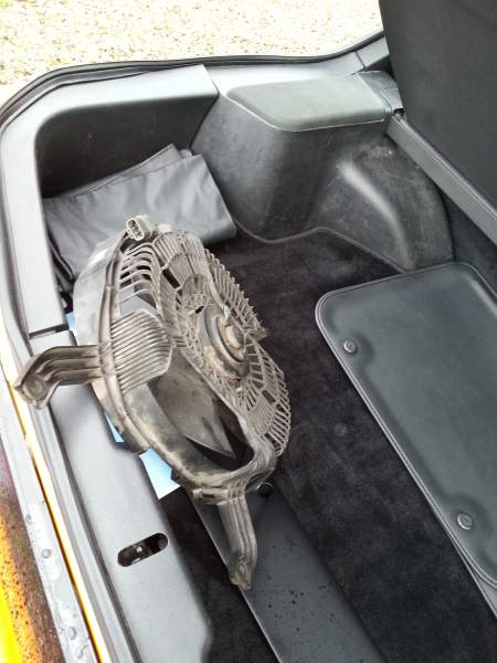

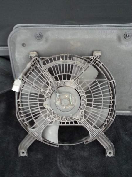

Just this weekend i meet Simon GT from cheshire, nice to meet you chap, He was down Norwich doing stuff. i bought a electric fan of him, cheers bud, the fan i bought was the electric fan that sits there infront of the aircon rad, so assuming it blows air and not pulls air was thinking of wiring this up to a switch on its own and also straping it to the cars rad. one to save me buying a maga expensive electric fan that dosnt do the job. dont want to get rid of the fiscous fan, just nice to have the option should i need it if bombing around in our summer months/ sorry days.
question one if im extreamly careful i should be able to mount this onto the cars rad with some rubber pads and skinny bolts,,
question two the plug has three pins in it does this mean its a two speed fan or is one speed. oh and yes i have tacken the aircon all out. im now onedering when that plug comes live.

Those things weight a ton, probably pull your rad apart if you attached it through the fins.
I wouldn't use that in place of the standard viscous fan. It's quite a lot less powerful than the standard fan. Surface area + speed.

As for the 3 wires i think the TT has dual speed and the n/a has single speed. both driven from relays from the ECCS so the service manual says...

I just went and measured it for you. You don't want to use the ECU to control it? It comes on and off at 105 and 104 Celsius.

The aux fan will kick in whether or not you have an AC system fitted at 105C. The ECU controls its operation under those conditions.
See my FSM post above for the complete picture of the low and high fan speed conditions.
