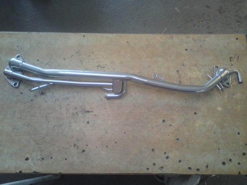

Took many items off my engine and have sent them to a metal polisher just a few miles from me and below are the results of his and my work :cool3:.

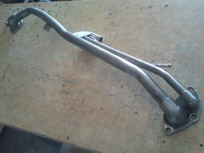

This is my aftermarket radiator bracket, it was or is stainless steel but now highly polished. The SLICKTOP plate was made by TwinTurboRich and I've had this powder coated and bolts on with some stainless steel allen capped nuts and bolts.
This is my Tokyo Auto cooling panel, original these come in silver or blue from z32-zone in Japan, mine was silver and the polisher told me it was anodized but now polished up as you can see. The logo was originally silver and riveted on, I drilled these out and had it powder coated, again bolted on using the same attractive stainless bolts.

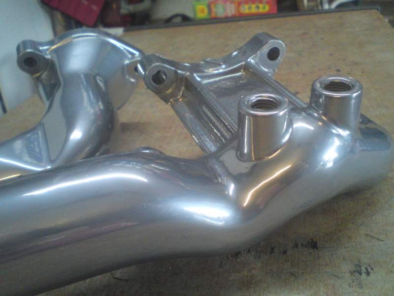

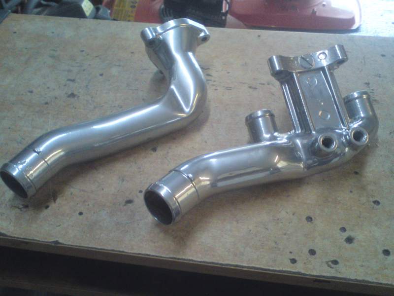

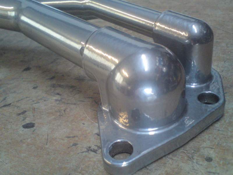

Then the usual polished up water pipes, these will be used with red silicone hoses and mikalor t-clamps

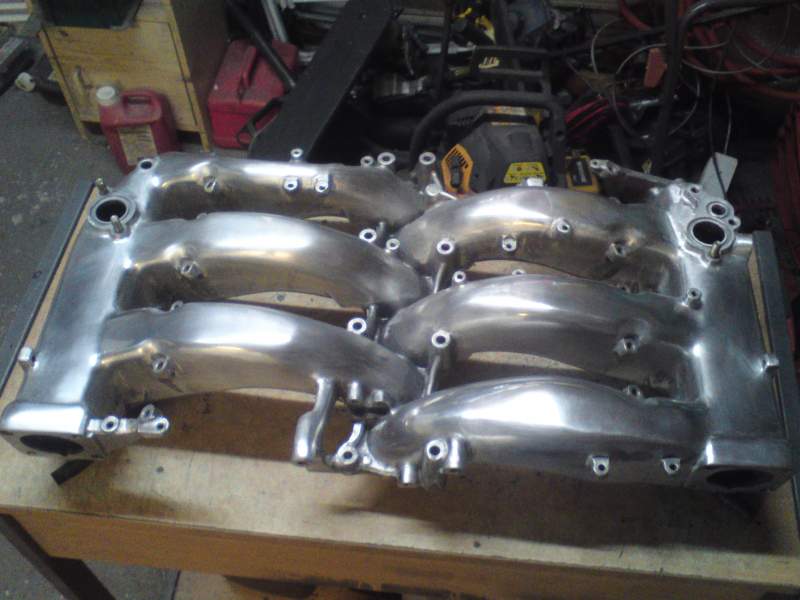

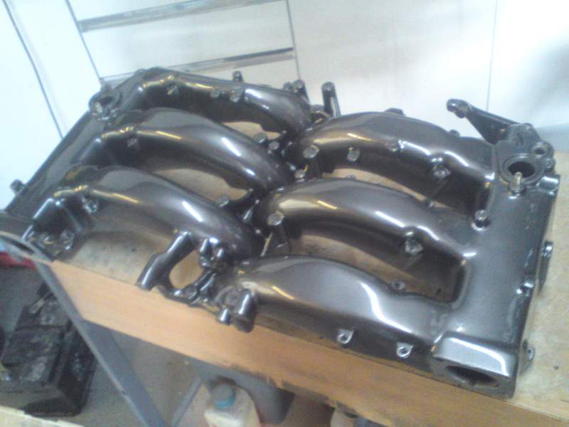

Having a plenum still in the car I kept refering to it and seeing which areas were visible and needed the most attention and so after a little more dremel work, I took to the fingers, starting off at grit 36, then 80, 120, 240, 320, 400, 600, 1000, 1500, 2000 and finally 2500, after about 4 hours I have it very very smooth and I expect more than good enough for a superb powder coated finish.
I only polished up with the denim mop and a little wet G3 in a small area just to prove to myself that I can do it, here's a pic.
Nice work Andy ill come over and check your work this weekend and have a brew of course, if your in that is ??
And if id have taken that down as far as 2500 grit then it would be going for chrome not powder coat.
No plans on going out, in fact I have my balance bar to remove and prep and also to polish the throttle bodies, linkages, etc.
You are probably right on the 2500, I have rubbed the plenum again here and there today with 400 grit and just left it at that this time, if my powder coater guy says it needs to be better as it'll show, I shall return back to the sink.

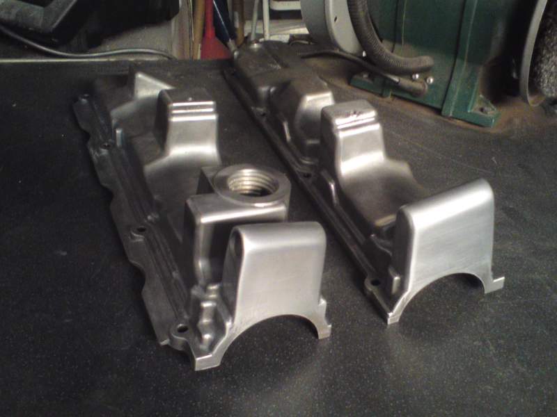

My rockers are practically ready as they are and these will be a chrome look powder coat, just gave the front bits (don't know what they're called !!) some special attention as these are very visible once fit, just rounds them off a bit also :thumbup1:.

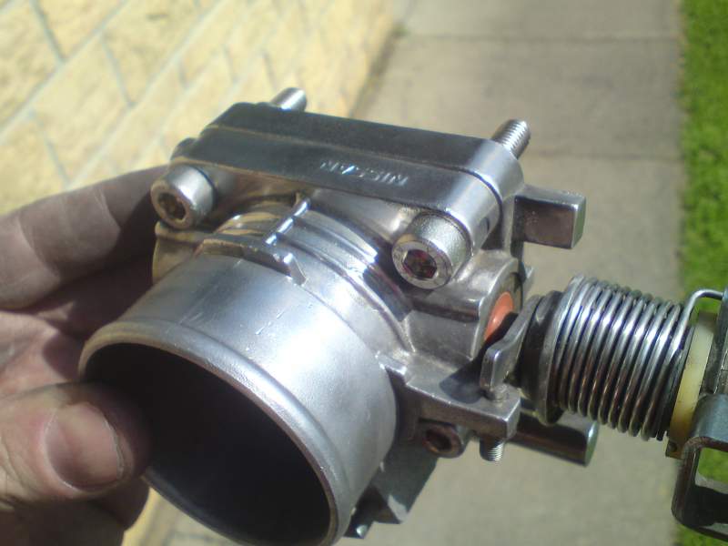

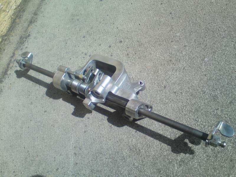

Ready for dropping items off at the powder coaters now, balance bars are already smooth so this as just been wire wheeled, this will done in chrome.
I found I also got good results with the wire wheel on the throttle bodies/linkages, then I did put a touch of polish on and ran the polishing denim wheel on them, paying special attention to the visible parts which isn't much btw, so I have these just really clean :thumbup1:.
I have bought some new bolts and offered them in for this pic.

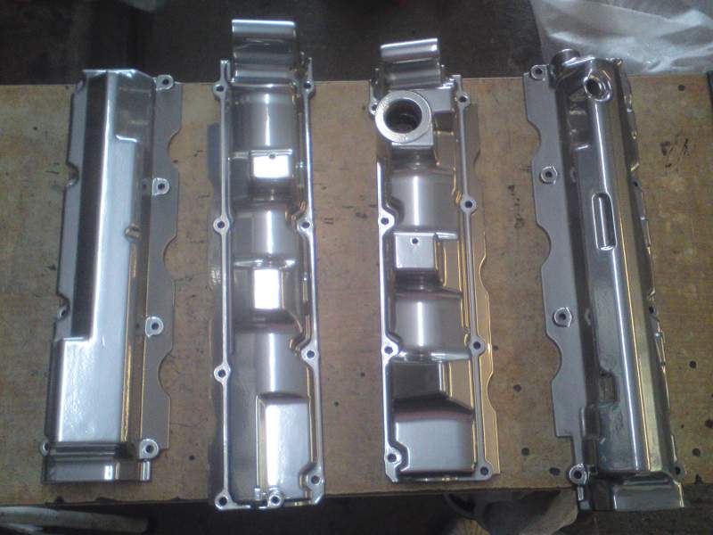

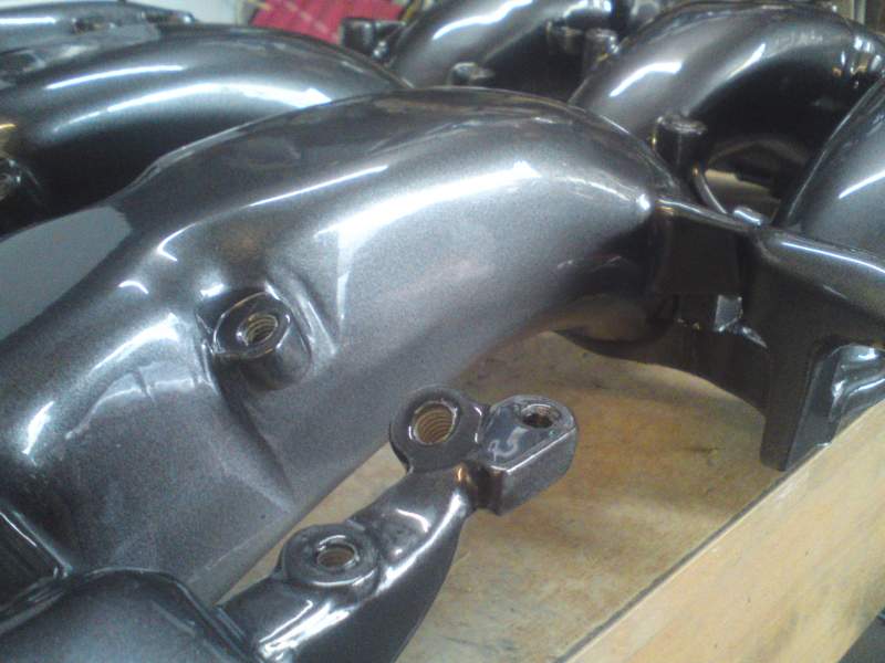

I got news from my powder coating place late on Friday that my goods were ready, I have had the long weekend to wait until today. I picked them up and just basically put them in the car, unwrapped them on arriving home and well.....I am truly delighted, the pics don't do these justice:thumbup1:.
First the water pipes
Balance bar, same as water pipes, chrome silver is the powder coat colour. I have some stainless dome nuts to use when securing this down :thumbup1:.
chrome powder coat then

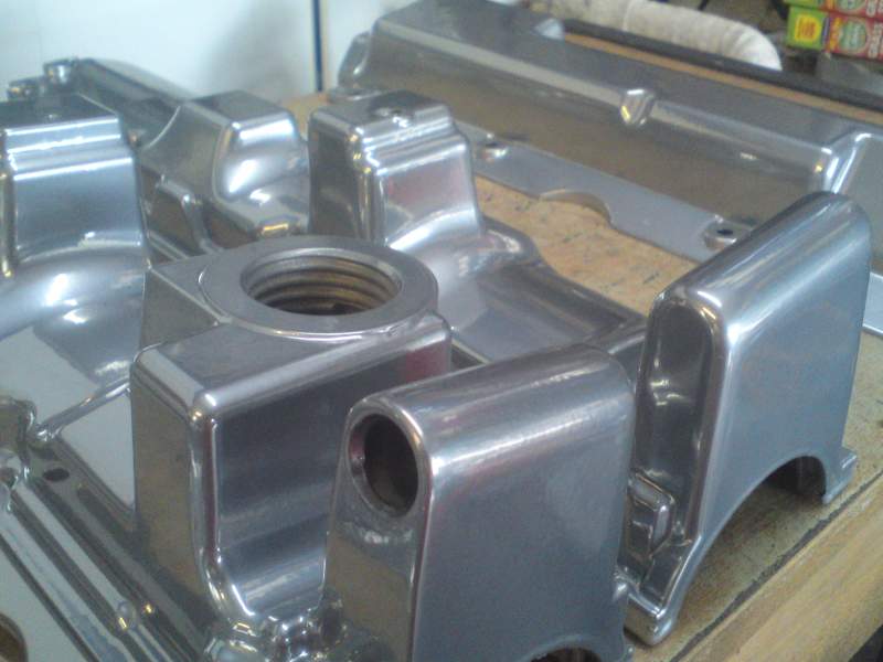

Moving on to the rocker covers
Now you will have to picture in your mind the contrast I am going to have with the powder coated chrome, the polished and the chrome plated all against this beautiful gunmetal grey (metallic black) plenum. It seems all my prep work was well worth it !!
I have everything now to take all this to Denty's to fit next month.......cannot wait :wink:.
