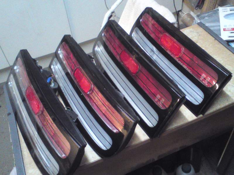

I was sent some 99 tail copies to repair and boy they were rough on arrival so I experimented with some new ideas/products.
Turned out rather well methinks, there was a lot of work as I had to practically start from scratch, one of the backs was creamy and the other white inside so these had both needed to be sprayed gloss white and baked :wink:.
Here they are alongside some genuine units...
I must admit I'm struggling looking at them again in that above pic, the one on the very right is genuine for sure :drool:.

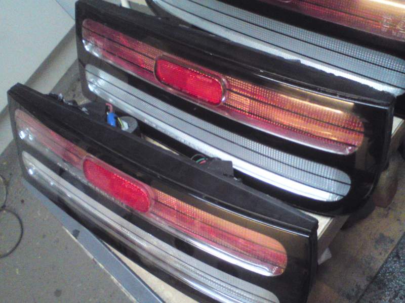

This next pic as one of each, matching pair you could say !! For the first time I chrome wrapped the inserts to mimic.

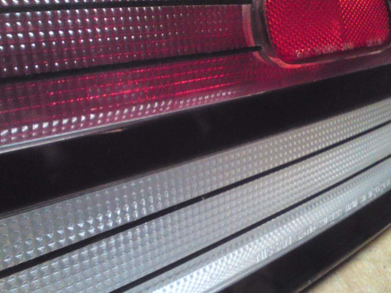

And finally a close up piccy, hope you like, thought I'd share :thumbup1:.
Very good! I can tell the difference though, quite easily, but they are infinitely better than just replacing the lower sections.

Well just behind the outer lined lenses there is an insert and this on the genuine ones is completely in chrome, so I had a go at it myself on the set you see, couple this with a clear diffuser I used that matches the red one I would say I make the best copies out there :tt2:.

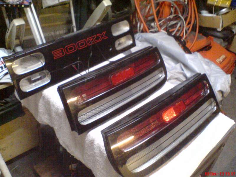

The 300ZX is not illuminated in this pic, a strong red when off just like facelift spec :thumbup1:.
FYI, customer requests that the tails are not squeezed back together so in this pic just offered together, he is fitting some leds.
