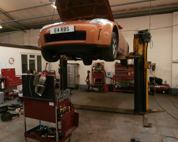

Sorry a 350z not a z32 but sometimes when those little jobs go off track it can be so frustrating! so said 350z was in for clutch change today as it was slipping under load at motorway speeds in top gear.

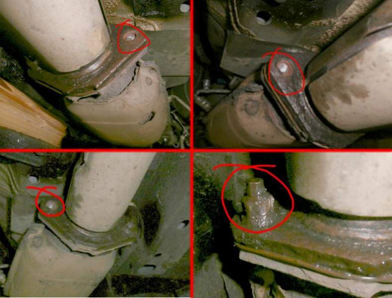

So within 5 minutes of it been in the air I could see the exhaust nuts were looking nasty, so plenty of freeing agent and get on with some of the other nuts and bolts.
So even with heat and the best fitting sockets they rounded off, not one, not two but all four!!! eventually after getting some of my Mac tools socket hammered on they moved but then snapped all of then doh!!

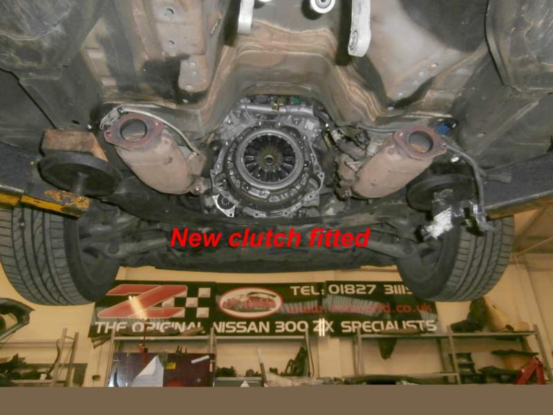

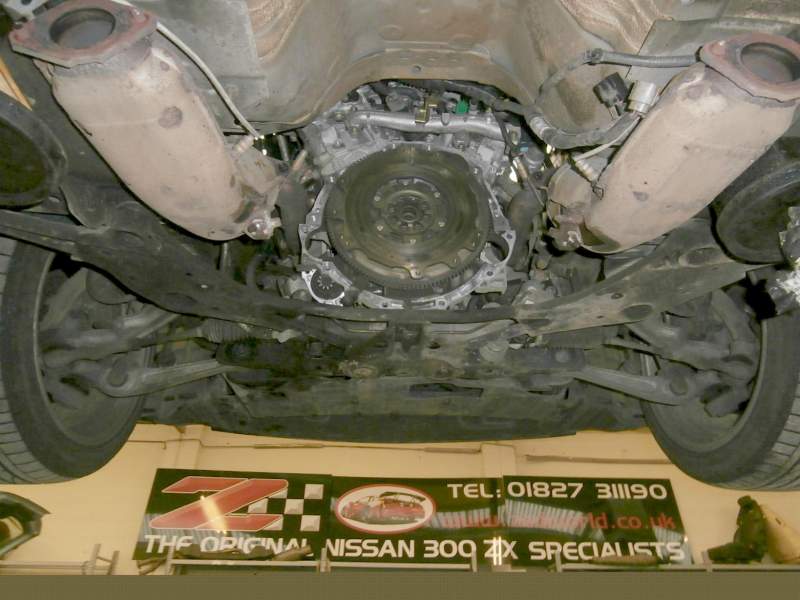

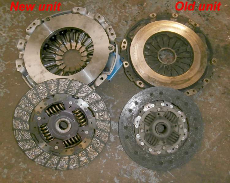

With the exhaust off the box was soon out and the clutch removed, there was not a lot left of the plate most of the lining been dust fibre in the bell housing.
An interesting point is the clutch size, the spec was a GT but the replacement GT clutch was larger and the surface area on the cover, have seen this a few times now and wondering if the UK spec were fitted with smaller clutches for some reason?? oh well all together now and collected this afternoon by a now happy customer who will be most likely writing a stern letter after she had paid for an AA pre-purchase check done and they said all was ok just 3 weeks ago, clearly it was not!

Jimmer might know about difference in 350z clutches as he's done a few.
I hope you swore at those bolts Jeff! Looks like they needed some 4-letter words hurled at them!

Yes there was a few choice words, to be honest I was surprised as I have done 10+ clutches and gearbox changes on 350`s and this one was the first one I have had to deal with such corroded bolts.
