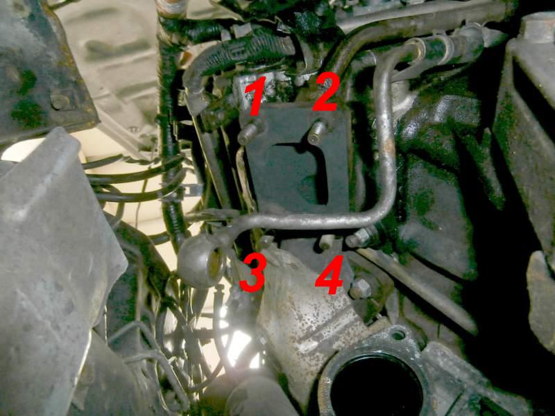

Take a look at one of my old posts below, there are some pictures of which show the turbo fixings and removed, I will add another pic in a few minutes once I have added some more info to it, back in a min...
Jeff TT
http://www.300zx.co.uk/forums/showthread.php?170625-whoops-turbo-mistake&highlight=turbo
Ok back here we go, I have marked the 4 x turbo nuts 1 to 4
With the elbow removed both 1 and 2 are accessible to bend back the locking tabs and get a 13mm short spanner in there, the nuts are not that tight normally and also once loosened off slightly will spin on fingers.
3 and 4 nuts needs the water pipe banjo bolt removing to access them, I also remove the actuator as its so much easier, the tabs again need bending back and there is no particular way other than trying whatever screwdrivers you have to do that. No 3 nut actually will have good access and can be undone easily with a medium drive 13 mm socket, the last nut 4 is a little harder, I use smaller drive 13 mm socket on a wobble extension and whilst holding the water pipe to one side, one little tip about the locking tabs is it is easier to not refit them, you can use self locking nuts ( not nylock) or thread lock, either will work.
Jeff TT
Cheers Jeff, studying the pics.... I will have to remove exhaust elbow tomorrow and completely remove the decat pipe... hanging down at the moment... I spent ages trying to get to that illusive bolt on the manifold.... gave up after cursing and kicking things....lol
Jeff TT
[ATTACH=CONFIG]73061[/ATTACH]
Jeff TT
Thank you soooooooo much for this Jeff, you do not know how much I appreciate that...... I owe you a beer.....
