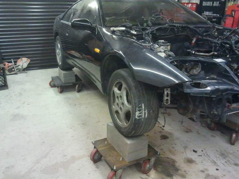

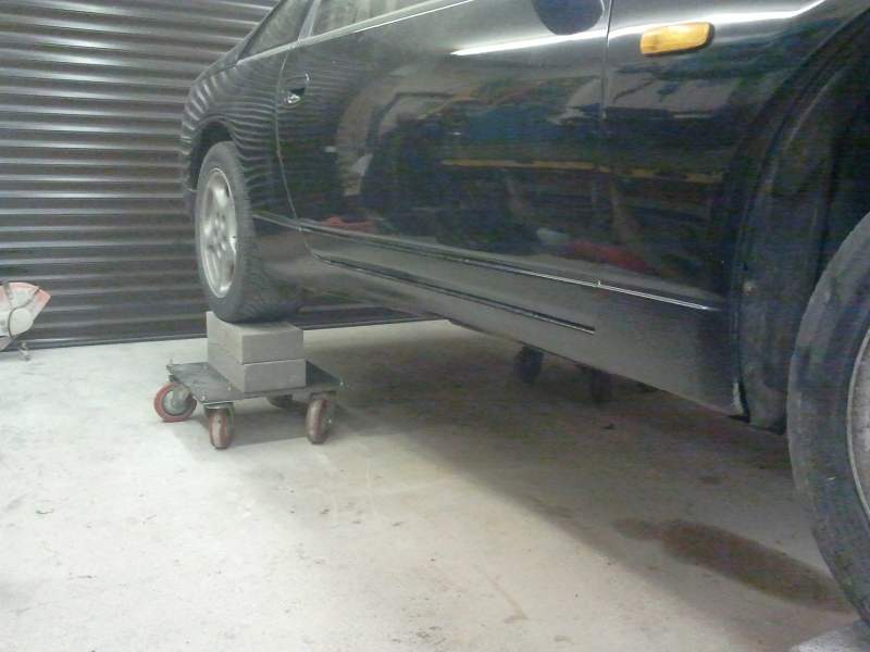

Im going to attempt this very soon but I have a crane in the garage roof, so I can only go side to side and up and down. Will I get away with it or will it be too much of a ball ache?
taking the engine out only using vertical movement wasn't so easy.
iff you come to my house and pick these babys up i made then you have full mobility and extra height:wink: Leave the breeze blocks off if you wish as there is still plenty of height..

that doesn't look very safe ! :scared::scared:
LOL a lot safer than ting tong jacks and axel stands...i deflate air in front tires and put handbrake on too. :wink:
I like it tho........ ;)
Alz.
I'm liking it too, but can't imagine the Dragons Den getting a patent for it though. Does the job,engineering at its best!! Think I will copy the idea.
