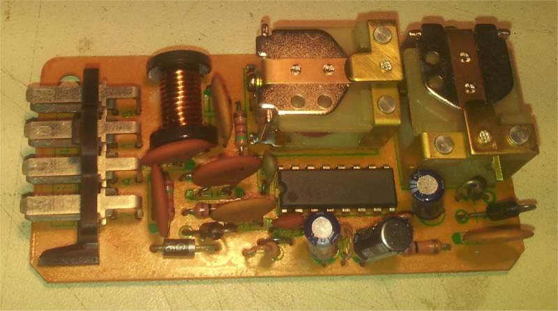

Figuring it was a bad connection somewhere I took it apart
It's pretty easy, on the end with the connections the plastic cover clips off with a bit of effort with a small screwdriver (clips on the two shortest sides)
Inside it is a PCB with some components and a couple of relays

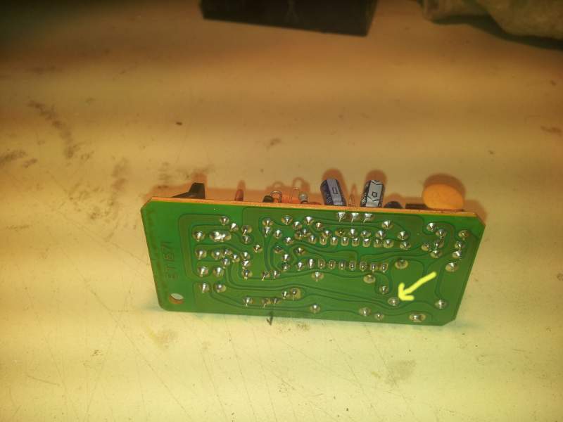

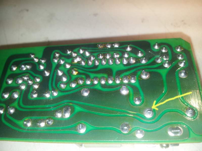

The problem was a broken solder joint on one of the relays (the relay nearest the end of the PCB controls window down and the other one window up)
Actually it makes sense that dry/fractured solder joints would be around the heaviest components - ie. the relays
Anyway here are a few pics of my control unit, this is the bad joint I found. If you look closely you will see a circular fracture all around the relay leg where it meets the solder pad.
I resoldered all the eight relay joints to be sure though. It now works absolutely sweet
